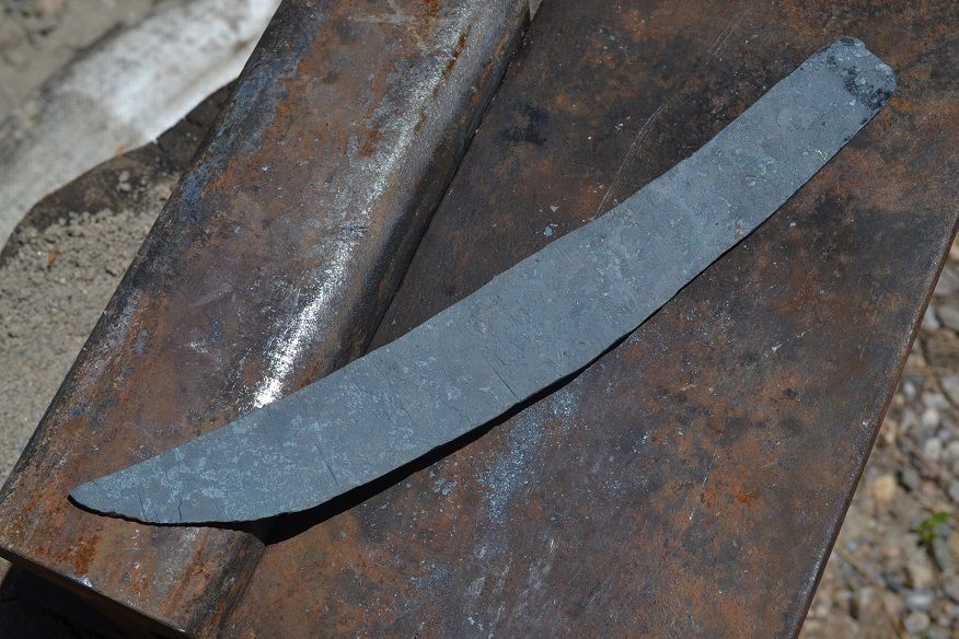

Here's the start, please feel free to comment, help out, etc! :) This is only my second forged knife and my first attempt at anything like this so I'd really appreciate the comments and help!
Forged! That is my current anvil setup, I have a crowned and flat face!

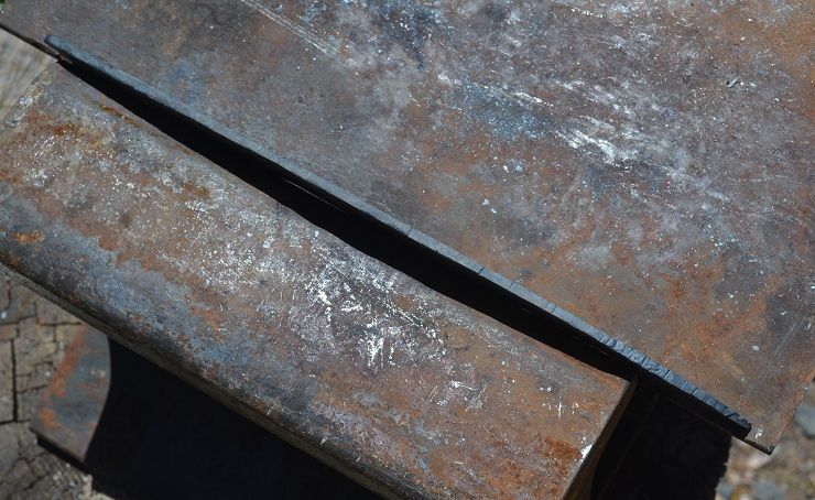

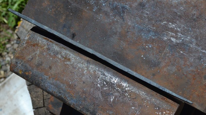

I'm really happy with the distal taper and tapered tang. This is my second forged knife. Spine up view
Edge up - It's pretty even besides some flare at the tip that I easily filed out.

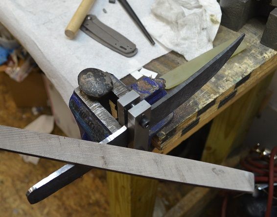

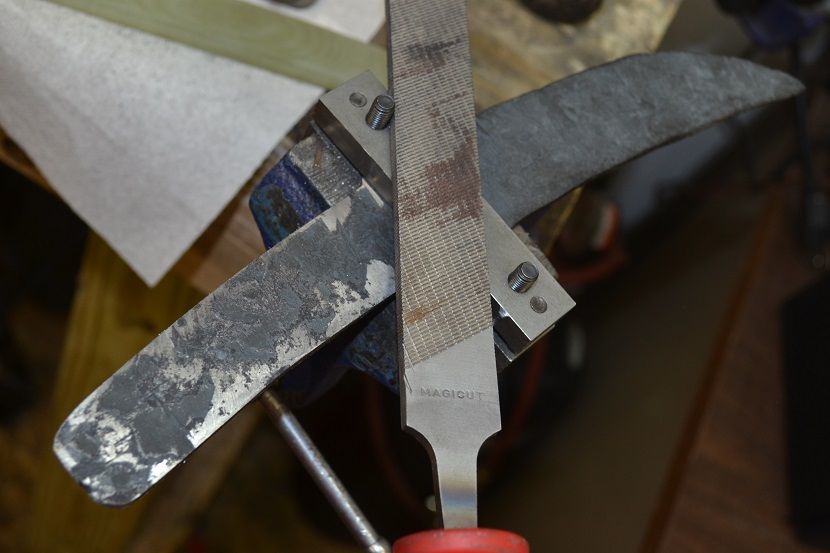

The file guide is on and I'm using a Nicholson Magicut to even up the spine. I'm also cutting in a shoulder for the Tsuba. I used round files to cut in the shoulders for less chance of stress risers.
Is it correct to position the Tsuba right behind the shoulders? If I need to file further for the Habaki that will happen. I have studied a lot of pictures and think this is correct but am not sure.

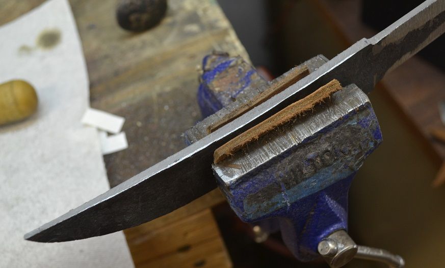

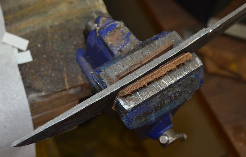

I'm starting on the tang. This may be ground through later if I pull the grind all the way through. My forge seems to be holding heat well as I annealed this after forging and it files nicely.

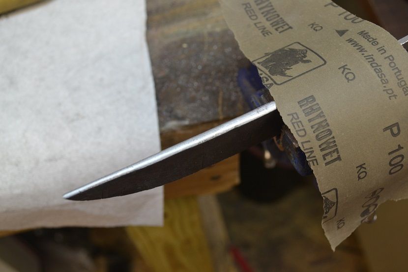

The spine has been draw filed to somewhat flat...
Better profile pic... it is hard to show the taper but there is a nice amount.
Rounding the spine. I' hoping to leave the Kuro Uchi (forged) finish on the flats and go with a rounded spine as opposed to a shoulder bevel grind.

Rounding the spine (mune) is fine. It is called maru-mune ( round spine).
The habaki seats against the machi (notches). On a tanto, a seppa between the habaki and tsuba aren't a requirement, but a small one is nice.
Consider copper for the fittings. It ages and patinates well, is easy to shape, file work, etc. A slice of copper pipe flattened can be shaped into a habaki easily. Pipe slices can be ovaled into fuchi and kashira, too. It brazes well with silver solder. Just do lots of anneal cycles as needed. A series of good long soak in livers of sulfur, some burnishing with 0000 steel wool and/or a light buff make it look like old shibuichi.
Resist the temptation to put a large tsuba on. Tanto tsuba are just large enough to keep the hand from sliding forward. They are not sword guards. About 1/4" larger than the wrapped tsuka is plenty. In the same way, try not to make the handle look like a katana/wakizashi tsuka. A tanto is a knife, and the handle doesn't need every whistle and bell. The tsuka should not be large or long. Often simple is elegant on a tanto. Remember when shaping the tsuka core that it will be wrapped and thicker. The finished handle should not be bulky. A smooth and proper size tsuka has the core smaller than the fuchi and kashira to allow for the tsuka-maki thickness.
While discussing tanto sugata ( blade shape), there is a predominate thought in the US that the tips are rather bluntly curved up....or even angularly shaped. That is not the case in most historic tanto. The tip ( kissaki) is tapered to a point from the edge. There is a demarcation where the edge (ha) ends and the kissaki starts, but it is all part of a fairly even taper and curve.
The short and abruptly curved kissaki are called ko-kissaki ( short tip). The most common are chu-kissaki ( medium) and O-kissaki ( long). The O-kissaki are the most graceful and "weapon" looking.

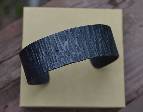

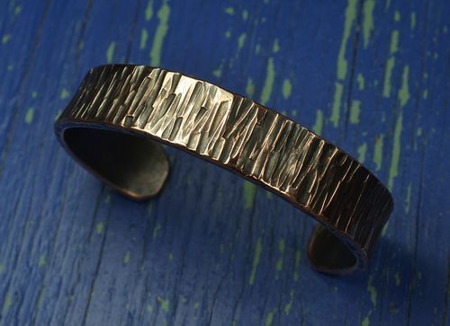

Here is some of my copper work... heavy duty cuff bracelets. Forest pattern! I'm also doing some hard soldering with bezels and bangles so far.

I'm going to do some more filing to have a nice seat for the Habaki then lay in the grind. I have decided to go all out and try the more traditional grind that extends all the way through the tang.
I'll do my final sharpening by polishing to the edge... does the edge remain thin under the Habaki so there is little transition to the sharpened edge?
Thanks again!
Yes, the edge is sharpened all the way back to the machi, and down the nakago. You can slack off the actual edge as you near the machi and just have a blunt edge going back onto the nakago. Just make sure the kasane ( thickness) of the nakago isn't any thicker along the edge than the blade at the machi.
