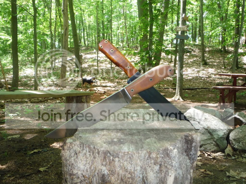

I recently had the opportunity to test a couple of blades from one of our own makers, Walter Davis. I was much honored to be asked by him to help test out the heat treat and handle attachment. He had me at hello but when I found out these are forged pieces, I was all over it. He gave me the choice of a flat-ground Bowie or a convex Hudson Bay influenced design. I would test one and he would “beat the tar out of” the other.
I am all too familiar with Walt’s convex. This man knows his geometry and has come up with I believe an ideal angle for both detailed cuts and power cuts while maintaining an edge that seems to never quit. I’ve had one of his knives for about a year now that is one of my main users. All I have had to do is some stropping on a leather belt after use and the edge shaves & slices free hanging paper non-stop.
It was a difficult choice because I was curious about Walter’s flat grind but the idea of a convex Hudson Bay was too much for me to resist and I told him so. A few days later I got a message from him that BOTH were in the post for me, along with that mesquite bushcraft that I couldn’t resist buying from him (more on that one later).
I had no other clues on what to expect other than they are “not quite perfect”. What I brought out of that USPS box had nothing to do with “not quite perfect”.

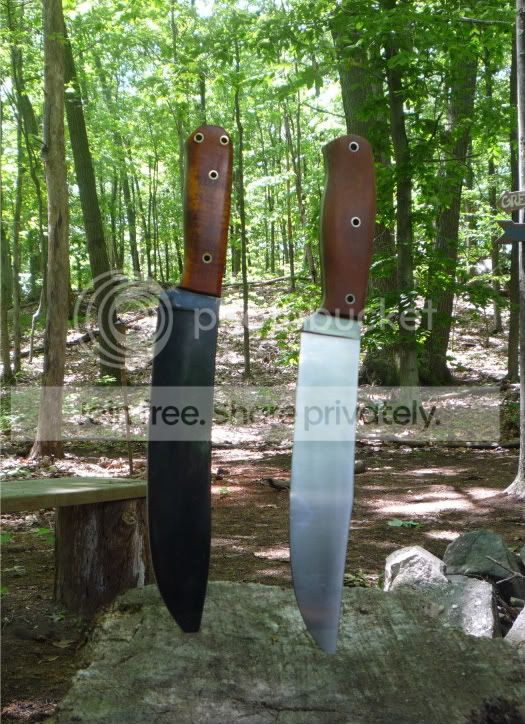

Both choppers are full tang and forged form 5160. The full flat ground Bowie is 13 9/16" long and has an 8 3/4" satin finished blade with an 8 1/4" cutting edge, 7/32" thick at the spine with a distal taper. The nicely contoured handle and natural canvas micarta scales with hollow aluminum pins are 4 7/8" long, 1" thick and 1.5" wide at their widest. The balance point is right at the front edge of the handle.
The Hudson Bay comes in at 14 1/2" long and has a 9 1/2" gun blued blade with a 9" cutting edge, 7/32" thick at the slightly rounded spine that retains full thickness up to about 1 3/4" from the tip. This handle this...fruit of some heavenly serendipitous pollenization of inspiration in Walter's head :D, made from curly maple and brass hollow pins is also contoured and reminiscent of his bushcraft design but with a slightly forward canted coffin end. It is also an inch thick and 1 3/8" wide at it's widest.

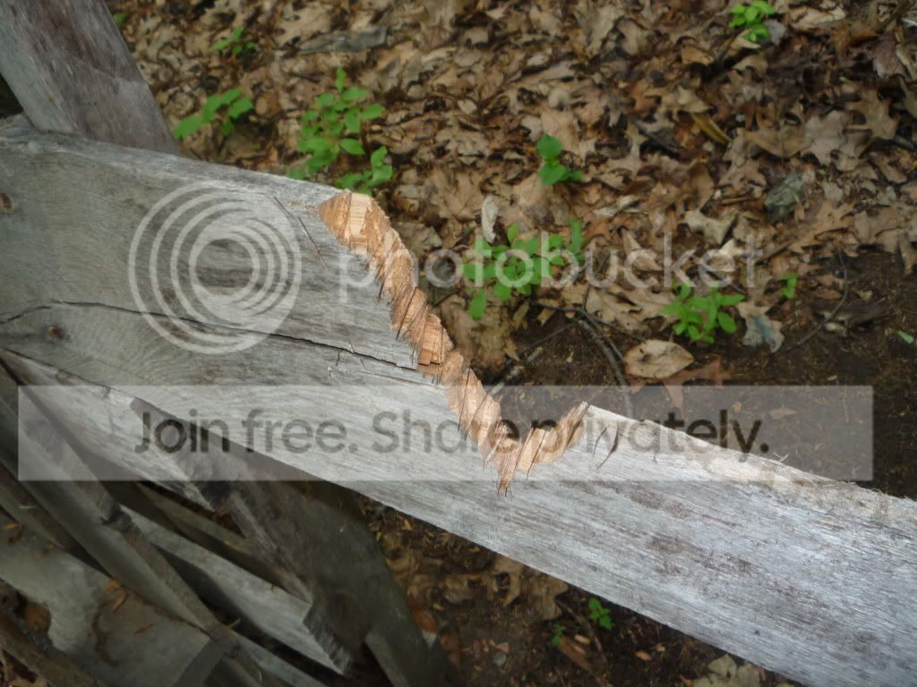

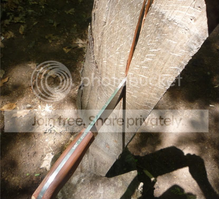

Well, I took them out back to our campsite and proceded to beat the tar out of them. I had a couple of old dried wooden pallets waiting to be brocken down. I figured that I'd use them for a nice fire for the kids. Now I have to admit that I had to be very careful not to be biased even though this was not so much a comparison to each other, but I did have a favorite at the outset.

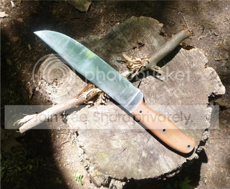

I first picked up the Bowie with its falt grind and distal taper. It feels very quick and agile despite its size. First I did a couple of snap cuts with just the wrist.

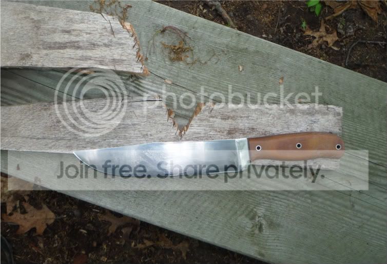

I then commenced chopping away. It took deep bites into the old pallet.
The distal taper did feel a liitle awkward at first but I quickly found my groove.
Halfway there...
...and through, sort of. The wood split before I could get though. I inspected the edge and found no evidence of damage. I cut some AG Russell catalog stock with no hang up. I then whittled a few fuzzies with ease.

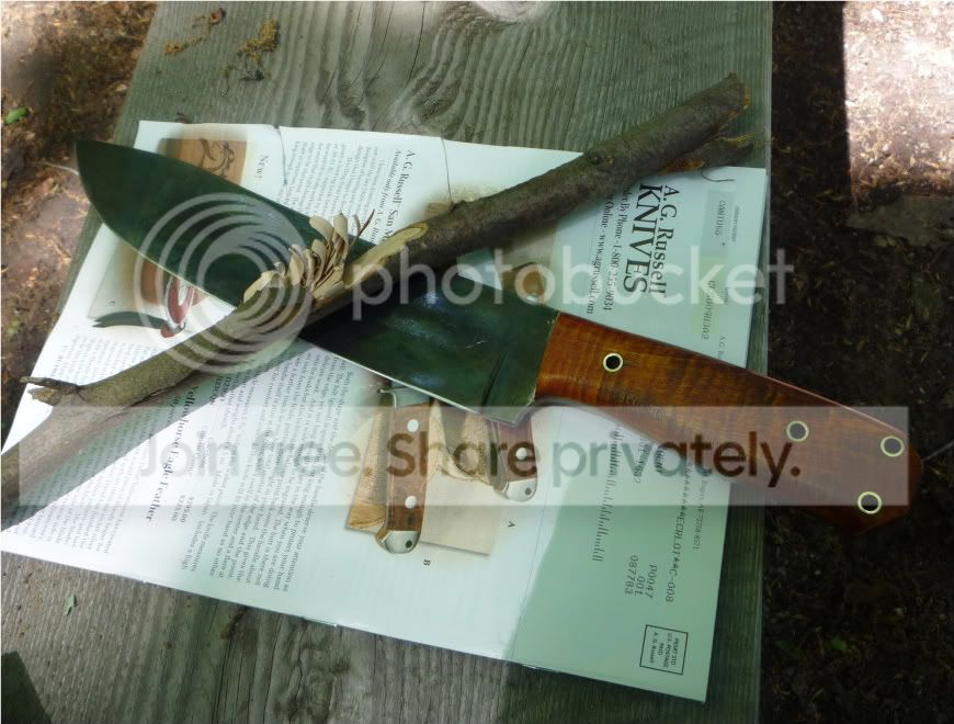

Then it was the Hudson Bay's turn. This knife has a completely different feel to it. The full thickness really adds heft and puts the balance point about 1 1/2" forward of the handle. The snap cut wasn't as quick but the weight brought the knife in even deeper.
Chopping was as intuitive and can be. The blade ate through the wood and I have to say that even though this blade is heavier, I feel I used less of my own energy to get through a similar piece of lumber.
Edge inspection showed similar results with no damage, a cleaner cut through the catalog stock and on the fuzzies I think the flat ground one fared better but I think that it is simply due to the inclusive angle geometry of the flat grind vs. the convex.
I did do some batoning with both and they zipped through with ease. This was done to test both blades' and handles' impact durablilty. post inspection showed no damage, loosening or any evidence of handle attchment failure
