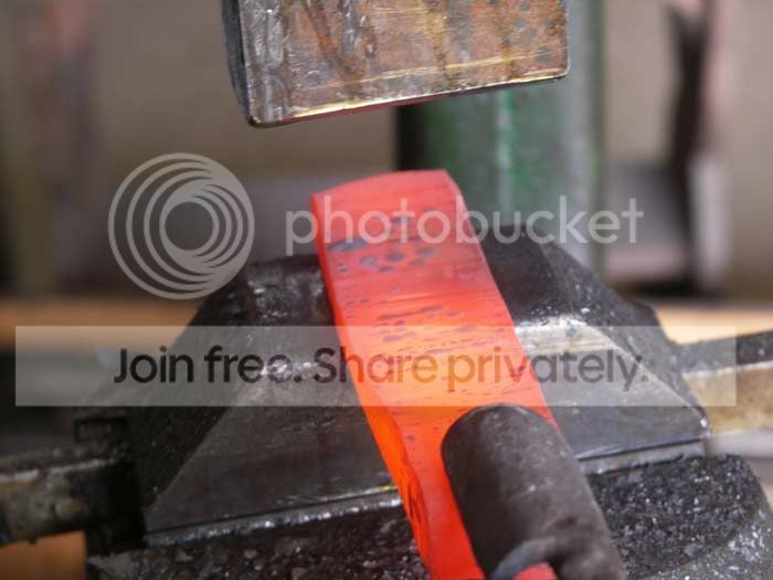

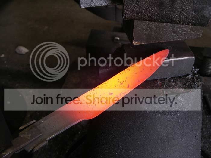

This thread is for a few purposes.
2" W2 too big for small hammers?
25 lb hammer too small for big work?
How many knives from a 2"x11" W2 bar?
I get a lot of request for info on how to forge large round stock, what size power hammer, etc. And some folks want this W2 in long bars:eek:
Pictures help :)

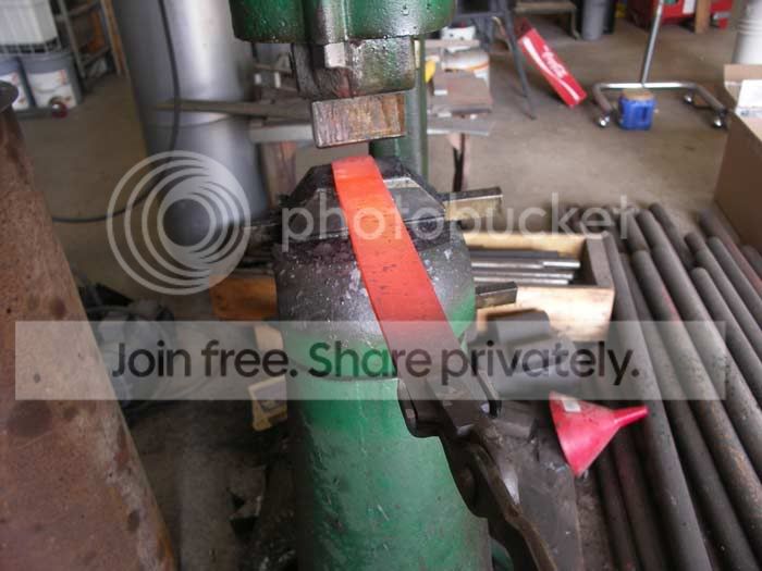

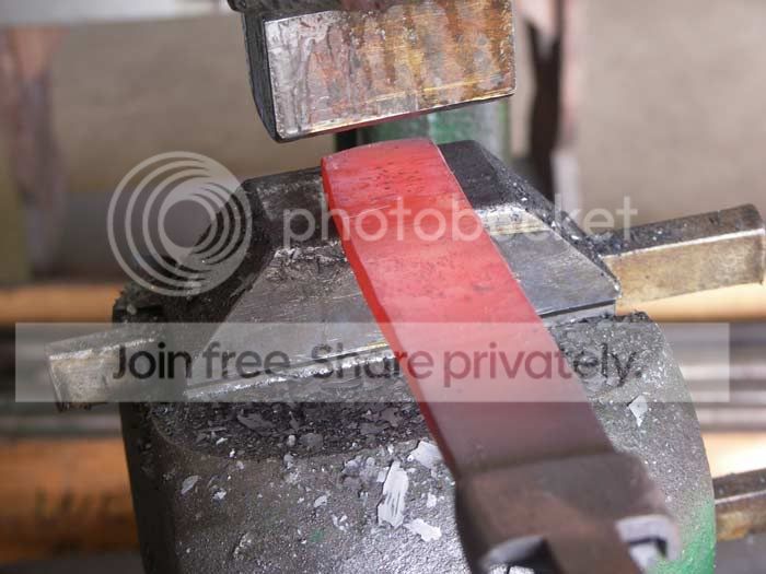

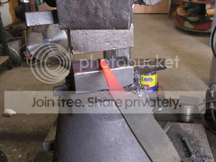

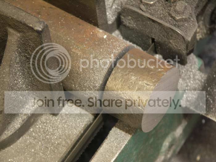

1-3/8" piece of 2" W2;
1909 25 Little Giant;
First heat;
Second heat;
Third;
Forth;

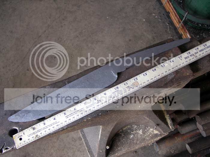

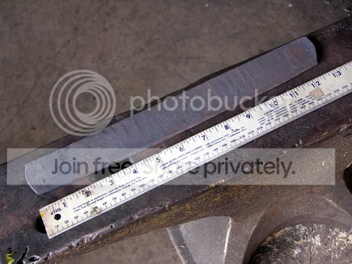

1/4"x1.25"x12"+ Bar
Could have done this in 2 heats with the 100 but the 25 works just fine :)
More to follow;
