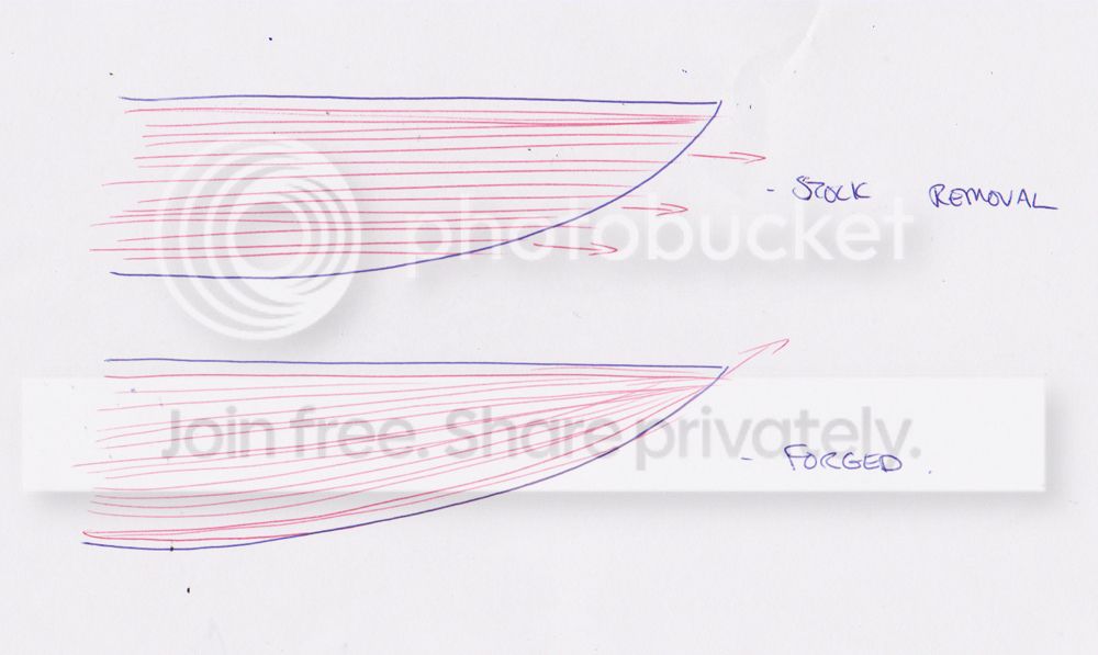

Question about forging vs. stock removal,. and how it relates to damascus. So (bare with me I'm learning) from what I can gather the purpose or principal behind forging a blade and how it's 'better' than stock removal is because the grain doesn't run out into the cutting edge ? I don't know if I'm wording that right.. but forging a blade will taper the grain with the knife's edge.. yea? What about Damascus steel, where the grain is flip flopped all over the place, and the layers themselves also run into the cutting edge? Is this a factor when making a knife from damascus without having an added core? I feel like in my head it could possibly be worst than stock removal.. but it's obviously not, so anyone care to give my head a shake and elaborate on what's going on there?
Or if I'm not making sense whatsoever.. lemme know! haha Thanks! :thumbup:

Ok,, I must have just read into a thread on the subject a little too deeply then. I just remember seeing a diagram someone had drawn up of a forged blades grain vs a stock removal. Seems like an awful lot of work if it makes no difference. Anyway,. Thanks for replies!

I didnt really mean grain size or grinding the bevels, sorry if I didnt word that properly. The diagram I had seen was only related to the actual direction of the grain.
This is what the diagram looked like that got me thinking, and really I was just wondering.. if it mattered.. how it would relate to damascus steel, but if it doesn't then that's great. Again, thanks for making things clear

That's not an issue of grain, it's just a question of mushing different layers around or not, as Tim said. It's perhaps 98% aesthetic... any difference in performance would be so small as to be extremely difficult to even measure.
Do a little experiment... take two colors of clay or play-doh and stack them up in thin layers. Cut one at a bias and squish the other one to the same shape... that will sort of illustrate what I'm saying here...

This is what I was referring to. By forging the blade, you can compress the layers in such a way as they will flow around things, and down to the edge. In the two drawings, it is clear that the forged blade will be more pleasing to the eye.

This is in fact true when one is using pre-industrial steel, such as wrought iron, bloomery steel, and to some extent, shear steel. These materials have a very pronounced grain and do benefit from being forged to shape. With modern steels, it makes no difference. With slaggy carborized wrought iron, it makes a huge difference....
