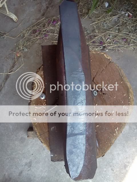

Frank, another thing is that 1/8" steel is pretty hard to forge when you're starting out. Especially if it's fairly wide, and it will want to fold over when you're hammering in the point, rather than draw out.

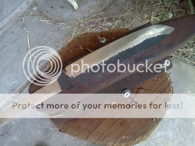

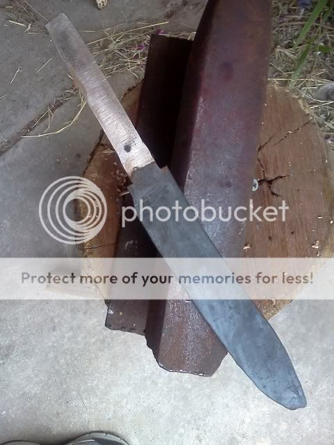

Thats exactly what was happening too. The steel would twist aI would have to straighten it out again. So after about 7 heats this is where I am at. I uess I need to get it hotter at the tip so it wont fold back as much? Thanks for all the feed back guys. I have searched for a local blacksmith and I havent found one. I have looked under the blacksmith group websites and havent found any anywhere close to me. Bladesmiths are even farther away, I think the only one I have heard of lives around San Antonio and that is a 4.5 hr drive for me. You guys are the best I got!
On the points of thin wide stock I usually favor some type of stock reduction,... hot cut, score (or cold chisel) and snap, saw, grind etc.
This might be proper or it might not but if I want to forge down the width of a thin piece of stock most of my heat is in the middle. The steel moves toward the heat. So I heat the entire end of the bar, pull it out and lay each edge in the anvil to suck out some of the heat and through it back in the fire for a few more seconds. What I end up with is a bar that is hotter in the center than the edges. This way I can avoid the I-Beam effect... lol.
If I do cut an angle for the tip, it is always a back-cut opposite to my intended tip geometry. Then I forge the tip up as I do the bevel. This works great for damascus because it forces the grain to follow the edge.

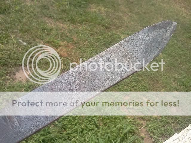

I forged some thin-ish 52100 down one time- eight blades, I just wanted to use it all up.
After acid etching, they looked stunning to me, with the way it almost looked layered, but I ended up with pin holes in the blades, and only 1 survived.
Was it just working the steel too hot/much that caused the pin holes?

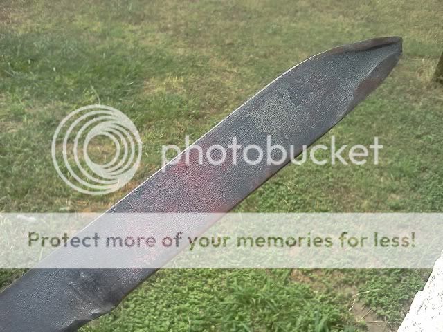

One advantage of reducing large round or bar stock over flat barstock is the fish lips affect can be avoided. Shape the tip while the stock is still thick enough in cross section and hot enough to be forged, then draw the blade out to its desired length.
Charles, I havent tried out the forge with the adjustment you suggested yet but I did get to pound it into submission. This knife will probably not get done, cause I just want to bang more out, not finish this one. Some one on here said a guy banged out 100 knives and by then he was pretty good.I have 99 more to go. I want to learn how to do this much better and more efficiently. Time will tell.
One part of hot forging that gets left out in many discussions is keeping the blade and anvil clean.
Brush the blade off with a wire brush when you take it out of the forge, and wipe the loosescale off the anvil every time you put the blade back in the forge. Hammering the scale into the steel is the cause of all those "pin holes" dings and spots on most forged blades. If kept clean and scale free, the finished blade can be smooth and pit free.

I have only done about 7 so far, but I get tip cracks all the time, I still haven't gotten that process down, just allow for some grinding.
