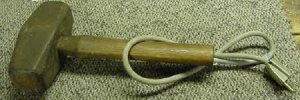

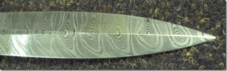

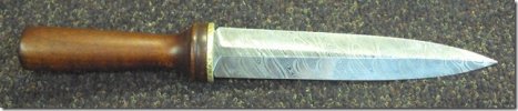

STWM, I'm pretty much burnt out on knives for while and do get more enjoyment from plain black smithing. Did a "Frankenbowie" for Alan here on the forum a while back. It turned out fairly well, but sure hope he still is happy with it. Think this one was 154 layers. The hooks are made from scraps of hot rolled or cold rolled round stock about 6-7 inches long. Made a tool to sit in the Hardy hole to facilitate making the radii instead of using the horn/bick on the anvil. Saves a lot of hammering. 2 pound ball peen hammer is great for this task. My personal hammer is a 3 lb. straight peen and I let no one use it. It fits me well and is a natural extension of my arm, so I "protect" it. Click on the pics.
Frank Bowie.JPG Next pic is a dagger I gave to Bawanna. !cid_D87DAFA4B72841648823AEB2498E4039@StevenBookout.jpg !cid_23A516143B5A40D0A8817C99C0AC8AA9@StevenBookout.jpg Hirsoulas' book will tell you how to do this and more patterns. Did get me a piece of modern blacksmithing equipment a while back because Bawanna said I needed to catch up with the times. Great hammer, but ain't figured out just what that cord hanging from it is for yet. Boss Hammer .jpg
I saw both the Frankenbowie for Alan and of course the dagger that was sent me. Claims it was just sitting in his junk drawer???? Pictures don't do either of them justice.
Both are absolutely breath taking. The dagger was deliberately never sharpened and I will never sharpen it either, I don't want to mess it up.
It hangs proudly in a place of honor on the knife rack and gets lots of comments from everyone that looks.

That hammer with the cord does look like something I might think up. My harbor is usually pretty dim for lack of brightness.
