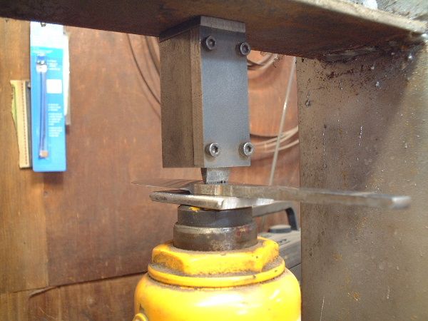

I ended up making a small press using a 6 ton bottle jack. This based off one Kevin Cashin posted here.

I used a hammer and made a holder for an arbor press. This way it is held perfectly straight and get a more consistent mark.
I agree 100% with DH III, I tried a powered press for this and it was not controllable enough. I even cracked a knife using it. Bottle jack has much more control.

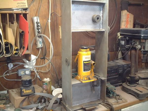

However, if I was using a stamp on every knife, there's no doubt I'd be building a bottle jack press. That one of Karl's is perfect for the task, IMHO. :thumbup: :)
That picture must be four or fives years old. A long time ago I switched to one of those stubby 50 ton jacks. What's nice is that I can just squeeeeeeeeeeeeeeze it a little bit - check it out - set the stamp right back in place and give it a little more if necessary.
That's similar to mine, Karl. Yours is beefier though and a 20 ton jack is better.
