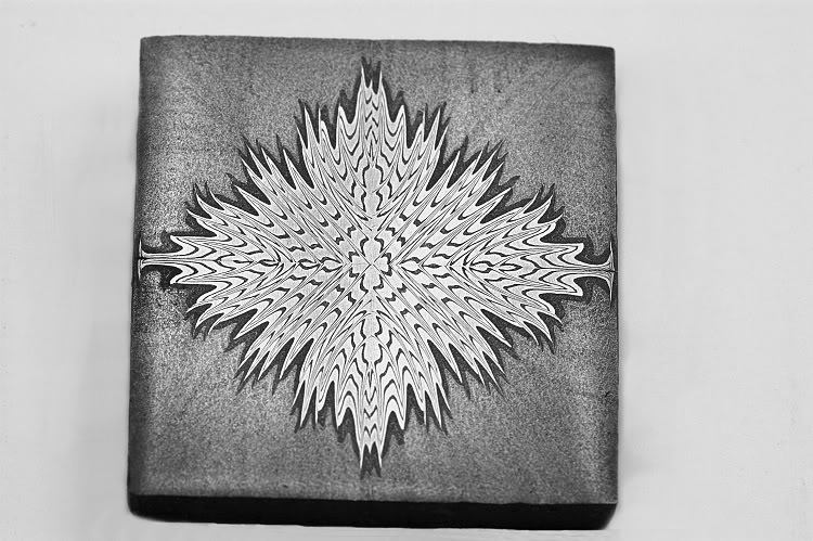

What about forge welding? I have a couple of pieces that I made of O1/15N20 that I am trying to turn into what I call an "explosion" pattern (as demonstrated in, I think, Gunther Lobach's book,"Damascus Steel: Theory and Practice") for a guard.
I'm pretty sure I was above 1900F while welding and no crumbling. Did I get lucky? Do I not have a good eye for color? or is the steel no good for a blade now?

I haven't observed red short steels to suffer a whole lot from being forge welded in thin layers with other steels. I've built billets with CruForgeV just fine, welding at probably 2300 degrees max, with no problems. I've used 52100 as a core layer for stainless san mai, which gets welded up probably upwards of 2400 degrees with a soak, and no problems either. I have observed crumbling more when the steel in question is alone, or constitutes a very thick piece in a weld.
For instance, I was welding CruV edges onto a twistcore billet, at about 3/8" thick, and the heat at that point made it crumble.
Thanks
That's really sweet looking. I will have to look it up.
