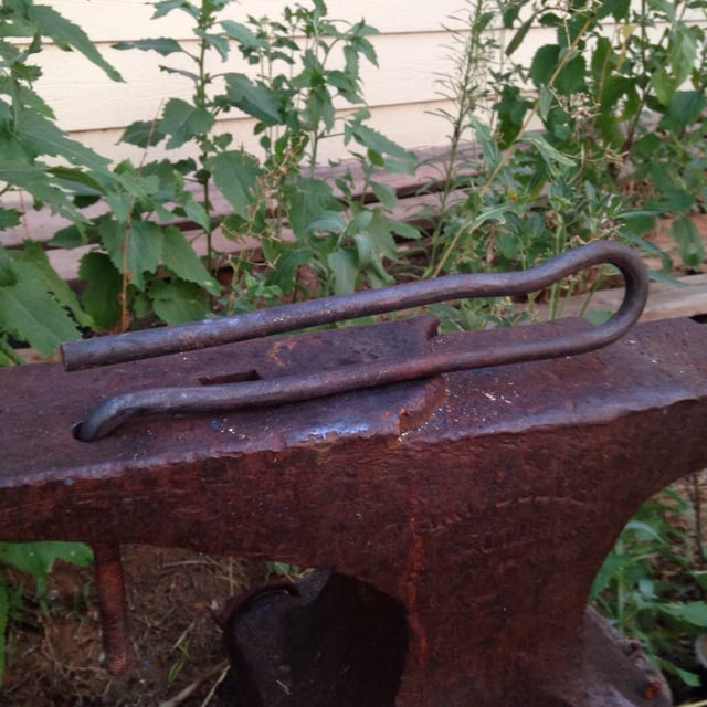

I figure if I'm going to buy anything, he needs to be a good set of tongs to replace my home made ones, and then start hunting for a better anvil.
So I found some round stock and rigged this up.

On a side note that fuller you made is about as simple as it gets and I have some mild steel that would work. I think I will make one this week until I make something a bit more permanent.
-Clint
I have seen the fullers like that. Raymond Richard had pics up of his one time. Called it Godzilla if I recall...
