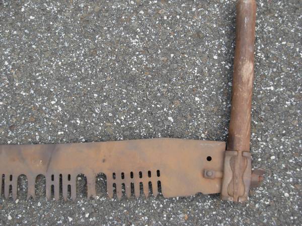

i just got a couple of fine cross cut saws. they are in very good, working condition, but i will clean up the hardware a bit, and oil the handles and ...
pretty darn cool that my saw came with the set tool :D
also a nice one man saw (cross cut style)

Great little felling saw you have there. The curve in the back of the saw is to make room for wedges in the kerf. A bucking saw would be flat across the back.

I think those hand sets were made for carpenters saws. Crosscut saws were most often set either by wrenching or more often hammered over a small hand held anvil shaped like a hammer head.
