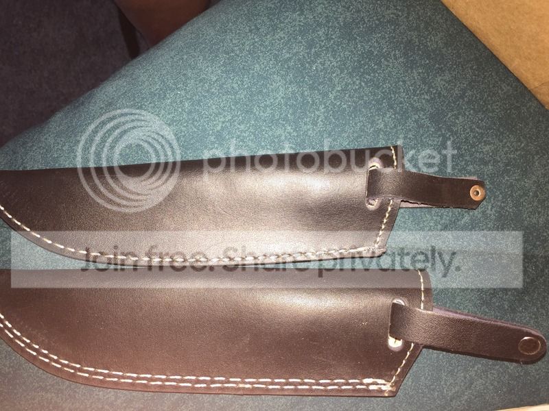

I did that early on in my sheath making forays--to cure that, I cut off the tab meant for the belt loop and punched an rectangular hole/slot in the top of the back side of the sheath, then put a proper length loop through the slot, stitched the two ends together making a loop that way. That knife/sheath ended up with a fella I know well, and I pointed it out to him when he bought the knife, and he has kept tabs on it for me, and says it is working well, and seems to be plenty durable--he's a self described 'rough on his gear' type guy, and the 'loop' is holding up fine. I've actually made some sheaths where I made them that way intentionally, built the loop with a rivet instead of stitching it together--I can shoot you a pic if you want--just let me know.
I would sure appreciate a picture of this idea (I'm having a hard time imagining it). You can either pm it to me or just post it here.

Randy, sorry to be a little late in getting this to you--been away from BF's for a couple days. I'll try and attach a pic, tried to send it by PM as well.
