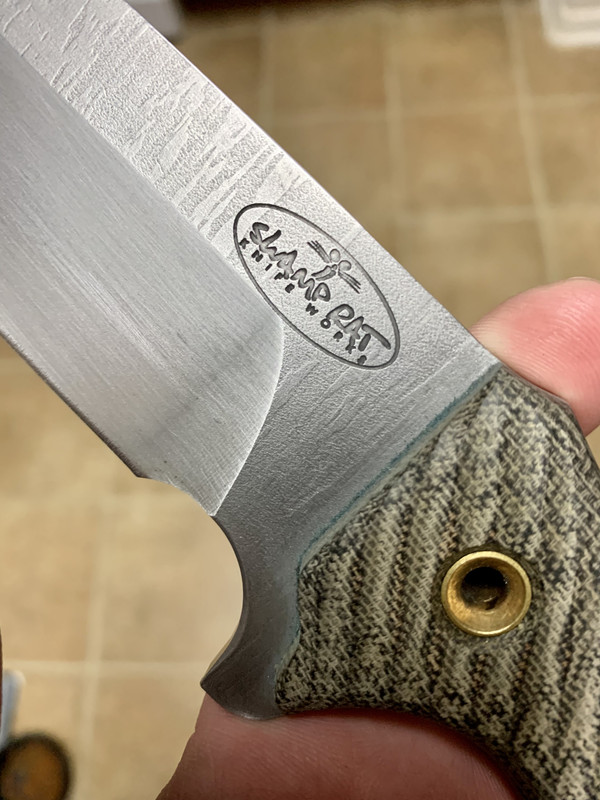

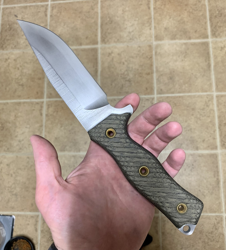

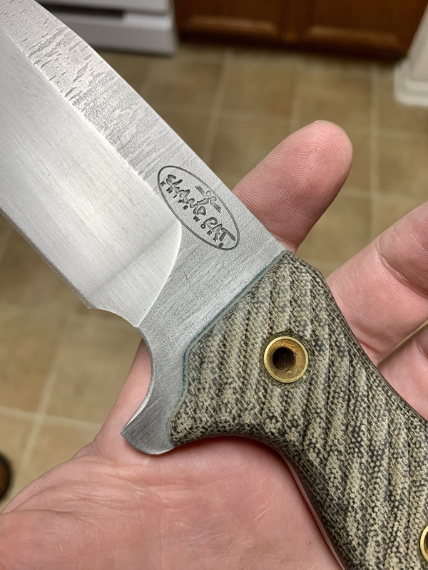

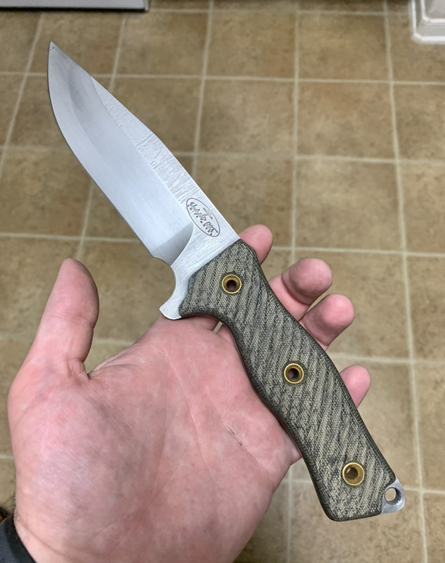

Looks great! This is my favorite stripper. Started with this black coated M6.
Etched the logo with salt water and a 9v.
Stripped the coating with some stuff in a yellow can from Walmart, then used green 3M pads and followed it up with 0000 steel wool. She was beautiful under all that coating, just had to do my part to reveal her beauty.
Logo came out super crisp and deep. Love it!
Differential heat treat line is clearly visible. She’s dead sexy now!
