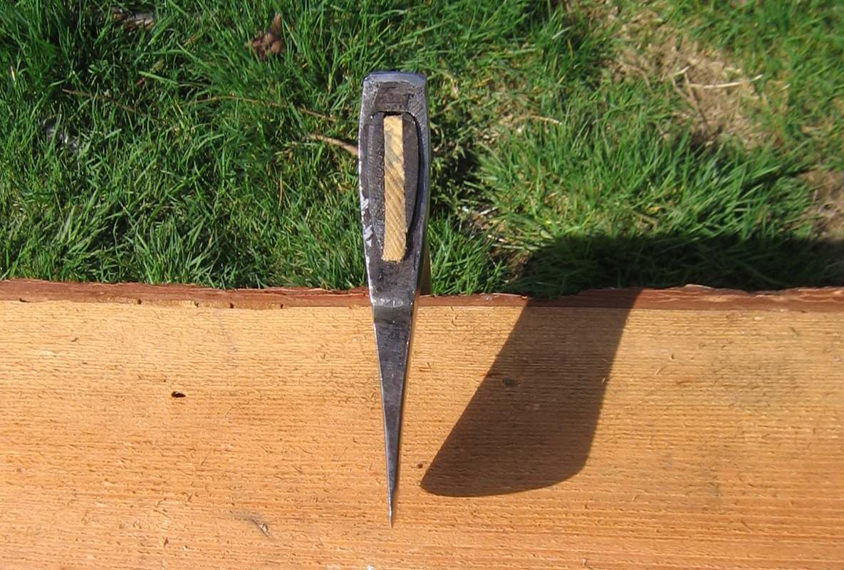

Does the eye look like this?

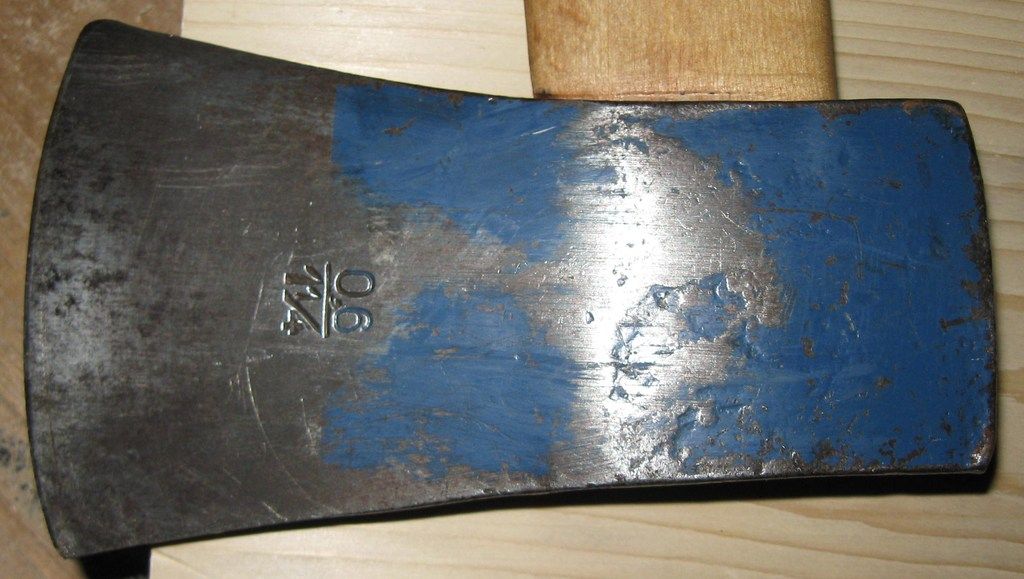

If you decide to paint and want the original color, here is an example. You can also make out the original paint line.
I'm not saying that your particular axe was painted this way, but most I've seen have this color. What I don't remember seeing is the stamping on the left side of the head like yours. It appears to have the weight on the left side with the H B logo. I'm used to seeing the logo on the left and the weight on the right. It would be interesting (to me) to know more about it.

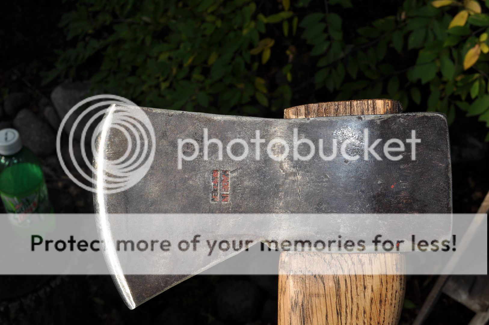

Its been my experience with vintage HB axe heads that the eye size is not standard. I have a 1 1/4lb like the one that rjdankert posted that is on the wide side for a boys axe but it will fit. I also have one in the same pattern and weight that you posted. Mine is a full size eye and then some. It will fit a full size single bit handle but you must move the head further down onto the shoulder to compensate for the extra width of the HB eye.
Apparently yours is a boys axe handle size? If its a full size eye House handle makes one in a 28" length. Throw in an extra buck or two and get hand selected no lacquer.

I think you could make a standard boys axe handle work with that. As I recall those Hults Bruk Montreal patterns have a lightly different shaped eye than American axes - wider and flatter at the poll. They're designed for ash handles not hickory - it's what's available in Europe.

My eye looks like this
It definitely needs to be slimmed down, and I was thinking it could do with a bit of a trim job as well.
Thanks for the reference picture, I appreciate it. The opposite side of my head is blank, or if there was anything, it'd been pitted anyway.

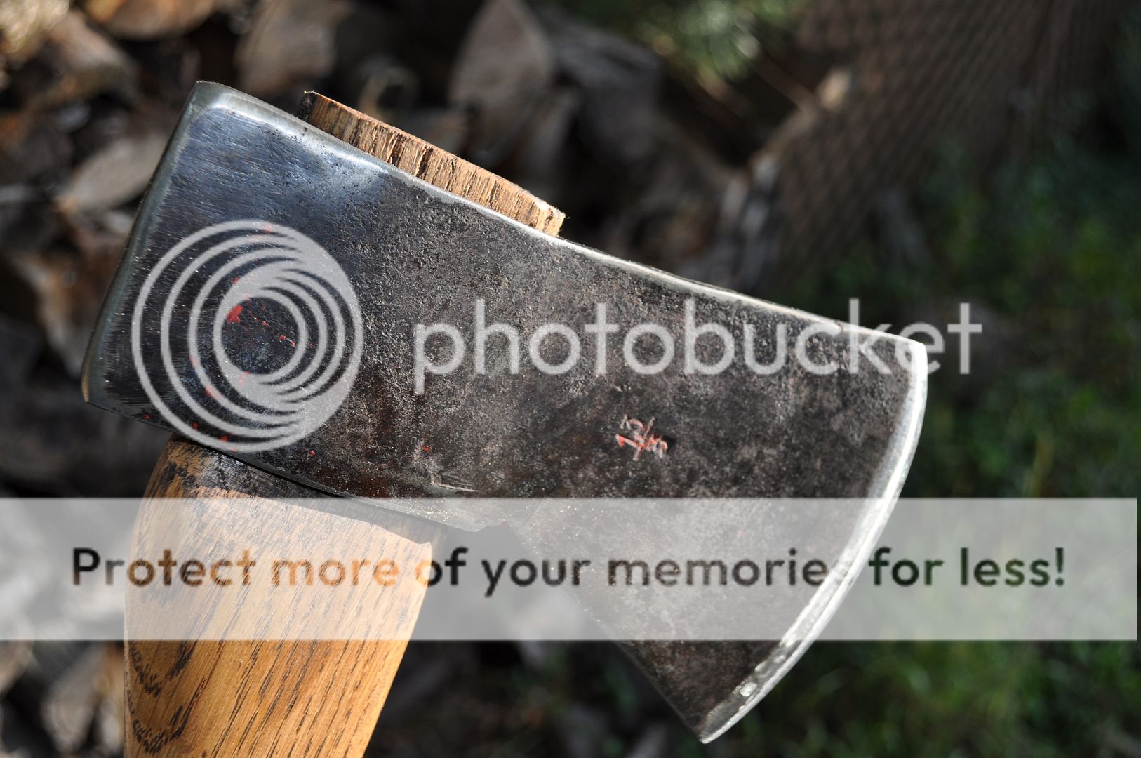

I found an older picture of the head before I cleaned it up too much and it looks like originally it was painted red or a dark orange?
Cory
I think there were some surplus ones brought in a few years ago that were orange painted.

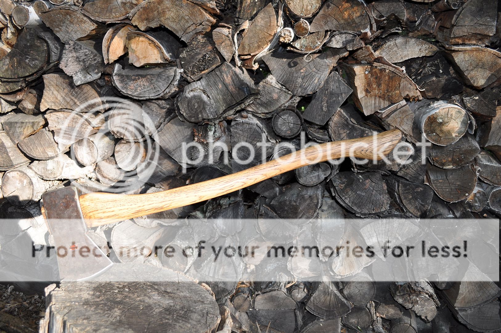

I think that head looks great the way it is and the handle strikes me as right as well. Maybe it could use thinned but that looks like a winning set-up from this angle.
