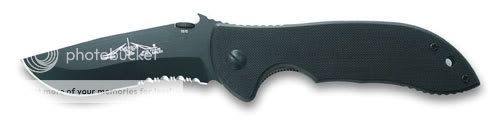

Here are examples of a clone:
http://www.tupianguanjia.com/bin/348/SN032A.jpg
http://www.tupianguanjia.com/bin/348/SN032B.jpg
http://www.tupianguanjia.com/bin/348/SN032C.jpg
http://www.tupianguanjia.com/bin/348/SN032D.jpg
that clone is amazing..I could hardly tell the difference except for the silver thumbstub...
thats clone LOOKS pretty close, no doubt the best copy i have seen yet, all the other ones i have seen were not anyway near that close.
wow.
Oh, I'm not saying it's a bad knife. In fact the one I got is real nice just not the real goods. There are design differences [the back of the blade is different form my 2006 and Super, I'm assuming that the linerlocks might have different shapes. The Emersons closes the fake closes with 2 clicks] but until I get the correct torx wrench the knife stays together.
I saw a Commander clone at the Spy Shop at Fisherman's Wharf in San Francisco. I think they were asking $60 for it, but the fit and finish were atrocious and it wouldn't even lock up properly. Had a lot of blade wobble in the open position. The guy behind the counter didn't even know what the wave was used for.
Is the "WeBeKnives" shop still there? They had quite a few Emersons last time I was there, and even picked up a 7A from them.

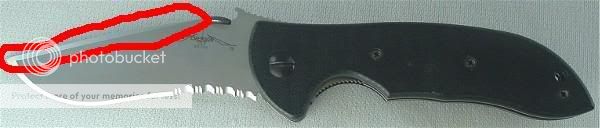

So, there is a seller who has a used 2000 for sale now, the pictures he's added are just too good to ignore. Take a look and compare to the clones, it's amazing. From the photos the only visible differences is the logo, thumb screw and scale screws,
http://home.comcast.net/~terrysstuff/emerson_2000_knife_1.jpg
http://home.comcast.net/~terrysstuff/emerson_2000_knife_2.jpg
http://home.comcast.net/~terrysstuff/emerson_2000_knife_3.jpg
http://home.comcast.net/~terrysstuff/emerson_2000_knife_4.jpg
Not my pictures
Not my pictures
So the 2000's have that angle on the back/top of the blade?
Looking at my new commander it's missing that.
The screw pattern is different. Like I said earlier, I don't have the correct size Torx to disassemble my fake, but I do have a Raven 2000. The Raven has a row of screws to join the scale to the liner, that is their purpose. In my 2006 Commander there are 5 screws 2 long screws on stagered either side to hold the knife together and the central pivot, seven for the Super Commander.
This change alone makes it easier and cheaper to construct and maintain. Three fewer holes in each liner. I figure just changing the way the knives are screwed together probably saved $.50-$1.00 per knife, made the assembly line move much smoother, generated less scrap. My little Commander is a 2006 numbered 8260. That little design change saved Emerson $5K - $10K for 2006, not a bad chunk of change. This little change improved the quality of the knife.
The blade, as you note, changed too. I count 4 design changes but will only mention the tapered top you notice. Without the top grind the knife is easier to manufacture, stronger too. Another series of steps that saves another $0.50-$1.00 a blade. Aesthetically I like the added grind, more dagerish, less tool.
I pulled the one I thought was fake. The seller says it's real.
The pictures I posted are from an "authentic fake". It uses TORX.
The other set is from an authentic 2000.
