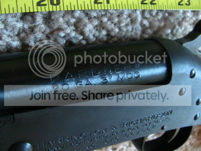

I've been on sort of a quest for a while now, hunting for an ideal woods shotgun. There several criteria, but it needed to be lightweight, simple, rugged, well-balanced, and versatile. I was initially up in the air about gauge, but decided to go with 20 gauge due to perceived needs and smaller/lighter ammo. I knew I wanted H&R brand however as a single shot is the only action type that suited my 'theme'.
I'd been going back and forth on how to go about building it though, because I wanted a short-ish barrel length, and most of them have 26" barrels or longer. I finally stumbled upon a 20 ga H&R Pardner Youth model a my local shop however! It's a perfect fit and brand new, though LOP is a little short, and it's got a wood stock. The barrel length is 22" which is a little longer than I wanted, but it is 'pretty close' and saves me from having to visit (and pay) a 'smith to shorten it and add screw in chokes. The Pardner is also a modified choke which is a good compromise for my needs.
I took the synthetic stocks off my .45-70 H&R Handi-rifle, which already have sling studs and a recoil pad, and put them onto the 20ga instead. Talk about perfect! Incredibly rugged, simple design, with a very light overall package (I'd guess around 5 lbs or so now) and a scant 38" OAL. It'll have some kick, but that's a very acceptable trade off to me. Now I'm just considering getting a butt cuff to hold a few extra rounds.
Forgive me if you're already familiar with these concepts...
In shotgunning, fit is everything. If the LOP is too short, it's really not a perfect fit. Generally, short LOP causes shots to go high. Your cheek rests farther forward on the upward-sloping comb, causing your eye ("rear sight") to be higher than it should. A longer LOP moves your cheek back --and down-- the comb, lowering your shots
Off-the-shelf shotguns don't fit me at all, and it was years before I learned the importance of gun fit in shotgunning. A lot of ducks, geese and especially, grouse are alive because of my late learning. Nowadays, they're at risk. :D

Thanks for the good advice! I very much agree with you, having only one point to sight along makes things more delicate indeed. Having switched the 'youth' stock for the adult size handi-rifle stock w/ recoil pad makes it fit me perfectly, however. Lucky!

A bit of advice though, I've used Butt cuffs before and they really screw up the balance of a gun. You're better off getting a belt slide to keep your extra rounds.
Nice gun!
Thanks! I haven't used one before, and that was a concern. I may go the belt route. :thumbup: Plus it's a little more in keeping with KISS.
