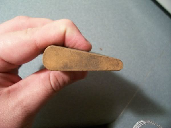

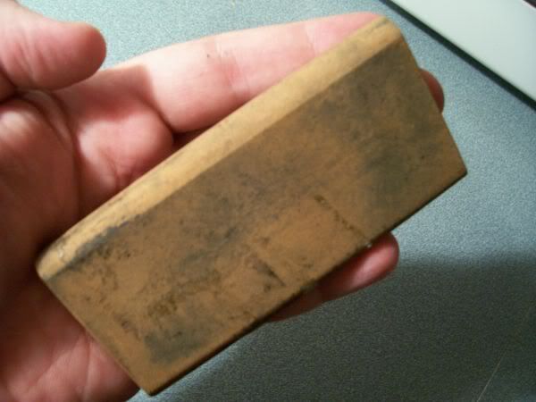

P psycho78 Joined Jun 17, 2006 Messages 1,108 Sep 12, 2006 #1 Went to a yard sale and found this old Norton stone in the box. Gave the guy a dollar for it. How old do you think this is? There seems to be some gunk on the stone, how would I get that off?
R rooster11 Joined Nov 1, 2005 Messages 14 Sep 12, 2006 #2 I've got 2 of those, I use comet cleanser and a scrub brush.
J John Frankl Joined Oct 16, 2001 Messages 1,917 Sep 12, 2006 #3 Or boil it in water with lots of laundry or other detergent. Watch for foamy boil-overs! John

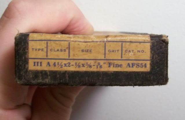

P psycho78 Joined Jun 17, 2006 Messages 1,108 Sep 13, 2006 #4 What period in time do you think this thing is from? I'm guessing late 50's? Thanks for the tips. I tried this one out yesterday, and it cuts really well.
