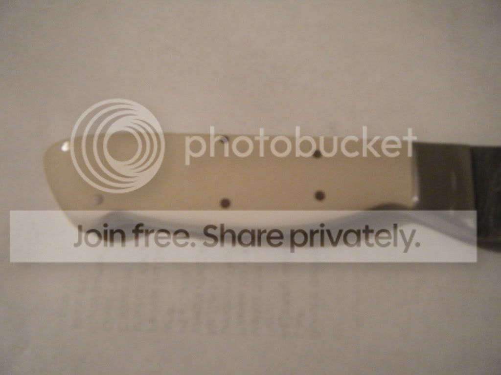

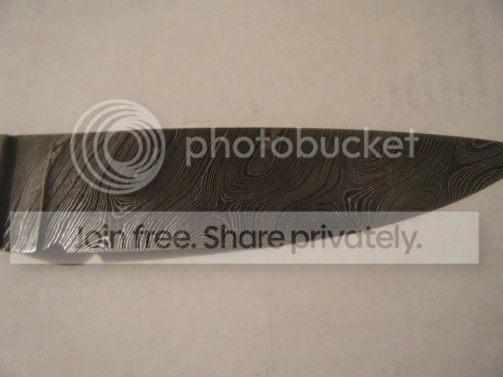

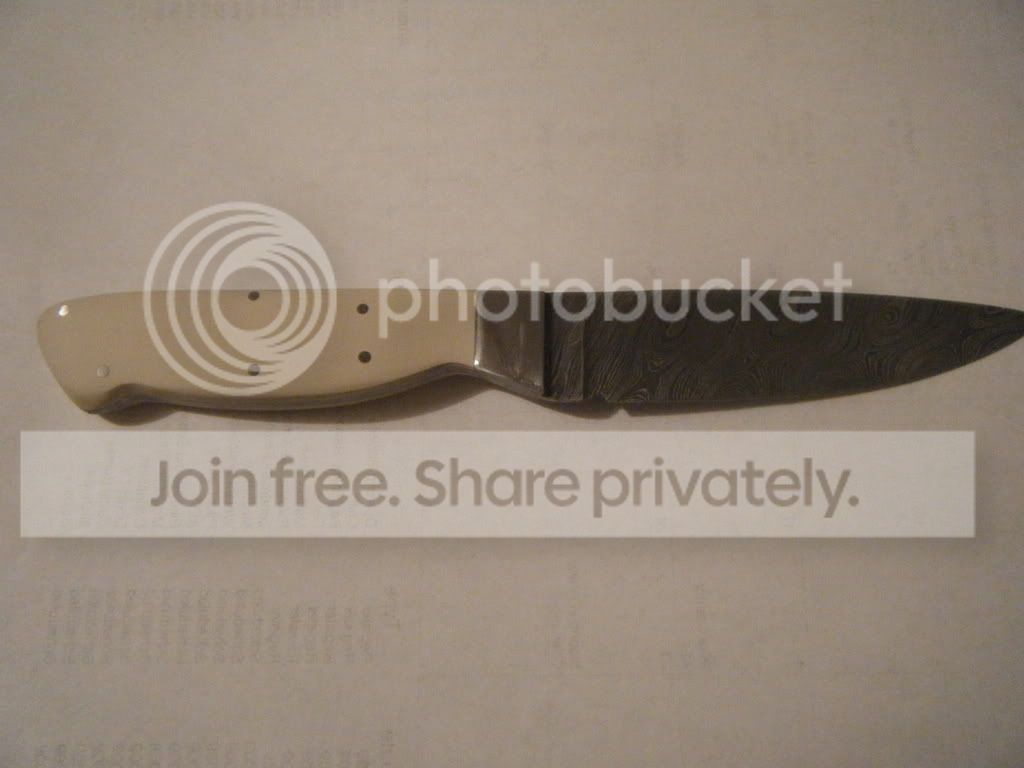

Here are some pics of my fourth knife, made some mistakes but learned what does not work:)
The blade is damascus that was given to me by a friend, sorry i cant remember what forge it is from.
The gaurd and pins are stainless, handles are Ivory micarta
Still needs alot of hand finishing but just wanted to get some input, what could i change to make it better?:confused:
Sorry about the poor pic quality. I saw a poor mans pic booth on here that im going to build.
Good looking knife. Since you asked for comments, I'll give you my two cents (and my opinions aren't worth much more than that...just ask my wife ;) ).
I would enlarge and move slightly forward the radius on the bottom front of the handle. Maybe use a one inch 1/2 round file to create a smoother radius, and move it forward so that it intersects with the bolster slightly. That way you have a radius to the bottom of your bolster instead of the straight diagonal line you have now. I don't even know that you have to move it forward any, but enlarging it would make it more pleasing to my eye and maybe more comfortable to hand as well. Also maybe slightly increase the radius of the cutout at the rear of the handle as well.
I also would have maybe brought that middle top pin down a bit. Seems close to the edge of the handle.
One other thing, I would either enlarge the choil slightly so that it intersects with the bottom of the ricasso, or in future knives, move it back some so it intersects. The slope into the choil from the bottom of the ricasso looks a little off to me. You could probably take a dremel and grinding stone and accomplish that with this knife as well, if you wanted to.
Again, just my opinion for what it's worth, and more suggestions than criticism. It really is a lovely looking little knife for a 4th one! I love damascus with ivory micarta.

I think it looks good. Other than the finishing that you have left to do, I think maybe the placement of the pins on the handle would look better in a more of a symetrical pattern. Other than that looks great for a fourth knife.

Nice knife, especially for the fourth one. Since you asked, I'll point out what I would pay attention to next time. Your grinds looks good.
- Try to keep your pins symmetrical about the center line, or center curve, of the handle. Pins that are out of place stick out like a sore thumb. It doesn't really do anything for strength, but it makes it much more pleasing to look at.
- Your choil is a little far forward, atleast by my standards. It is also an odd shape, but perhaps that's the photo. Small choils, in my mind, look the best when they have a small radius, like a small chainsaw file, and line up with the plunge cut.

Thanks for the prompt and honest input guys, thats the only way i can improve.
The pins seem to be giving me trouble, Ive thought about drawing intersecting lines before i drill to get them lined up. On this one I thought i had a little better pattern until i already had it pinned.
As for the choil, it was a boo boo, will move it back.:)
Also I think I will increase the radius behind the bolster.

Hi - I don't think you need to change much of the shape, the knife flow looks decent to me. Here are my suggestions:
Do all of your hand finishing of the blade before you put the handle on. Don't be tempted, I know you want to see the knife, but it's always easier to work on when it's just a blank.
I also agree that your sharpening notch is a bit off, most folks shoot for half in the grind, half in the unground portion of the ricasso. If you make mistakes, it's not so bad to push it forwards some, but it looks better if it doesn't start beyond the plunge.
For pin placement, you want to try and form some shape or symmetry with the pins. You can measure them, but I think you really just need to lay them out on the tang with a sharpie. If they don't look right, erase and draw them again. Spend some time looking at the knife, you really need to look at it and tell yourself if the holes need to move. If you've got someone else around your place, ask them what they think of placement before you drill. Sometimes our eyes are kinder than a third party.
One more thing I forgot to mention. It makes sharpening a little easier if the edge extends below the ricasso just a bit. The way this blade is designed the user doesn't have much room for error when sharpening the blade and could easily scratch the ricasso on the stone.
