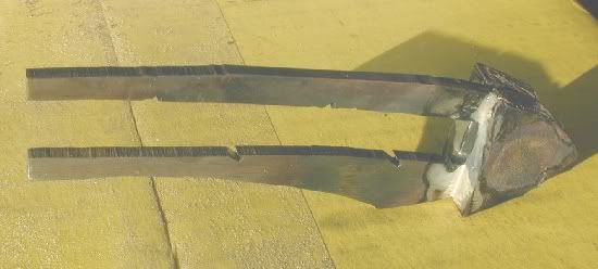

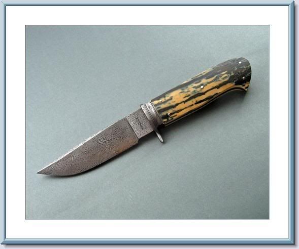

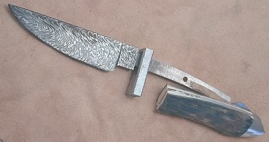

I have included some good in process photos form both Jerry Fisk and Tim Hancock to help demonstrate the process. The Fisk also has a rear bolster and the Hancock fileworked spacers both adding to the complexity. In my opinion, these two makers are among the very best at this method of handle construction.
Note the small groves Jerry cuts into the interior of the frame to allow bonding material to seep in, increasing the bond to the tang. A slight task but one that helps.
