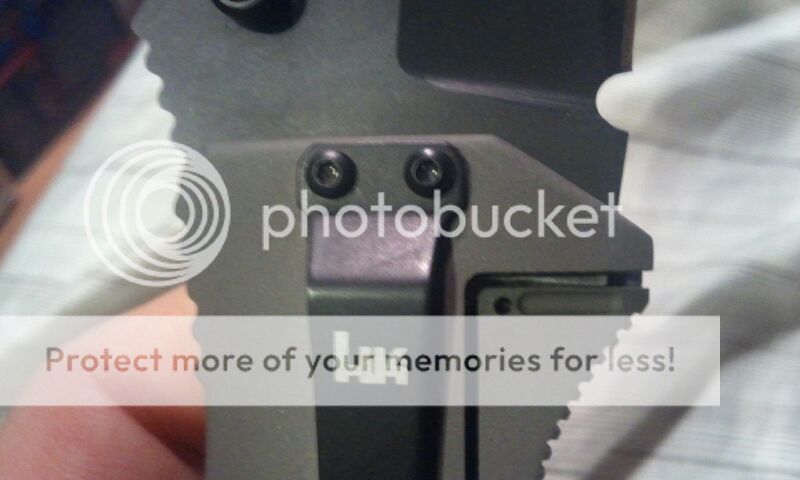

frame lock...should the lock bar....?
jbmonkey
baldcypressswampmapleslashpineandcabbagepalm
Platinum Member
Jun 9, 2011
32,790
sit flush with the blade end....in other words make contact from the front to the back of the lockbar when looking at it from the side of the knife?
i got one of those hk conspiracy knives.....while looking it over i noticed when opened, and looking at the side of it, the lock bar only touches the front of the blade side. the back side of the blade end(sorry don't know the right term for this part)doesn't touch. there is a gap looking at the side of the frame lock bar between the backside of the bar and the knife blade rear.....is this a bad thing for long term wear? i never bothered to check any other frame lock i own.....to see. will be doing that tonight after work. i always thought the entire lock bar surface should contact the blade end fully from front to back? did i get that wrong?
thanks in advance for information.

This is what you mean correct?
He is talking about the face of the lockbar making contact with the blade tang along it's entire length. That length could be anywhere from 1/8" and up/down, depending on where the lock is cut in the handle.
Gotcha. Thanks for the clarification. I figured it could use a picture just in case.

No Sir. Turn the knife to the side and look at the lock bar as it sits on the blade. I checked my other frame locks and they are flush or no gaps. Not this one though. Seems it will develop play sooner or later. Its a strange deal to my untrained eye.

THIS is what I was trying to say.:thumbup::) It is the bottom to top of the lockbar, and not the thickness of the lockbar, that he is talking about. The picture you posted is about where I like the locbar to be on my knives.
Edited to add;
Though pretty crappy, this pic shows the how the lockbar covers the tang of the blade in such a way that there is not open space between.

Can you post a pic of the lockup?
yeah, sorry about the wait on the pictures....here you go.....
cellphone pics, sorry about low quality the dark area is the back of the blade not touching the lock bar. so it only touches in the very, very front. hard to capture in a picture. also the pictures don't really capture it all that well...in your hand in the metal it's much easier to see what i am asking about. so y'all are gonna have to trust me somewhat.....thanks.
