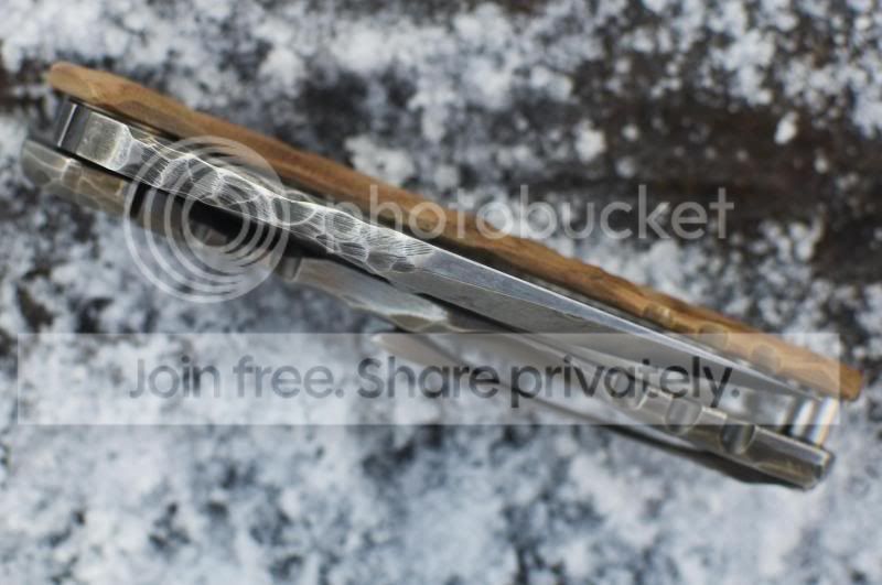

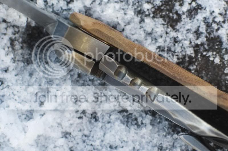

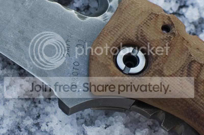

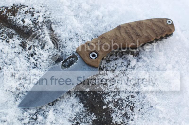

I finished it today. It was an interesting project. I made a friction folder last year and a prototype framelock with 1080 for the lock side but never completed it. This is the first completed framelock I have made. Its also the first time I have worked with D2 and I am curious to see how my heat treating turned out.
Details
Steel: 1/4" D2
Blade length: 3 1/2"
Overall: 8"
Handles: .200 titanium and .190 G10
Finish: Blade is etched and stone washed, lock frame is soaked in oxyclean and scrubbed with scotchbrite pad
Parts: 1/4" chainring bolt for pivot, 1/4" standoff, 3/16" stop pin

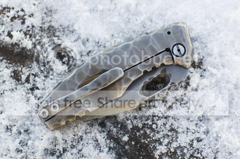

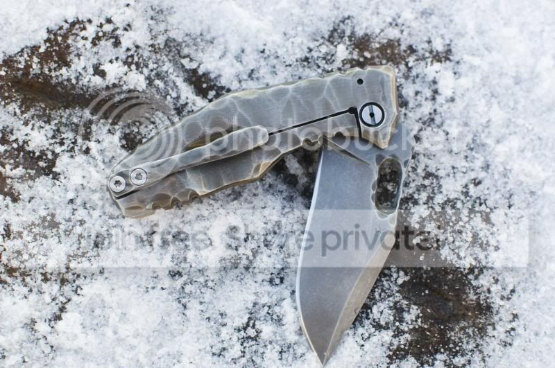

I am really happy with how it turned out. The lock is pretty stiff but it is still very functional. There is some stickiness in the lock but over time I think it will break in with use, it is already getting better. I did most of this work without a mill. The only time a mill was used was for the thumb recess. The two things I would like to improve are the lock face and the lockup position. I want to carbidize the lockface to make it wear less but that will have to wait until I buy a carbidizer. I also wanted the lockup to be earlier than it is. I wanted it around 30% and it ended up around 50%. I have a stop pin that is a little larger that I could use to get the lockup where I wanted it but I really like how it locks up as is so I will leave it this way for now.
Thanks for looking!
