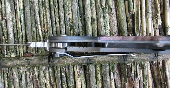

Any thoughts on the lockup on this framelock?
Any improvements that could be made?
Your advise is highly appreciated!
The lockup could be OK, I've seen several framelocks that engage about that much.
I would do a light spine whack, or put a little pressure on the lock (carefully) to see if it starts to slip. It may just be the angle of the photo, but the lockbar face looks more square then I would expect.
Well... that kind of lockup would probably make me somewhat nervous. You should try some tests to see how solid it is.
We're missing some information here though. Who is the maker and have you talked to him (or they) about how the lock engages?

Yes, I have spoken to the maker and this thread is supposed to settle a difference of opinion about the lock.
He insists the face of the lockbar should remain absolutely flat, like it is now.
Looks to me that this way only a 90° corner of the lockbar is supporting the sloped base of the blade.
Shouldn't the lockbar-face be at an angle too, so there is more metal actually making contact?

I've seen that many times and just don't understand it at all unless the makers realize that the lock will eventually break in as it wears and then move farther across the back of the blade. I've seen this done like that primarily with titanium locks because the ti is softer and will wear faster than an equal thickness of hardened stainless. If the lock is stainless however, it will probably be like that for a very long time without change. (use a magnet and see if steel or titanium.)

I'd say if it passes the pressure test and a light spine whack you're OK. You can always send it back in for adjustment if required right?
My experience with framelocks has been that this is a very individual thing from knife to knife. What "looks" secure or insecure may not be the case in actual, practical use. I don't think you can draw any conclusions simply by looking at the situation.
Some reasonable spine-whacks as suggested above may give you some guidance--or maybe give the maker a call.

Aside from how far lateral the lock engages, you also need to know the vertical engagement and how polished are both of the engagement surfaces.
Take a felt tip marker and color the tang. Then open and close the knife until you can see where the lock engages. Also, how "sticky" is the engagement of the lock? Apply pressure to the spine of the knife when open. Does the blade pull away from the blade stop? Does the lock shift at all?
I have a frame lock that engages about the same as this one, myabe less. It's one of the stoutest locks I have seen.
When executed properly, you would be surprised how little the lock has to engage to work correctly. At the same time, if it isn't done correctly, the lock could go all the way over and still fail.
Most makers can make a frame lock or liner lock that will function. Far less make them correctly.

Sometimes, with liner locks and framelocks, there's a very quick "break-in" period, where the lock will move quickly across the face of the blade tang. I would not test that lock in any way (spine whack, etc.) until you break it in a bit more. What I'd do is, say, 20 hard openings to get some quick wear. After a few of those openings, squeeze the knife tightly in your hand so the lock gets finger pressure, and torque the blade a bit. What we're trying to do is quickly wear the lock face in a bit, and let the frame settle anywhere it needs to. If 20 doesn't work, try 50. There, now the lock should have a lot more solid contact with the blade tang. Now you can spine whack and torque test it for real.

That picture is over in Shop Talk and what wasn't mentioned in this post is that it hasn't been heat treated or final fitted yet.
Look fine to me before heat treat. Lockbar at 90 degrees square and the engagement area of the blade at 8.5 to 10 degree angle.

It is perfectly fine. Notice how the blade tang is angled and that if the lock wears in the lock face will lay flatter against the tang. If the lock face was angled to meet the tang now pressure on the lock would force it to push out and fail. Drop a stick of wood in your miter and cut it at a 15 degree angle. Take the cut ends and push them together, you will see they want to slip past each other. Now flip one piece around and push the flat end against the angled piece. They will stick much better.

I hate to bore anyone but I have been called a troll on the shoptalk forum, so here's what I posted there as a reply:

First of all, the 90° thing.
I own only 2 framelocks and had a Mission MPF1-S at hand when I came across the pictures of Deviant's knife.
It's lockbar is cut at the same angle as the blade and provides exellent lockup. (so are most of my linerlocks)
I'm not sure of course but it really looks like this isn't the result of wear but was done like this at the factory.

I asked the same about Strider lockups and only a corner of the lockbar touching the tang a while back at the Badlands and here's the answer I recieved along with my original question.
Question:
Can someone explain how a super sharp tang angle on the production Strider framelocks is a good thing?
Answer:
Cut & Pasted from another forum as quoted by Mick:
"The reason we only want contact at the lower section of the lock bar is this:
1. For the most solid lock, you need two points of contact, as far apart as possible. (bump stop and lock face)
2. For the most solid lock, your lock contact should be as far away from the center line of the pivot as possible. This keeps your lock from "rolling" off the blade.
3. No matter how far from the pivot center your lock surface is, if its contaminated with crap (sand), it will fail. We send knives into some nasty ****. This is a huge concern for us. By making contact at the lowest section only, it creates a "**** vent" above the lock surface. That is the same reason we make our detent hole go all the way through the blade....its a "**** vent"."
The quote was provided by Brian Huber at the Badlands.
Personally I'd rather have the tang mated to the lockbar but Mick's reasoning sounds intellegent too. Also, I agree that there is a break in period that will gradually move the lockbar to it's final resting place on frame/liner locks.
