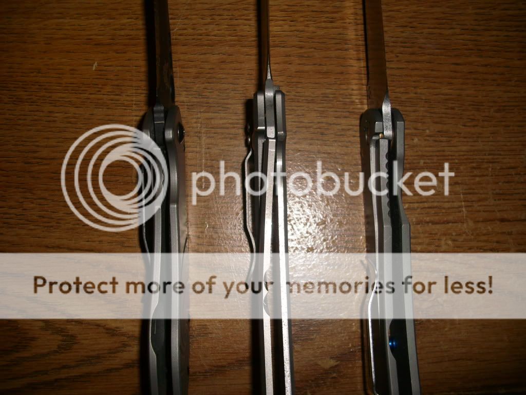

I apologise for using the wrong term (overextension).What I really meant was wear.Where the lock travels all the way to the other side.
I'm mostly worried about this happening to a high end knife.I mean if I'm going to spend $400-$500 on a knife,I'd expect it to last a long time.
Here's a pic of three of my Ti framelocks to give you a better idea of what I'm talking about.The Bradley's still like new.The others have been used carried quite a bit.
From left to right-BM 635-CRKT S-2-Bradley Alias 1

JTR357, Does the Skirmish have vertical blade play or side to side? From the pics it does not appear that it's lock bar is worn all the way over.

tjsulli790,The bladeplay is side to side.It's really not that big a deal I suppose.I just hate any kind of bladeplay.Also the blade isn't centered anymore,another pet peeve of mine :o.

Have you had any success adjusting the pivot screw? That should cure the side to side play you have developed, I think if the knife's lock was at fault you would experience the vertical play. And don't worry many share the same sentiments as you, I can normally live with an off center blade but it still bothers me.
Have you had any success adjusting the pivot screw? That should cure the side to side play you have developed.
Yes,I've adjusted it.However,if I tighten it too much,there's no play,but it doesn't open easily.I like to grab the blade & snap it open,rather than use the opening hole.
