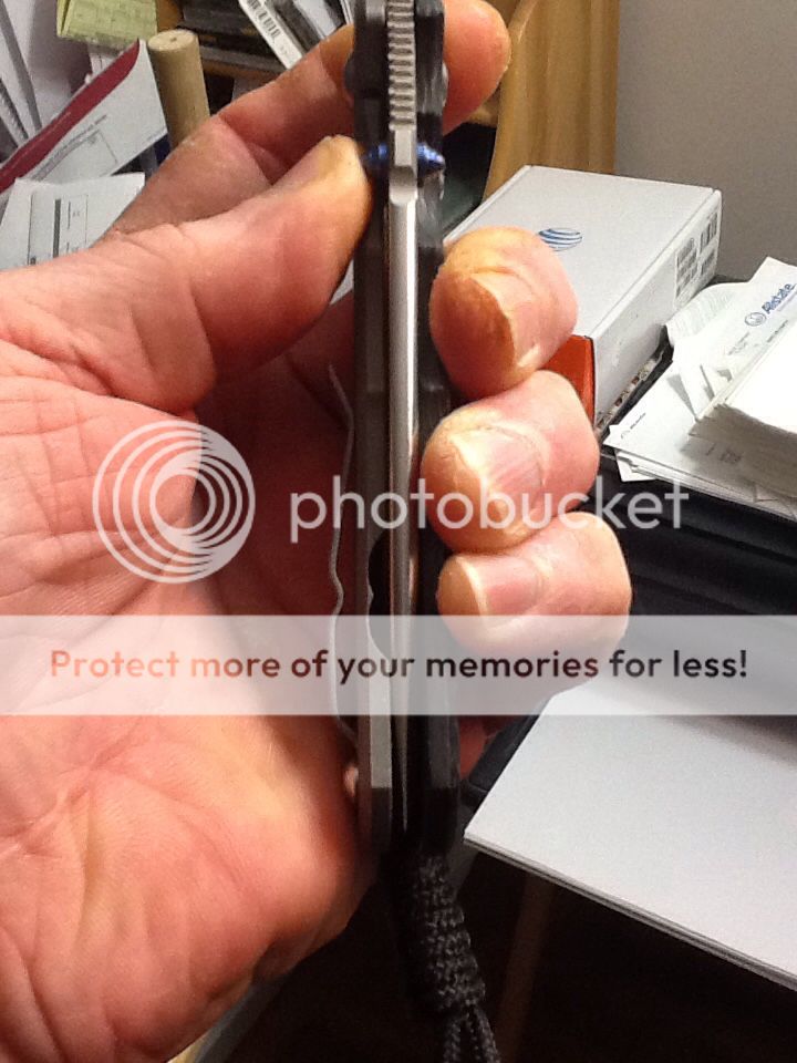

So every frame-lock I have ever handled had the same problem (i.e. ZT 0562 and Sebenza). I can't get the damn suckers open. The way I grab the knife my dominant fingers fall on the frame-lock. Hence when I engage the flipper or thumb-stud I am putting extra pressure on the detent. The more secure my grip the harder the damn things are to open. Now I can get around this by holding it all weird/weak, but that doesn't seem right. Given the finesse needed to smoothly open these I just don't think that is something I would want to do under stress. In other words it is a big minus for tactical applications (IMO).
Is this something that you all experience too? Or am I just doing it wrong?

I'm left handed, I have no issues deploying a right handed knife with either hand. It's a matter of positioning fingers to avoid the lock bar. I use the pocket clip as a point of contact pressure and the top edge of the lock bar and apply pressure downward instead of across the knife. It's second nature for me to open a knife in this manner. You may just need to acclimate yourself until it feels natural.

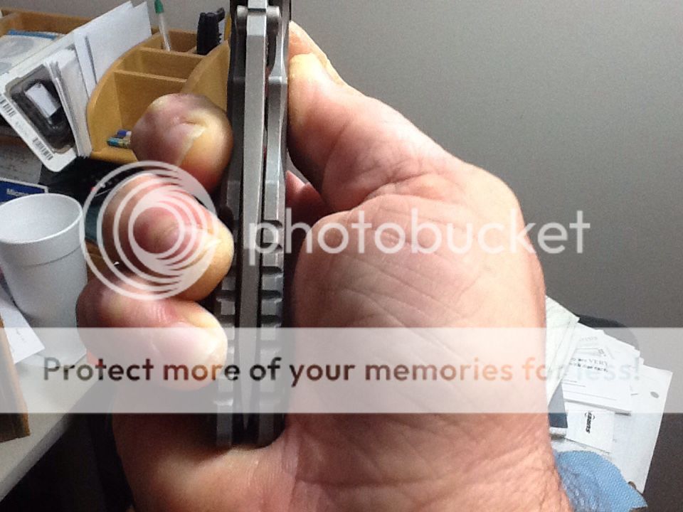

I know what you mean but I've never had that major a problem with it. I usually anchor my last two or three fingers to the clip somehow to give opening leverage and stability---usually allows the fingers to pull back from the lockbar slightly. I may notice more difficulty opening knives with no clip to anchor to but I rarely handle such animals. Do the knives you are experiencing this with have clips?

Got it. So you do avoid the lockbar. When I put my fingers on the pocket clip of the ZT then it flies right out.

Yes! I am getting the feeling that I am just "doing it wrong". Frame-locks are new to me. I guess my hands just have to get used to them. I should give it a couple of months of daily carry before I judge it. (Maybe I will warm up to lock-backs too... )
Thanks everyone! This has made me feel a little bit less dumb. I guess opening the ZT562 just takes slightly different technique.

Framelocks with exposed bars are definitely harder than ones where a clip covers the bar. Also, with the Sebenza you use your nail more than the pad of your thumb.
Dude, let it break in a bit. My Sebenza was pretty stiff detent-wise when it was brand new. After a few weeks it smoothed out considerably. Now it doesn't matter how I hold it; it opens just fine.

Yes - I've had the same experience. It's due to putting pressure on the pocket clip, or lockbar with your fingers. It goes away after awhile and you get accustomed on how you need to hold it while you open it. I don't notice it anymore on my CRK's.
On knives where the pocket clip is only half on the lockbar, and the other half on the frame, you've never noticed it because your fingers on the clip aren't applying pressure on the lockbar.
