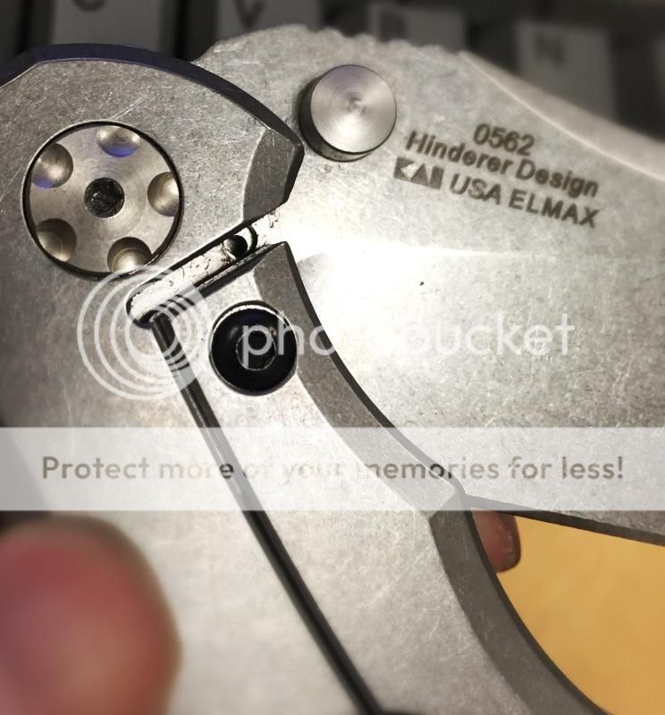

You more than likely have one with a countersink. A customer recently pointed this out to me. Most ZT0562s only have one perfect hole where the detent ball snaps in. Some however have what looks like a larger hole with a smaller hole in it. These make the knife lock up tighter. Some people love it because the knife flies out when it breaks the detent, others do not like it so much. If you open the knife and look down as the hole passes the space on the lockbar you will be able to see what I am talking about. Any added pressure just makes it that much harder to open!
My 0562 (#1399) has the counntersunk (2 holes) detent hole. I'd say it has a strong detent. Also, the detent ball when closed sits all the way in the blade.
Strangely I can open the knife with my left hand easier than my RH. I'm right handed. Any idea why some of the 0562s have the two holes? Pic below of the 2 drilled holes.
I have the double detend.
