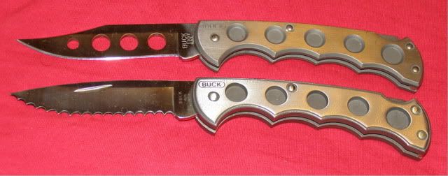

I tried various setups last night...biggest problem is how to clamp it... :(
The only parallel surfaces with good area for clamping are right where the sawteeth need to be... :grumpy:
Anybody have any ideas???

:cool:...Freehand would work out kine "tacky" at best anyway Trax...If I had the equipment I might try clamping on the pivot end of the knife with the tip of the blade driven into a piece of lexan or acrylic that was clamped on the opposite end of the table. The lexan or acrylic would act similar to a dead center on a lathe holding the tip from moving. I'd think the lexan could be prepared to receive the tip by making the initial indentaion with the heated tip of a bad blade...This would keep the tip from moving whilst ya cut in the serrations perpendicular to the length of the blade...OR...merely two clamps...one holding the pivot end to keep things parallel and another holding the tip securely to keep chatter to a minimum...Jus' a thought...:D

You have a drop-point Buck (or Phrobis) 186??? PICTURES!!! :D
if you look at the picts it is a Ti frame on both the holey one and the narlly drop point... only dif in 186 and 560 is a ridge milled on it and the removleable screws... btw: did you know the Ti metal the 186 and 560 were made from was from a company that could not use it as it was consitered scrap to them ? and the only diff on a 186 and a probous is the dolphin stamp?
but yes... i do own both of the ones in the above pict...
