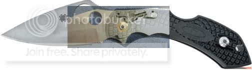

- Taken the profile of the Dragonfly 2 and scaled it to the size of the Delica 4 (7 inches OAL).
- Printed and cut out a wooden template to get the right scale and feel of the knife.
- Overlayed the existing caged-ball lock onto the existing image (see below).
Engineering/Design Questions:
- What design tool(s) do you use to ensure that your blade fits into the handle?
- What design tool(s) do you use during design to ensure a proper pivot?
- Any tool(s) or advice on how to design the tang/scale the locking mechanism?
- Is this a fools errand to pursue? If so, why?
