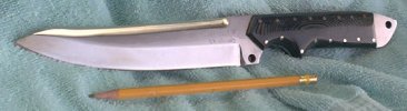

Knife A
Modified Clip point fighter. Made with 1/4" O1 tool steel Linen micarta handle scales, flat grind, 6 1/2" blade 12" OAL

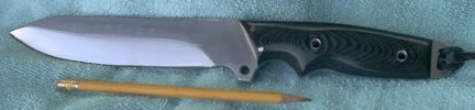

Knife B
Tanto style fighter made with 1/4" O1 tool steel. Linen Micarta handle, 6 1/4" blade 11 3/4" OAL. Flat grind

All three of these are beautiful pieces, but for me, Knife C just struck me. The modified clip point gives the blade the belly to do some severe damage while the convex top edge looks and probably functions extremely well. I think for this sort of speciality design, a steel like ATS-34 would do just fine...after all, if you're concerned about edge holding in a dedicated fighter, you have inflicted a good deal more violence than necessary to disable an attacker.
As far as what I would change...hmm...since it IS a fighter, I would maintain the sharpened back edge. I think it might be worthwhile to cover more of the tang with scale material...as to assure a more secure grip.

That modified clip point is my favorite of the designs shown. I like clip points on fighters. My next favorite would be the spear point. I also like a traditional tanto, but not the modified one.
BTW, my choice is A.

I was torn between the "B" and the "C". The "B" is one damn sexy knife, but the "C" looks more the "Work Horse" and Fighter of the two.

I like the blade and exposed butt of C, but with the handle off of A, the double edge blade just screams fighter to me though. I would look at D2 for steel. You may want to look into a rougher handle material, like bead blasted canvas micarta, to add grip. Not sure how the texture of your linen micarta is.
I'll take the clip point, but I want a sharpened clip. Not a full double edge, but a sharpened clip for back cutting. And I want a handle like B but with a bit more curve. I am taking a liking to handles that work well for natural grip as well as an edge in reverse grip. Single Finger Grips (like A) get in the way of edge in gripping.

I'm a sucker for tantos, so my choice is B. I like the simplicity of the tanto blade as well as its ability to poke (love the pic. of the tanto through the sheet metal). However, I think a slightly more ergonomic handle would make it more appealing.

Knife C is probably the best design for a fighter, but knife A really does it for me.
I know it has nothing to do with performance, but the less pins in the handle the better looking I think the knife is, IMHO.
