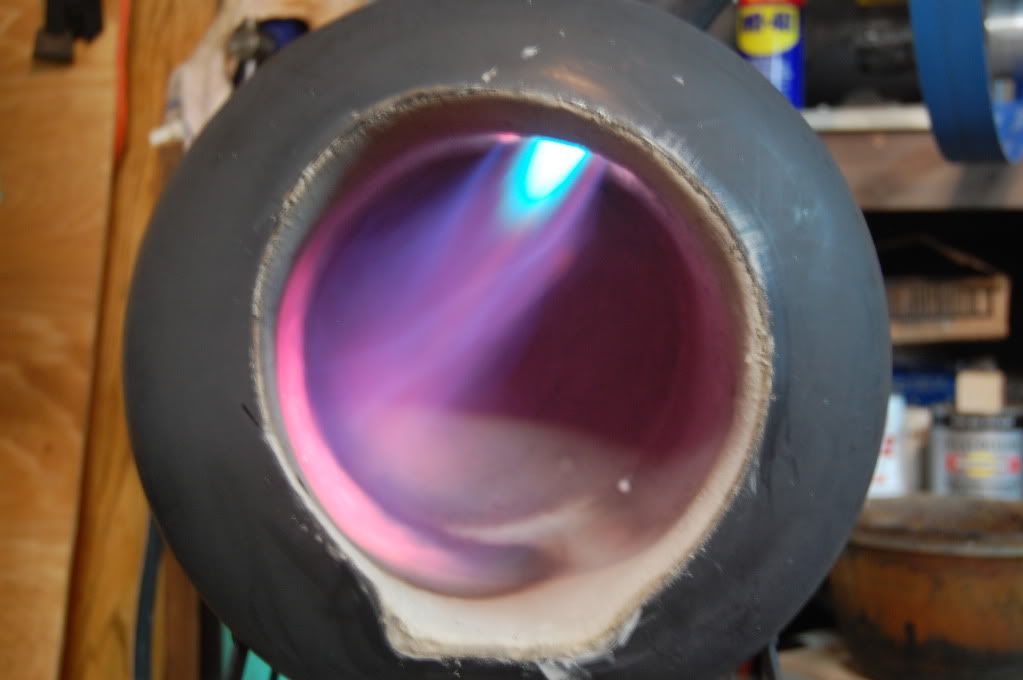

Here is mine I just finished. 2 1-inch layers of kaowool, topped with satanite then ITC-100. I'd say to make sure you get the satanite about 1/4" thick on the bottom and where the flames blast the side. I wish I would have gotten a bit more of a tangent on my burner, but it still swirls real good. You can see in this first pic how it looks after about 30sec of burning. Once I closed up the front with bricks, it really swirls inside and gets HOT. The 2nd pic shows how it is now with the bricks closing it off. The only thing I could have done better is to make sure the front face cut is a bit more flat so the vertical bricks match the face better. My left vertical brick has a tiny metal shim under the front of it to tilt it back and better seal up the left opening face. I bought a burner from Rex at hybridburners and I run it at 2.5psi only:

If you look through the forge, you can faintly see the rear opening. It's about 1.5"x3", large enough for a blade tip to slide through but small enough to prevent heat loss through the opening

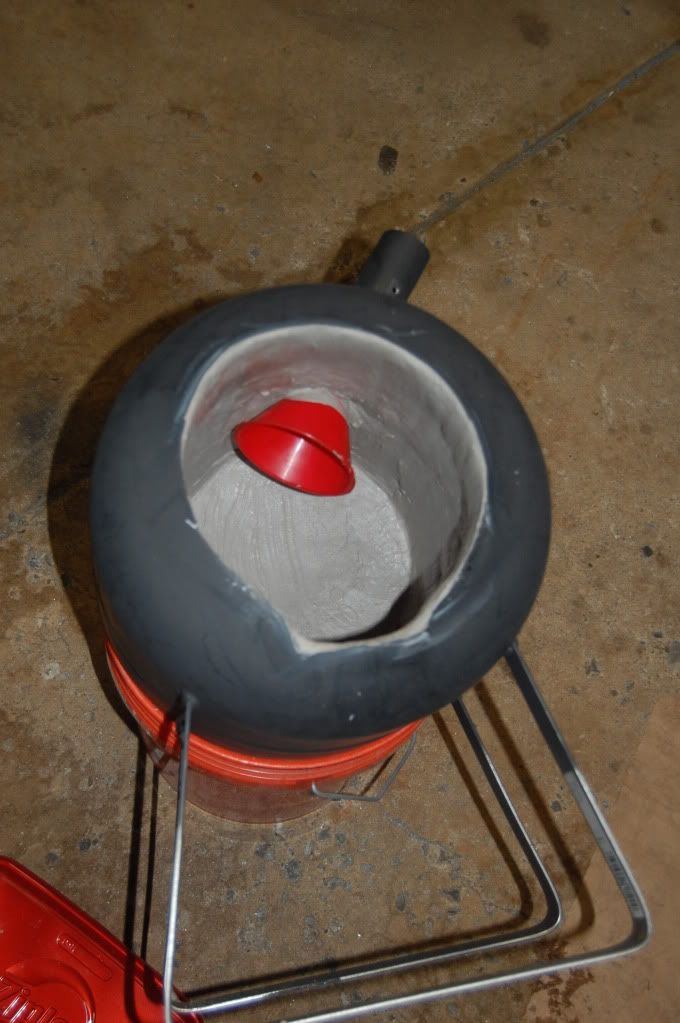

Another tip I read online is to use a cone shaped object to flare the kaowool/satanite at the burner opening. Here is mine when I put on the first coat:
