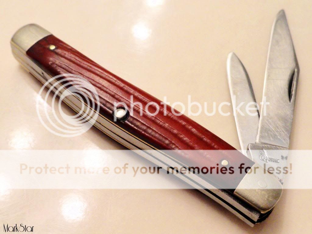

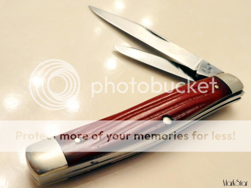

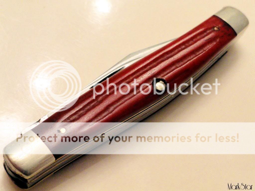

So I picked up this 1958-60 Queen here on the Exchange a few weeks ago with the intent to dye the scales red. I love red bone and yet seem to have given away any red bone knives I have had. That has now been remedied nicely. :thumbup:
What do you think?
I am happy with it. :)

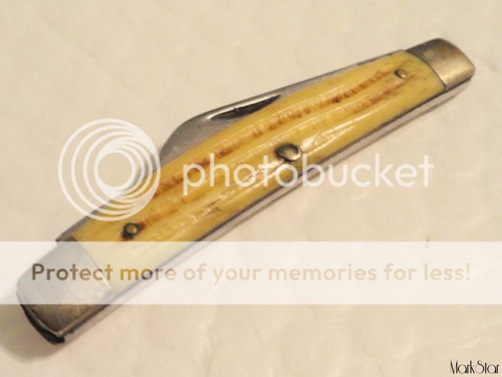

I have another old Queen that looks a bit like this one did, I'll post a picture of it shortly. :thumbup:
Edited to add:
This older Queen gives you an idea what the knife looked like before. It actually had none of the brown left in the grooves at all...
hmmm -looks good alright but is that the same knife?
or is it like those weight loss pics where they get the worst most dregged out looking pic next to one with new clothes, make up standing up straight and sucking the gut in?:D
Not the same knife... LOL...
As stated above, that is another older Queen that I have, but it gives an idea what the scales looked like.

Pretty much just simmered it on the stove in water/dye for about 30min.
There is an excellent tutorial that I (sort of) followed. I will edit in the link when I get to my computer.
Here it is: Dyeing Bone: A Tutorial
No sanding and no sealant. Don't think sealant is needed with RIT Dye but if I had some Ren Wax or similar I am certain it would look even better. I am just not the Ren Wax type, more the wipe it on my jeens type... ;)

RIT Dye is a clothing dye more than a leather dye. Very old and common stuff here in the US. I grabbed mine at the local Walmart in the laundry detergent section. (Also grabbed a bottle of brown to dye a vest of which I didn't like the camo pattern.)
I used just enough water to cover the knife in the bottom of a saucepan and maybe an ounce or two of dye mixed in with a dash of salt.
