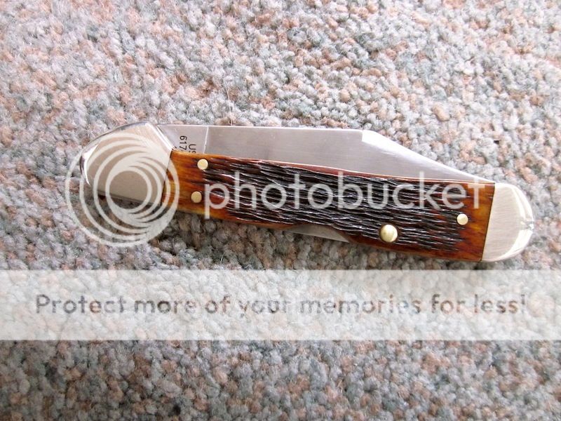

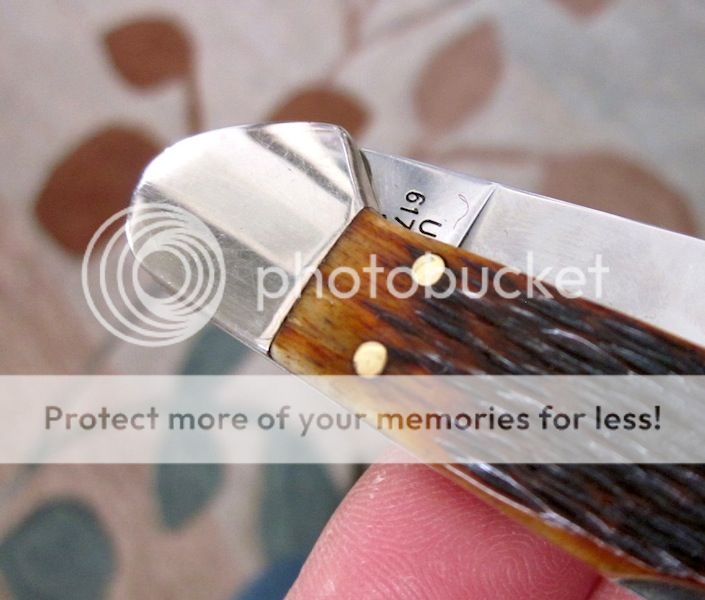

The sharp delineation between the darker and lighter areas on my Mini Copperlock has always bothered me, especially with the "ugly orange" streaks. I'd ordered it online before I learned how very different Case knives can look from their "stock" representations. Expecting something more subtle, like this...
0251a71f-a0a6-4e87-b3ee-b4ee726c20a5.png~original
... the orange was an especially bad surprise.

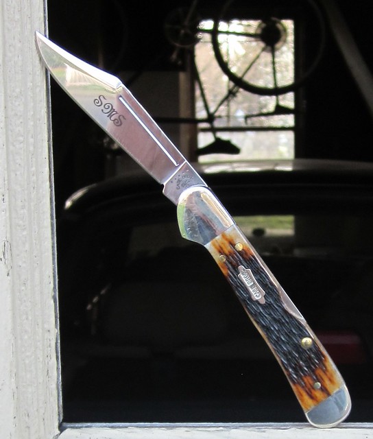

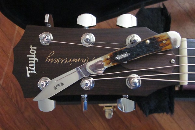

Son, just home from school yesterday afternoon: Are you making tea?
Me: No, cooking knives.
Son:
Before:
After:
IMG_4583.jpg~original
IMG_4580.jpg~original
Variegation intact:
IMG_4584.jpg~original
To my eyes, it's a welcome improvement. Ahhhhhh.

The sharp delineation between the darker and lighter areas on my Mini Copperlock has always bothered me, especially with the "ugly orange" streaks...the orange was an especially bad surprise.
Variegation intact:
That turned out really nice. Very warm tones and, like you said, lots of nice variegation. :thumbup
