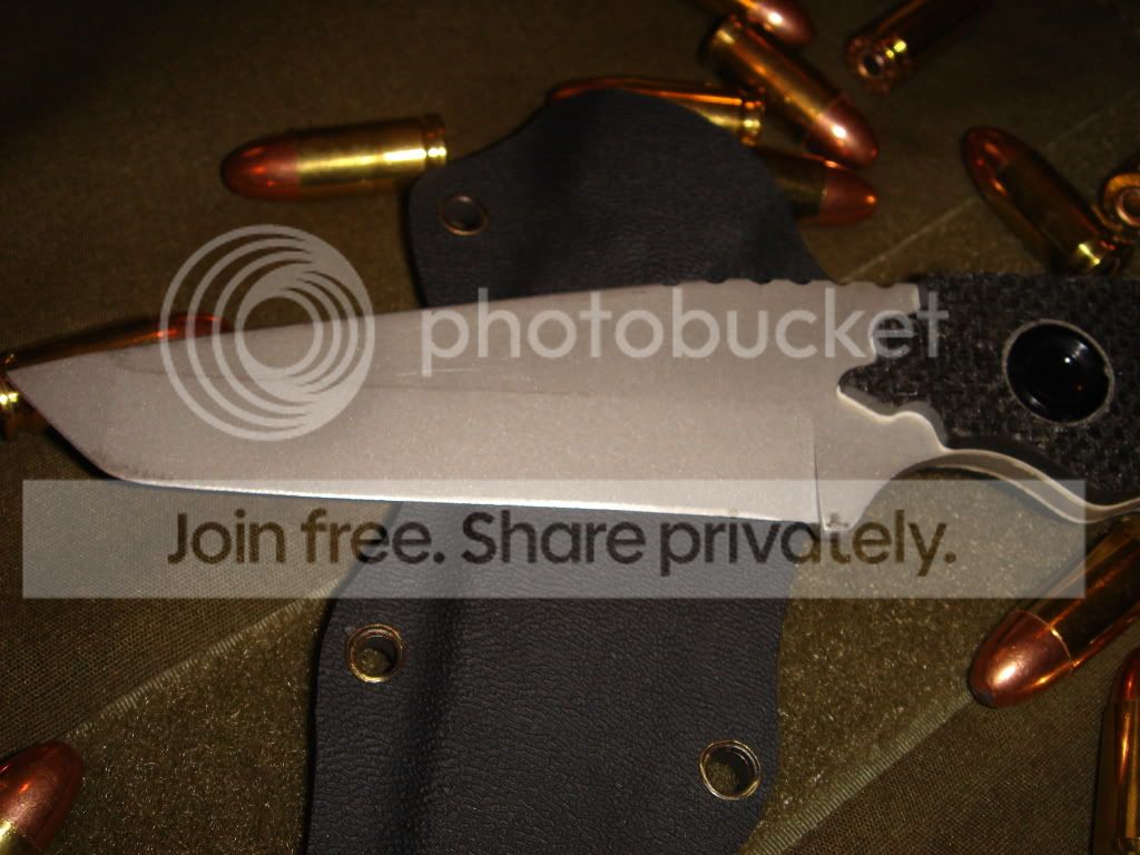

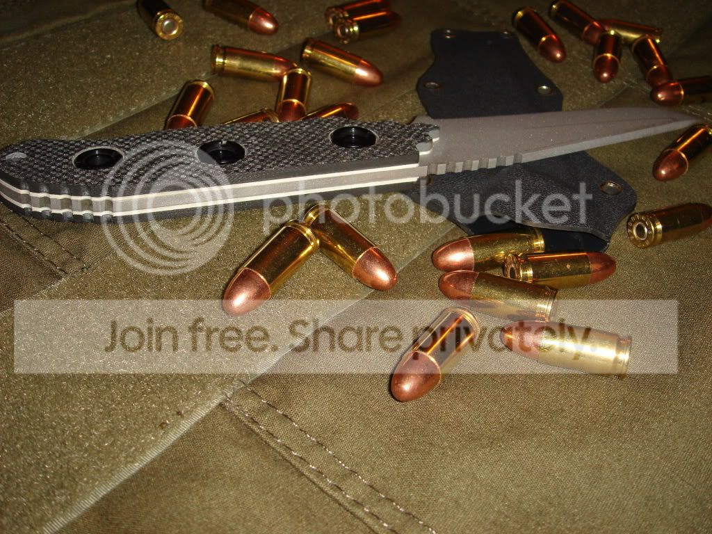

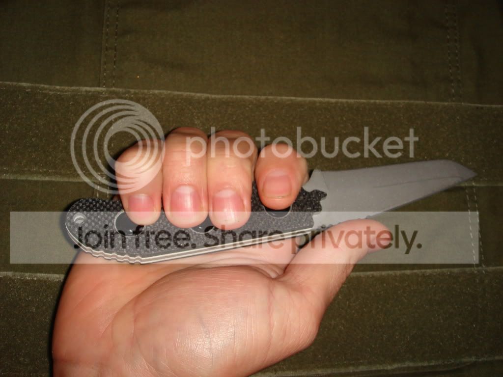

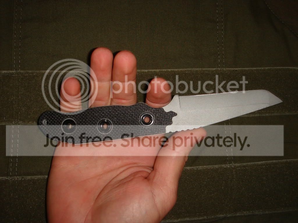

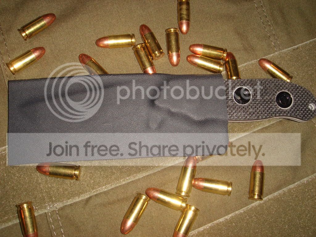

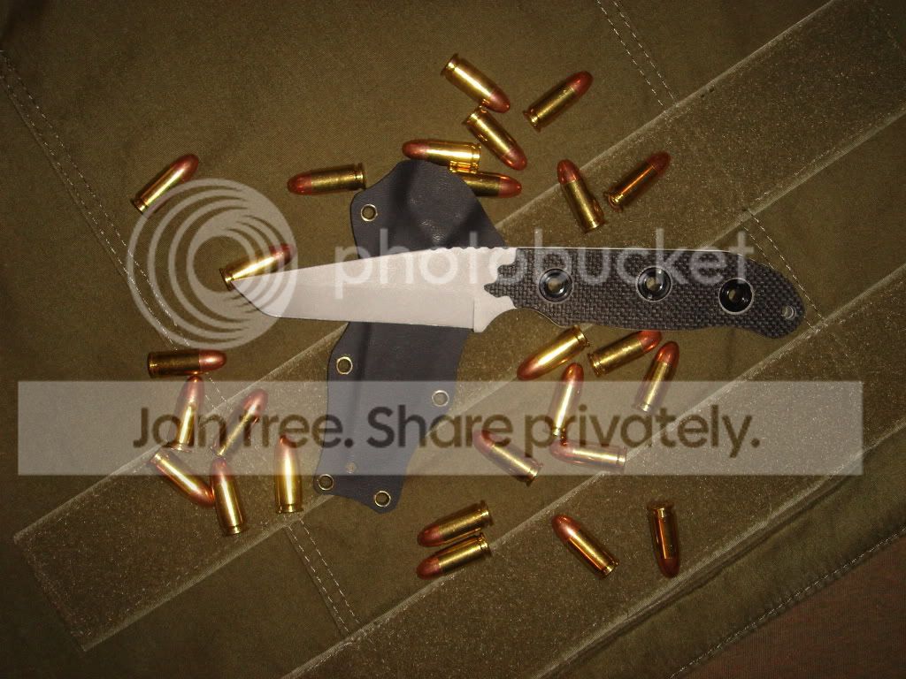

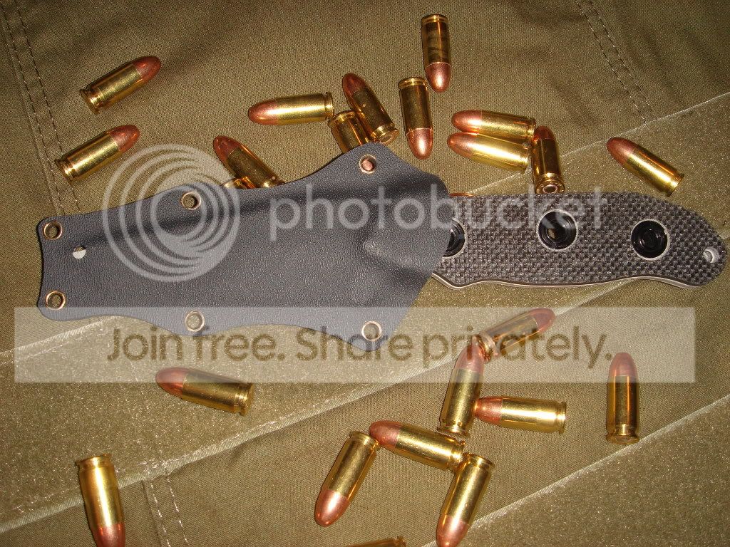

STILL HOT OFF THE BENCH, A TRUE CUSTOM, HAND FILLED 1/8 ATS 34, SABRE GRIND TANTO WITH BLAST FINISH. THUMB JIMPING FOR STANDARD OR REVERSE GRIP. HARDWARE, TEXTURED G10 SKINS AND WHITE LINERS WITH BLACK ANODIZED FASTENERS. CUSOM KYDEX.
wow it looks like knife making has bit you hard.it seems like i was just reading your 1st knife post and now you are already posting up pics of this one.nice work.clint.

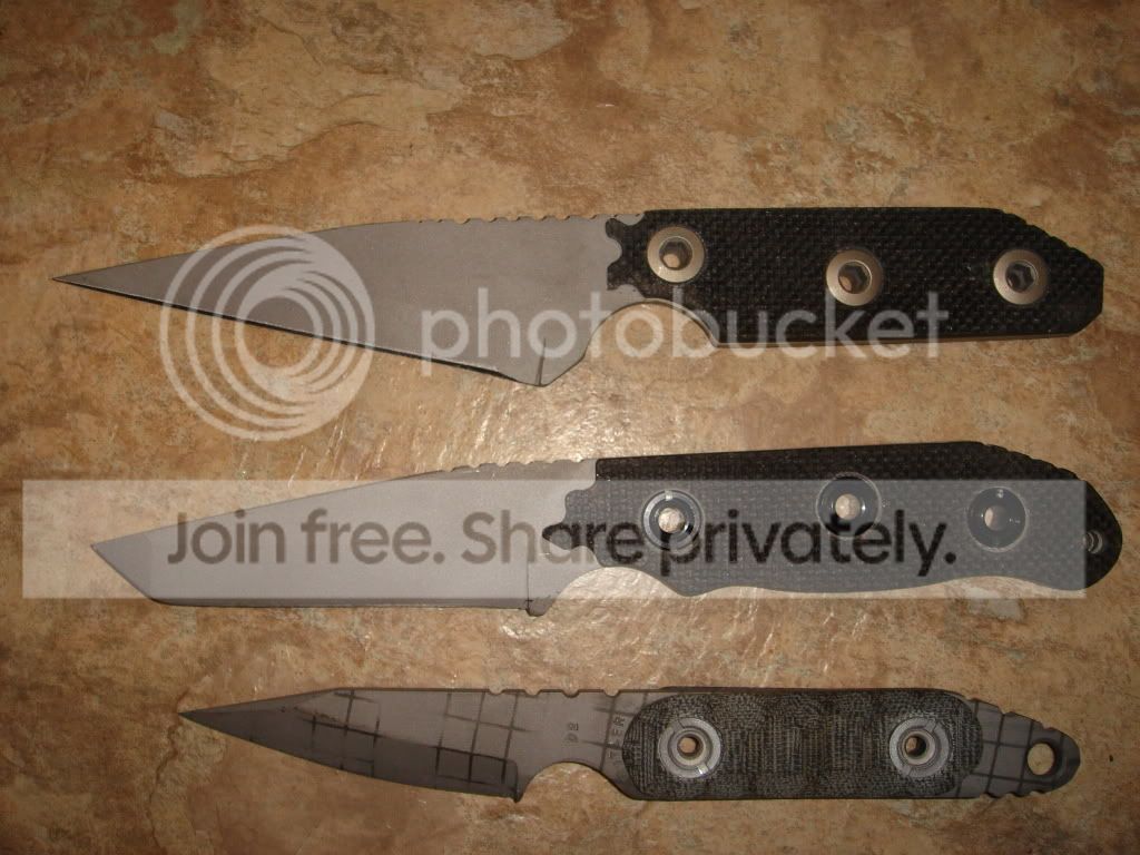

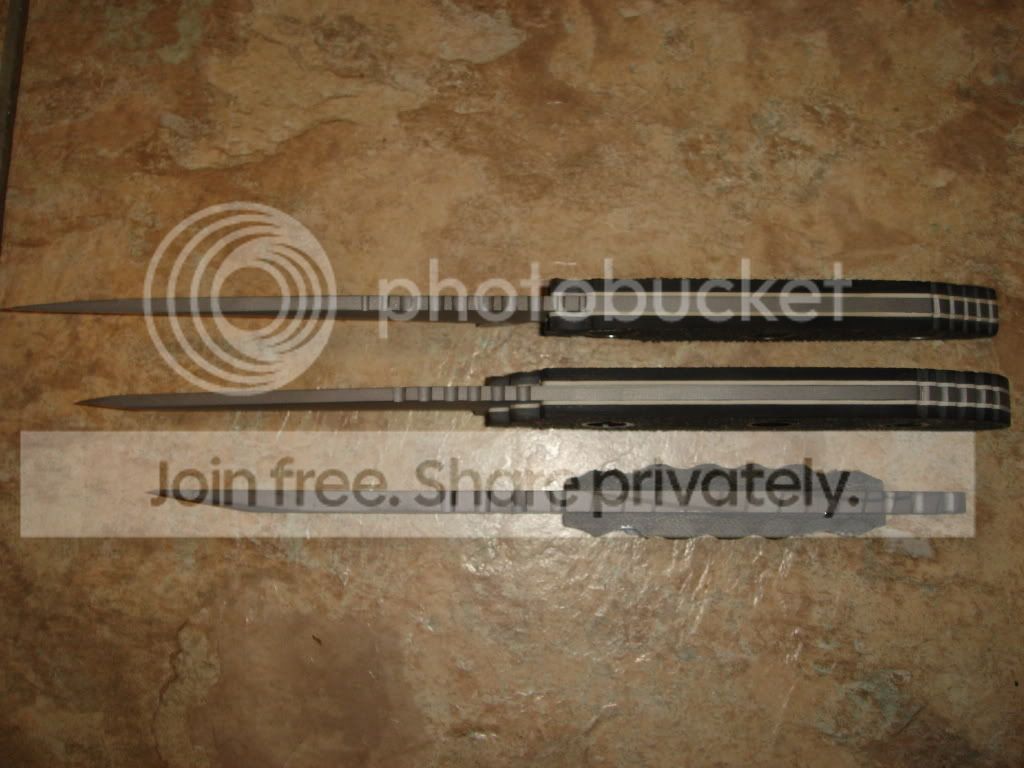

Had to hit the grind again today! Here are the results. check out the test blast on the small chisel grind knife! Sweet!
Those are pretty cool man.

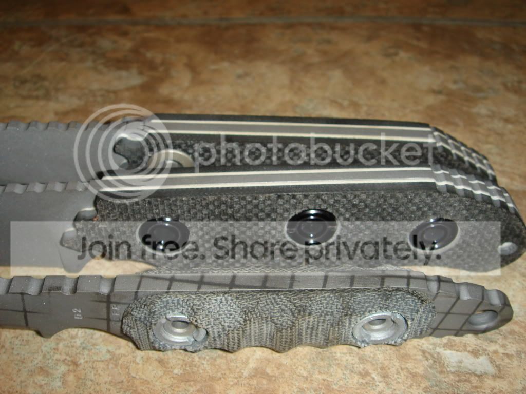

The "test blast" what is that, and is that what left the lines on the bottom one? They look kind of cool, is that something that will stay with the knife or do you have further finishing to do?
-steve
It is a final finish Im experimenting with. yes it is permanent and will not scratch or wear off. It can only be removed by sand blasting. That little knife is my "lab rat" for all my ideas and by the looks of things it has been victimized once more. What a perfect name "Lab Rat". Im going to run with that one!
that is an awsome idea for the chain ring bolt fasteners.i have a garage full of them and would have never thought of that in a million years.
