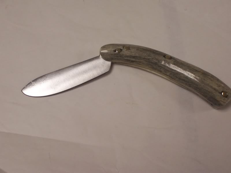

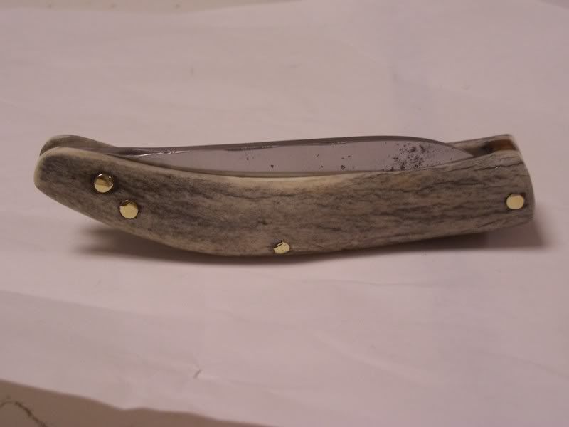

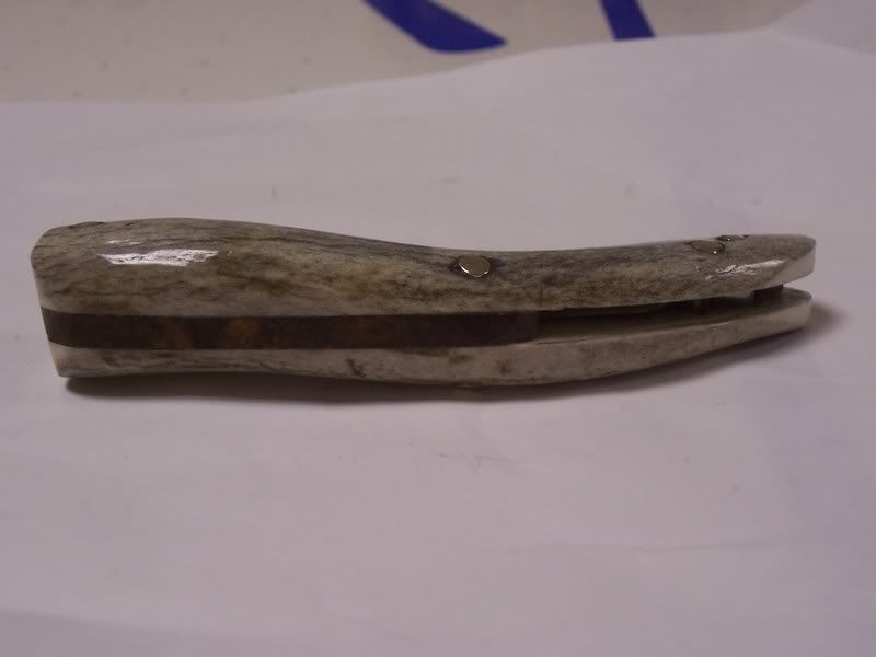

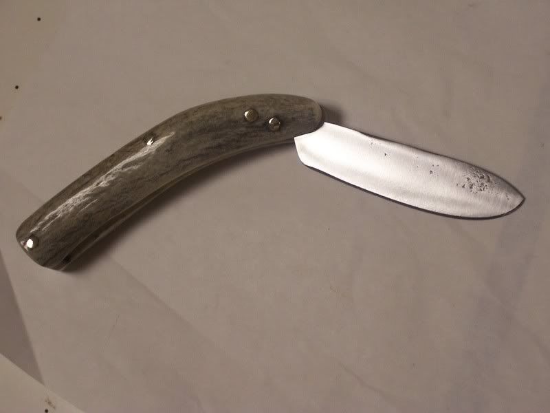

Well, I got my first friction folder done. I found several design flaws, but put it together anyhow. Forged from 3/8" round stock 0-1, the blade is just under 3" long.
Looks pretty good. I take it you used a brass pin for a stop pin like in a linner lock?
