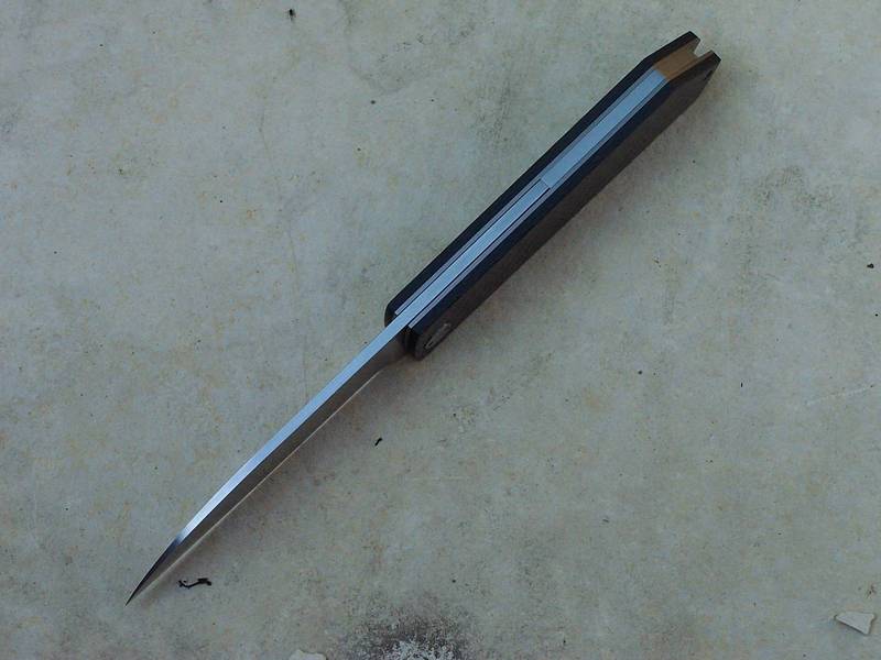

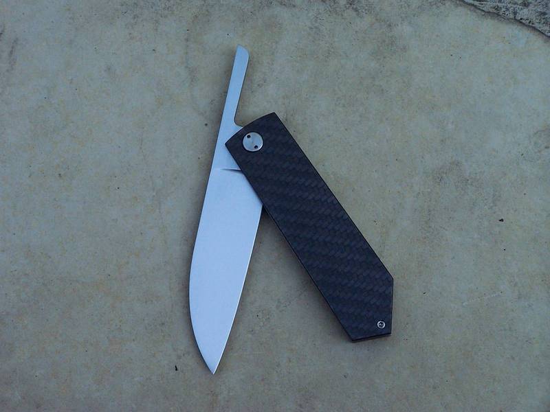

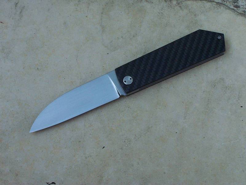

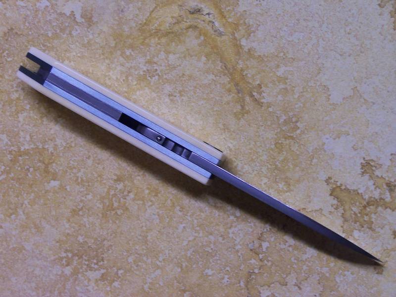

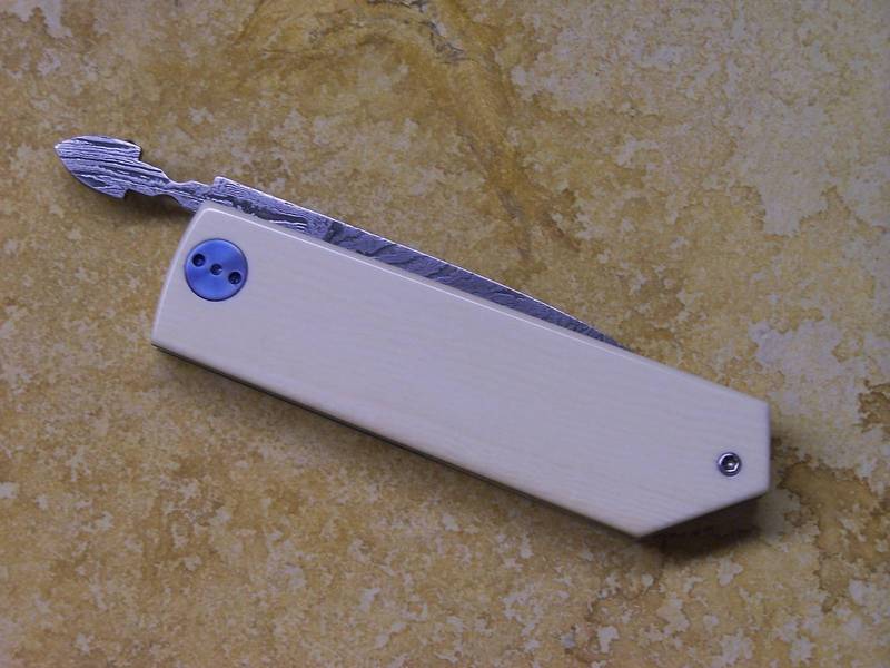

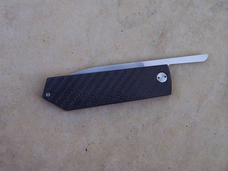

I have built once more an original folder, this time in carbon, specially level and easily.
Weight: 58 grammes
Blade: Nilox 83 mm long
Blade backs: becomes rejuvenated from 2.8 mm on nearly 0 mm, nastily sharp and sharply
Clutch bowls: Carbon 2.5 mm
Boards: Titan feather-hard 1 mm
The folder is divisible, as usual.
Outstanding!
Every Knut needs one Frickie in the collection.
Is the pommel too pointy or does it have a purpose?
To whom the thorn is too long thus or sharp, no problem, the part can be also made shorter and more around.
Also I could imagine that one can still make additional tools out of this part. I think there of an awl, scalpel, screwdriver, bottle-opener or also completely something else.
Thanks Steffen! I like your design. I was just curious about the pommel.
