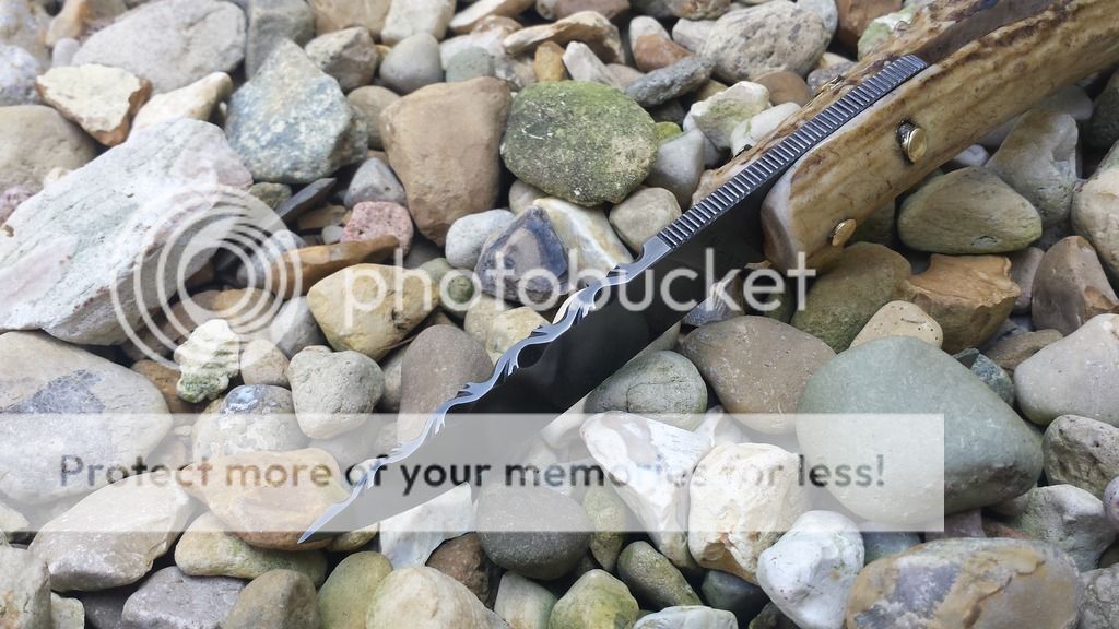

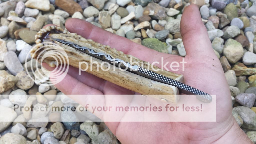

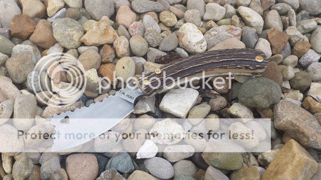

This first one I just let my hands, materials, and mind make what it wanted to make. Evidently, they all wanted to make a folding straight razor, cleaver lookin thingy. :-)

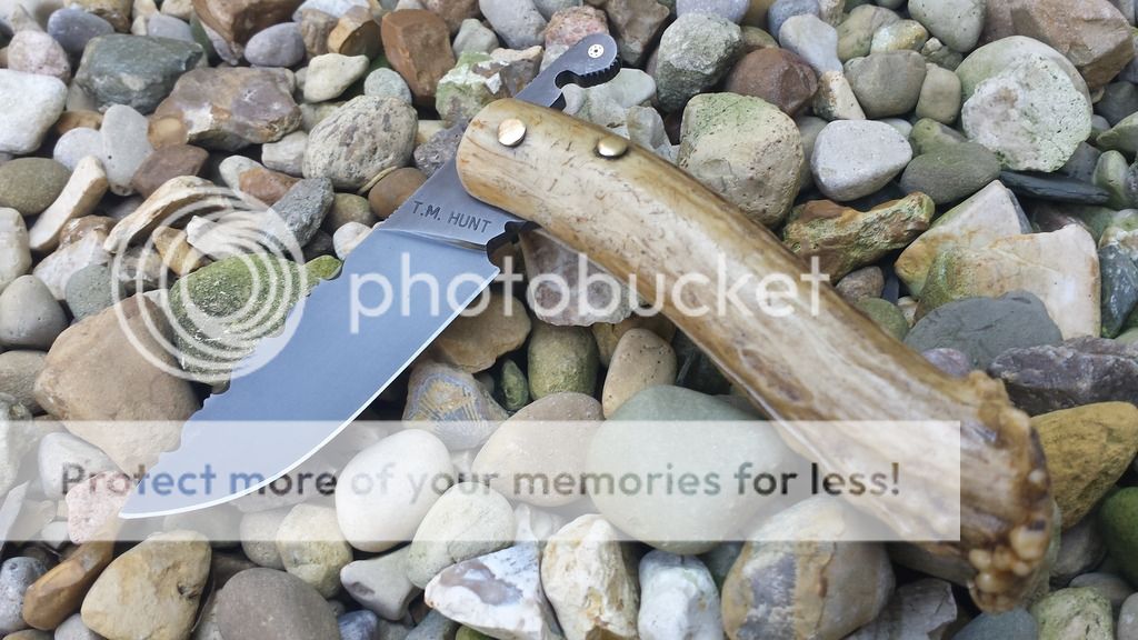

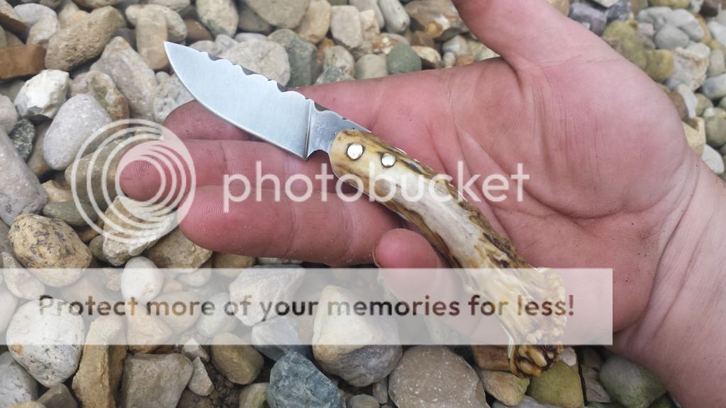

My new little EDC

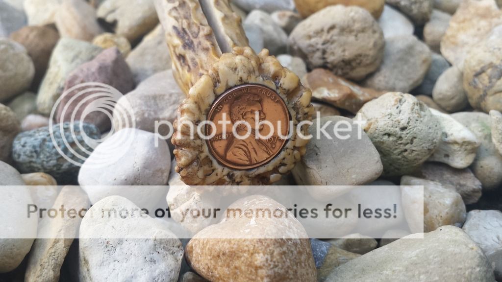

A 1974 penny calls the back of this little booger its home..... The year I was born.

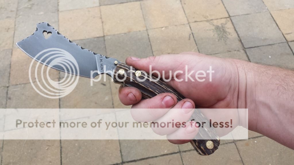

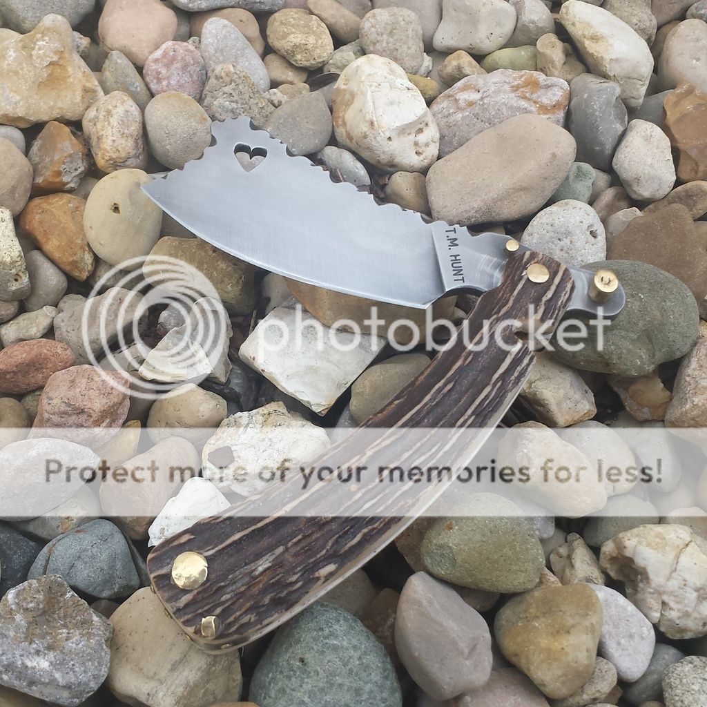

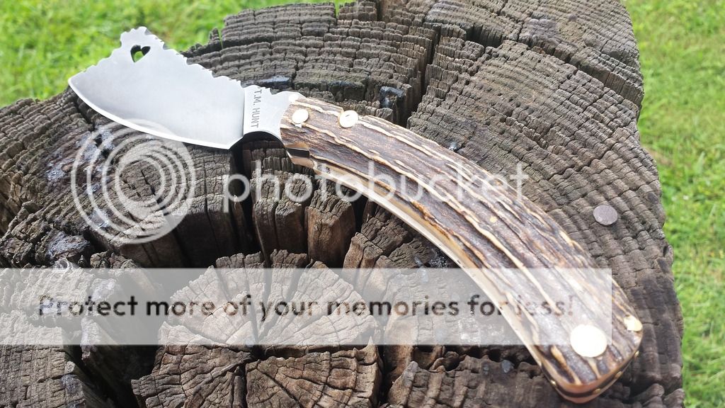

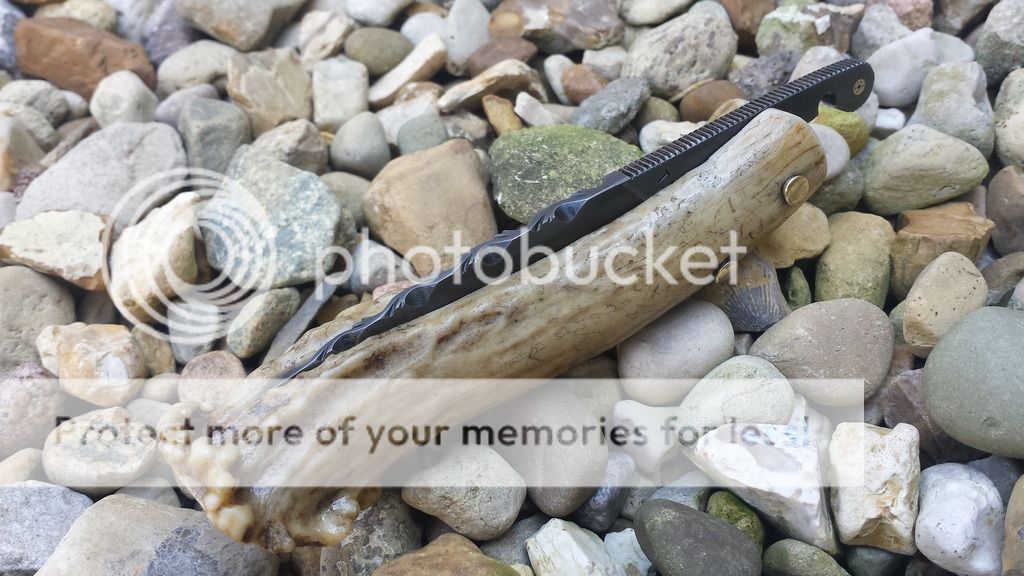

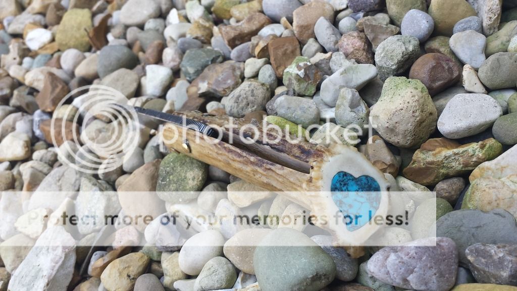

This one I finished up today.
The turquoise heart inlay is a classy touch I think.
File work cover every inch of the blade that doesn't have a edge on it.

Eta: the blade profile of your antler edc is just darn perfect. Love it!

Gorgeous pieces, Todd. I really like the file work on the larger folder.

Thanks guys, its really kinda a full circle thing for me, I've tried and failed several times years ago making folders, and to see them coming out like this has me super excited. Not that friction folders are highly complicated, but since there all made from natural materials that dictate the design, none of them are the same so I'm learning a lot with each one. The last one I made with the turquoise heart inlay functions flawlessly. I made and installed .005 shims that go inside of it that eliminates the friction marks on the side of the blade, and I cam shaped the back stop and it clicks solidly open and locks into place. No closing this one on your finger......

Todd, I love the bigger one with the checkering file jimping all across the spine!
