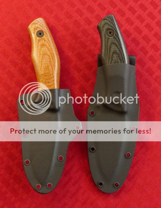

Be aware the horizontal sheath has very high retention. You can't remove the knife by pulling straight back, you have to tilt it up at the same time. See video. If you want something that's easy to get in and out of you should choose the vertical pouch sheath.
Tell me what scale option you choose and I'll build it. There are fifteen knives available in this sale. The knives in the picture are not the knives you will receive. I'm sharpening now and they can ship next week.
We're milling the OD green and maroon Micarta now so it might take a little longer with those. We're no longer doing camo micarta, sorry that picture is out of date.
