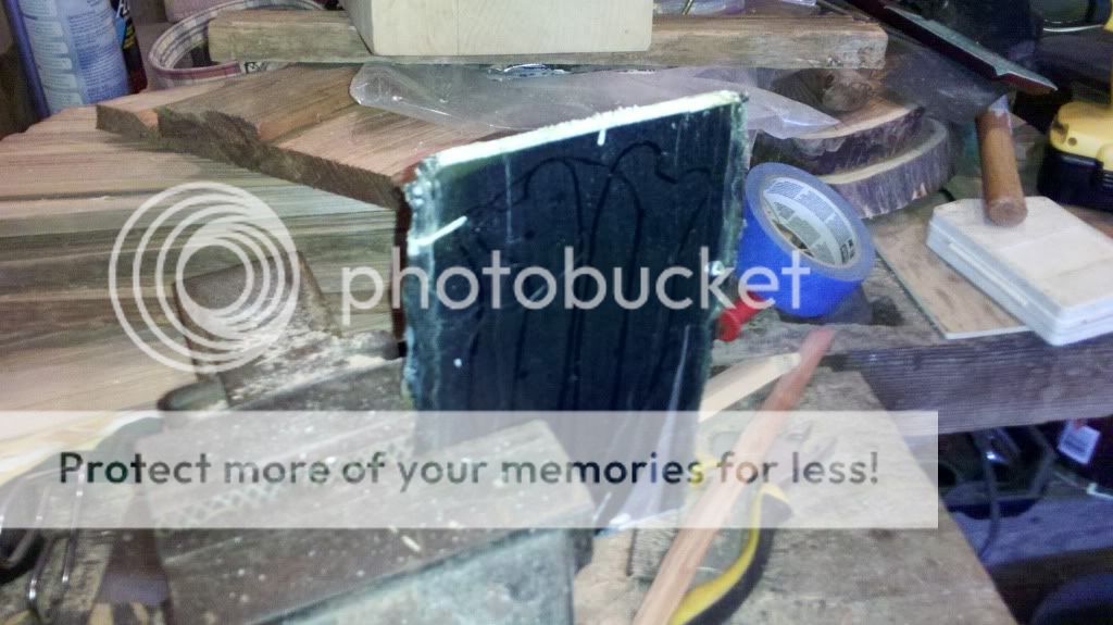

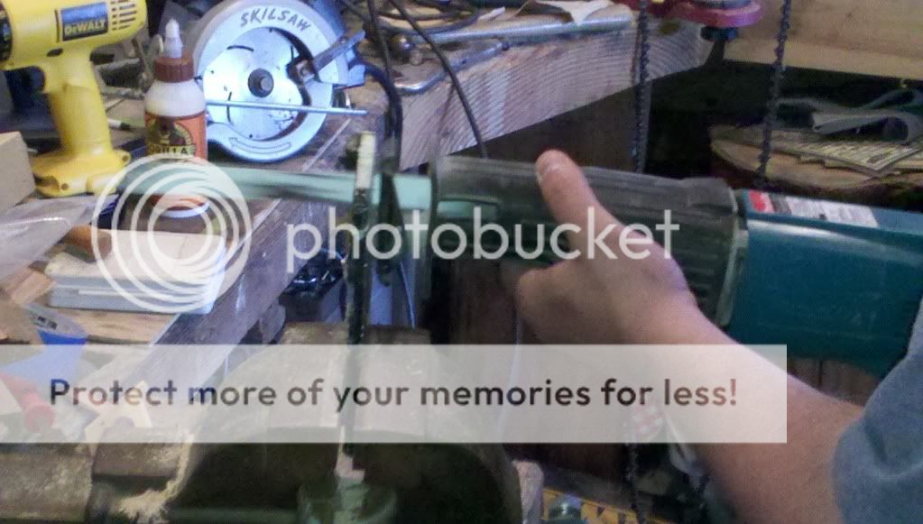

Well, gave home made micarta a try. So, after cutting some cloth and getting some fiberglass reisin, I started with an alternating pattern of blue jeans and OD green cloth from an old issue laundry bag.
After the initial few cuts with a saw, the fact that you can always cut more off, but can't add it back rings true.

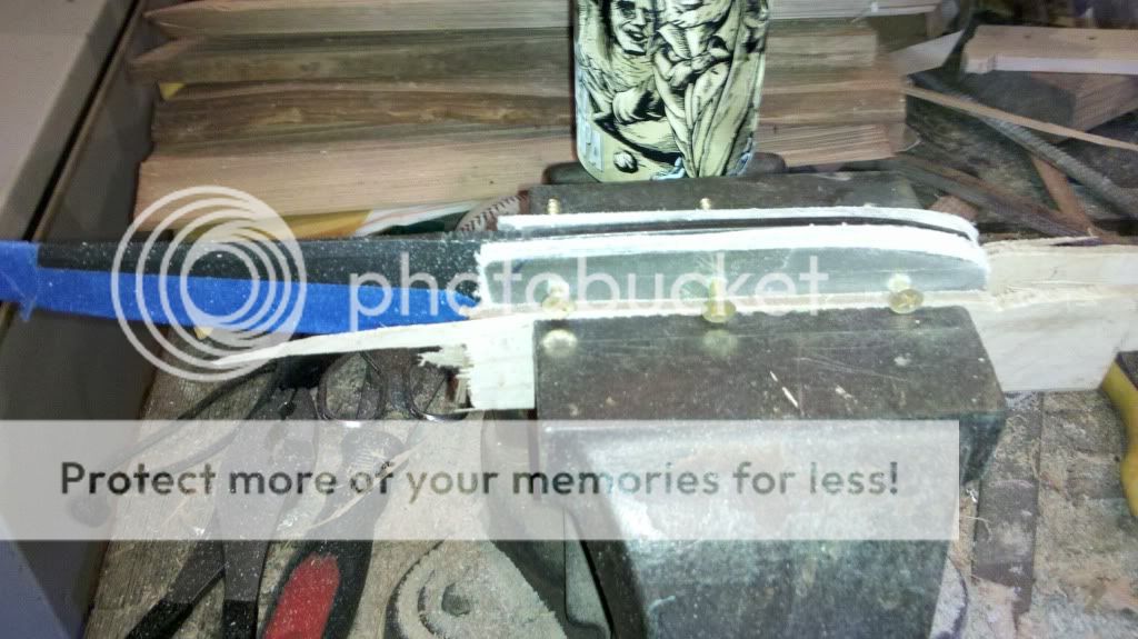

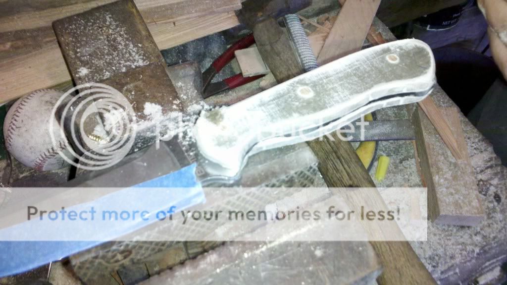

Rouch cut with the brass screws in, holding the handles tight, we started to work down the handle.
After working the micarta down a bit, we cut the ends of the screws and used a ball-peen hammer to mushroom the edges.

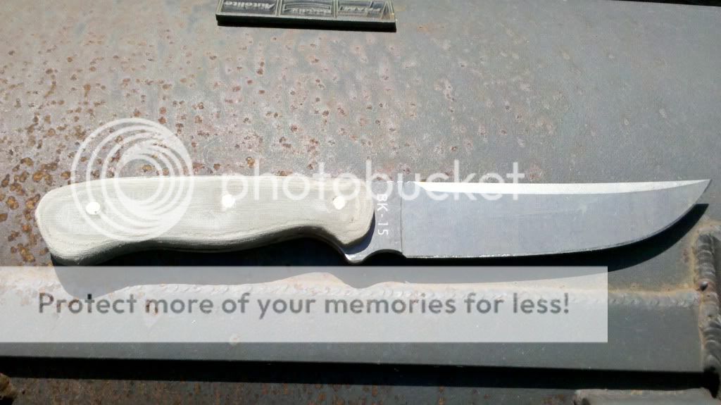

Here is the result after sanding down to 80 on a HF 1 x 30, then finishing off with 250 on a sanding block.

Looks good so far. I find polished micarta to not have enough grip. But thats just me

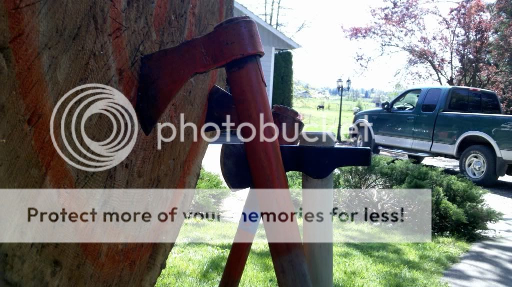

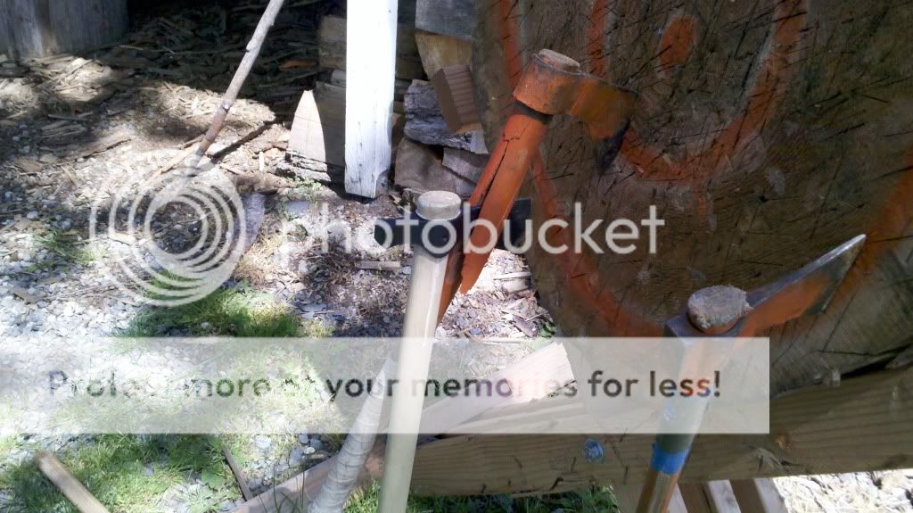

Afterwards, we started practicing tomahawk throwing (prepping for next years gathering) and Awesome-o realized that his new CS Trailhawk hates his other hawks'.
Then we started messing around with some Gil Hibbon throwers. Then shit got retarded............... we had an idea to reenact the movie "Krull" by bolting the afore mentioned knives together.
Yes it works. Yes................it's definatly sketchy/risky.
I hear ya.
I preffer the roughed up micarta myself. More grippy.
Those scales are top notch. Nice work man!!

We used to play a game when we threw hawks, called "handles". The priciple was if you split your buds handle you win. :D
Its hard not to hit someones handle.
