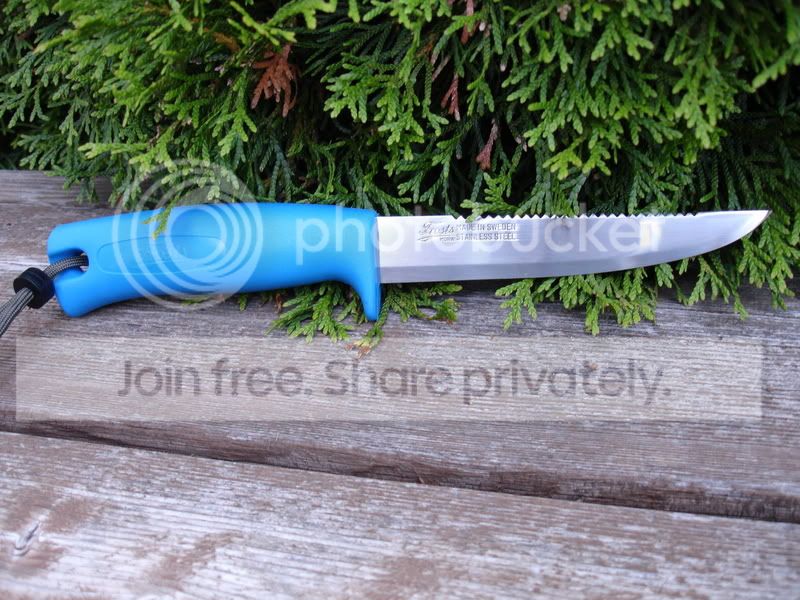

Well, the scaler isn't a saw, but maybe with a file and and some elbow grease, if could become one.
I've thought about trying that, actually. I just haven't found the time.
I've sharpened saws by hand. It's tedius but not difficult - if you know what you're doing. It might be possible to turn your knife into a saw yourself. Get a three corner file and a saw set. Make a frame to hold the blade. Measure out your saw teeth at, say 8 or 5 teeth per inch. Cut triangle notches with the file. Set the teeth. 5 1/2 TPI is usually sharpened for a rip saw. But sharpen this for a cross cut. A cross cut saw is better in the woods.
I don't know if the steel would cooperate. I've never handled a Mora. But it's worth a try.
I'm sure there are books that will tell you how to do this, with pictures. I wouldn't know. I learned from my father.
