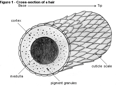

The hair is .0012" thick
The outer layer of hair is composed of overlapping cuticular scales, move your blade from the tip toward the base. If you aren't whittling the hair, try flipping it around.
Oh so that's how it looks. I know that it's easier to whittle hair one way and takes a sharper knife to whittle both ways. I was thinking it was because the hair was tapering and it's finer in the other end. Now I know why. :)
