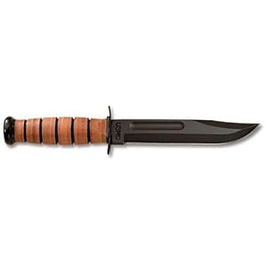

You could also go with one of the KA-BAR USMC knives full blade (7") , short blade (5.25"), these knifes can easily be reporfiled to scandi and cost less than $50.00
Scandi Short KaBar USMC knife
