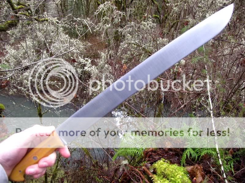

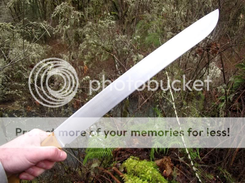

Not much too it, this is my latest machete, the quench through a hard drop into the blade.. which I actually ended up liking, so instead of fixing the forward curve, I let the steel do what it wanted and ended up with a pretty slick user.
The forward curve really lends itself to cutting thin whippy bush and what not that with a straight blade would bounce off the edge..
Specs-

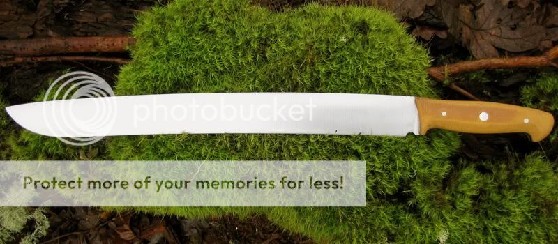

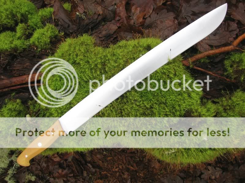

oal- 21"
blade length from handle- 16"
handle length from top of panels-5" The handle is pinned, glued, and permanently screwed into place.. to keep the panels from loosening through use.
blade width- 1.5"
blade thickness- .09"
grind is full convex to edge. The finish of the blade is scotchbrite satin, then rubbed down with a beeswax/oil mixture to waterproof the metal and micarta. Edge is polished to 3k grit, then stropped on my felt belt to a shaving sharpness.

Thank you, steel is 15n20, basically high nickle 1084-1095.. I use it a lot where blades in use might get rusty.. or stained, because the nickle helps out there a bit..

I got to swing this around the other day and was surprised at the performance advantages of the forward kick.. I was able to cut grass at a very slow swing speed, about half to a quarter speed of a normal swing, and could cut diagonal through inch and a half ash and maple saplings in a swing with a little luck :)
honestly making it I thought it would do more harm than good, but it sort of holds onto the branches, and makes the full agressive cut before the wood deflects off the blade.
the only thing I have really found it to be less suited for than a more traditional shape is for hard dry wood...
