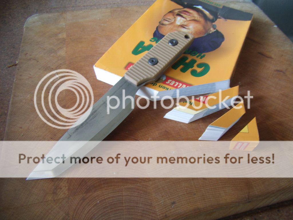

Currently busy making a knife out of a old piece of Sandvik M2 high speed steel machine saw (about 65-66 HRC) with the help of my Tormek T7 wet grinder.
Since i had a couple of old G10 grips from a Strider DB-L the overall shape was an easy choice, but in the process i added a little belly to the edge.
The main edge measures 22.5 degrees with a mini-bevel, while the slanted portion measures 25 degrees inclusive with a zero edge.

A follow-up took some time, but here it is.
After some cutting tests with this M2 knife i arrived at a measured edge angle between 22.5 and 25 degrees inclusive, as this seems to be right at the balance point between as thin as possible, yet thick enough.
This edge survives multiple full force cuts into my wooden testblock (a piece of laminated desktop) without chipping or noticeable loss of sharpness.
Afterwards the knife could also still pushcut through this paperback.
