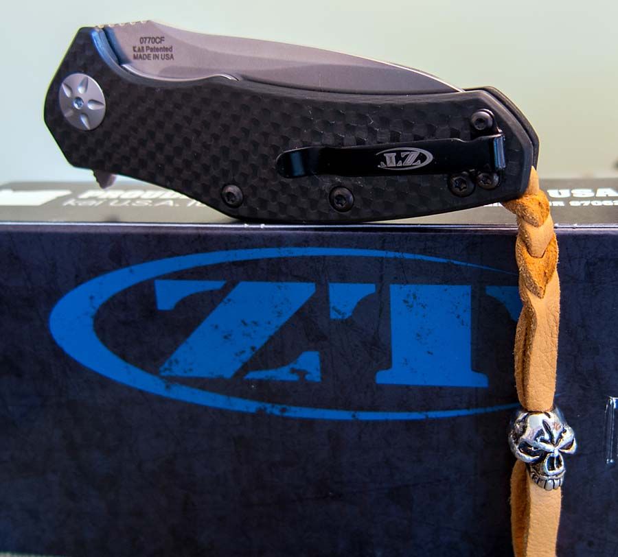

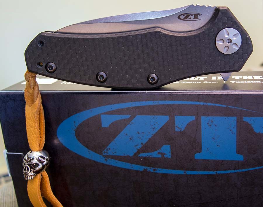

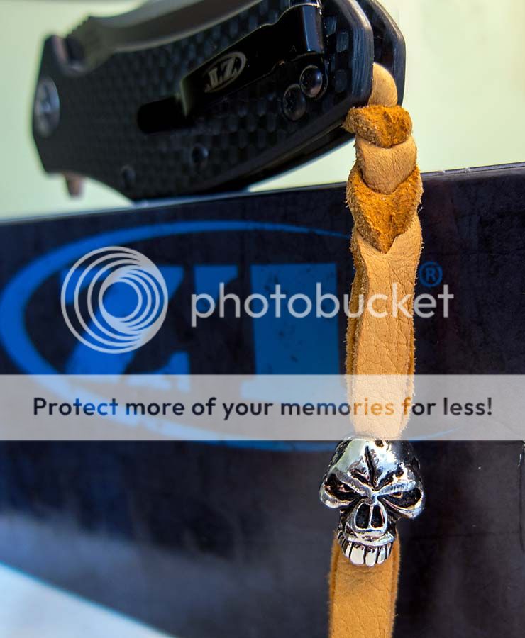

Thanks Jim, a good friend on the forums, Raj, thanks again Raj :), gifted one to me and it landed yesterday, love it a lot and seeing your test helps reinforce that feeling :) I took some photos of my knife, hope you don't mind me adding to your thread, instead of starting a new one. Keep things together about the same knife.

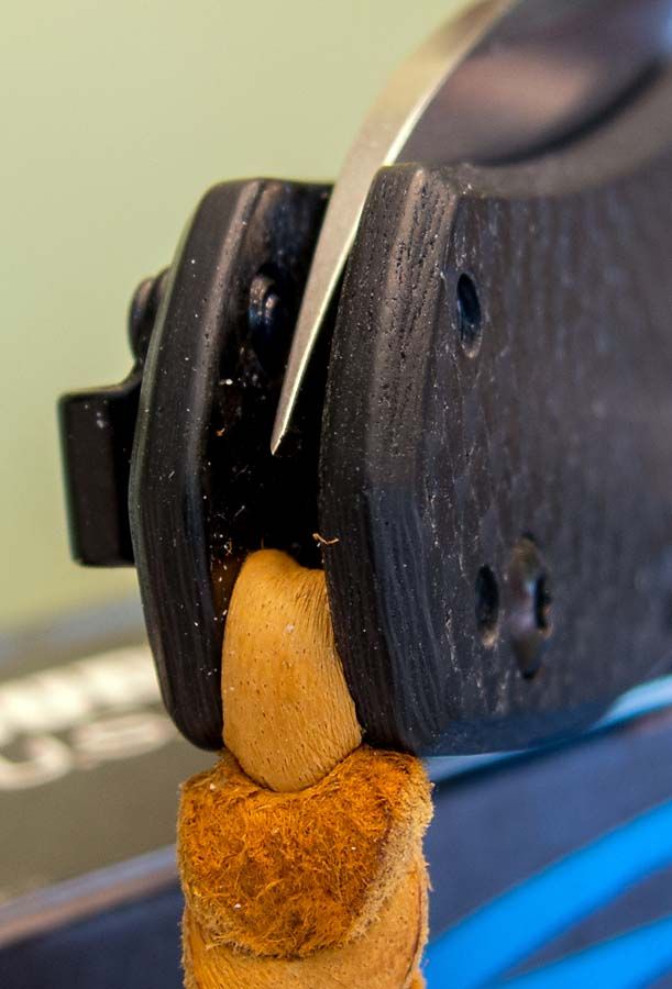

Reason for the photos is to show that you can add a lanyard fob to the knife, even though it doesn't have a lanyard hole. There is an exposed pin at the end of the handle, in order to attach a lanyard to it you need to braid it VERY tightly around that pin. I folded the leather over and made slits into it close to the end of the fold so that it would be very tight when I went to braid it and it worked out well.

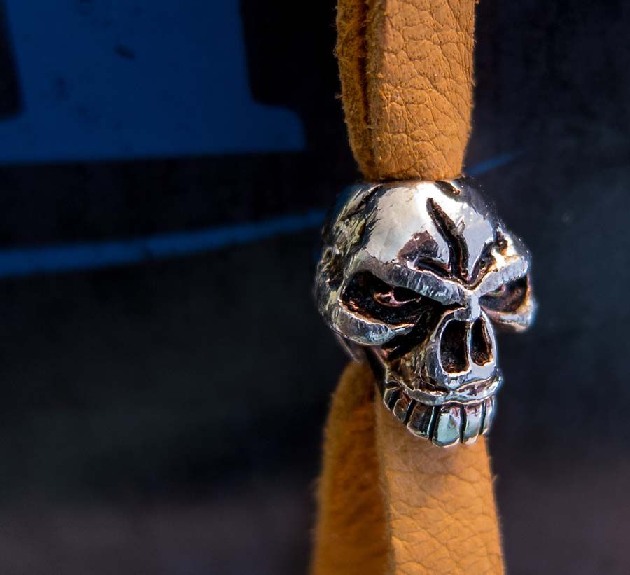

The skull bead is held in place by way of a wedge of rubberized cork, nestled between the two pieces of leather and then the skull is pulled down tight over that, it prevents the skull from sliding off. A much cleaner way of keeping it in place instead of tying a knot there.

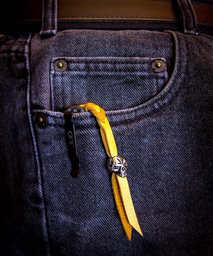

Here are the photos, with the lanyard on, I can hook my pinky around the leather and catch the bead and draw the knife from the pocket, plus the skull is kinda cool, not into skulls really but they work well for this purpose.
Tight around that pin

770cf_braid.jpg~original
the skull had a more copper look to it but that's since started flaking off :( but still has some neat details within
770cf_braid_skull.jpg~original
edited to add a shot of in pocket;

Thanks Jim, the more I look and think about that pin, I have a feeling that was it's intended purpose, as it isn't part of the structural integrity of the knife, meaning it doesn't appear to be a point that is fastening/bolting the two scales together, it looks to be inset into holes of the scales. I just checked ZT's site but they make no mention of it...
G2
I think you are right. :)
Not right now at least it's tight plus the leather is a little wider so it keeps it on the back side of the handle, so as you can see in that photo you copied into your post, the leather braid has 'shoulders' that prevent the braided area from going down between the scales, and that will help keep it out of the path of the blade.
So you'll need to plan how wide you slice the leather before hand, so it's not too narrow and not too wide, Goldie Lock's style, just right ;)
G2

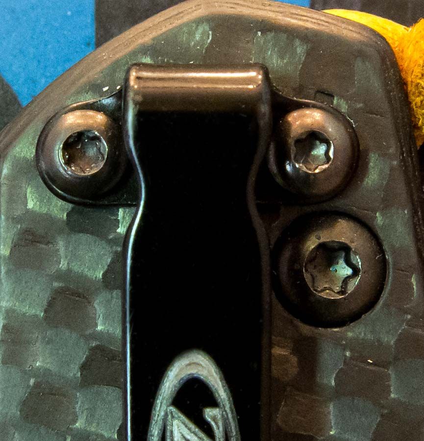

Jim, from what I can see in your photos, your clip looks to be made the same as mine, the indents/hourglass area seems to be off, it's not lined up where the actual screw heads are, like it wasn't bent at the correct spot?
If it was bent further up, the pocket clip would end up almost to the end of the knife, it's close enough but it seems strange to have areas for clearance but then to have them positioned where they are not needed, the placement of the screws it looks like you wouldn't need any at all, it all could be straight and a little stronger that way.
Here's a shot of mine, maybe others are different?
770cf_clip.jpg~original
G2
