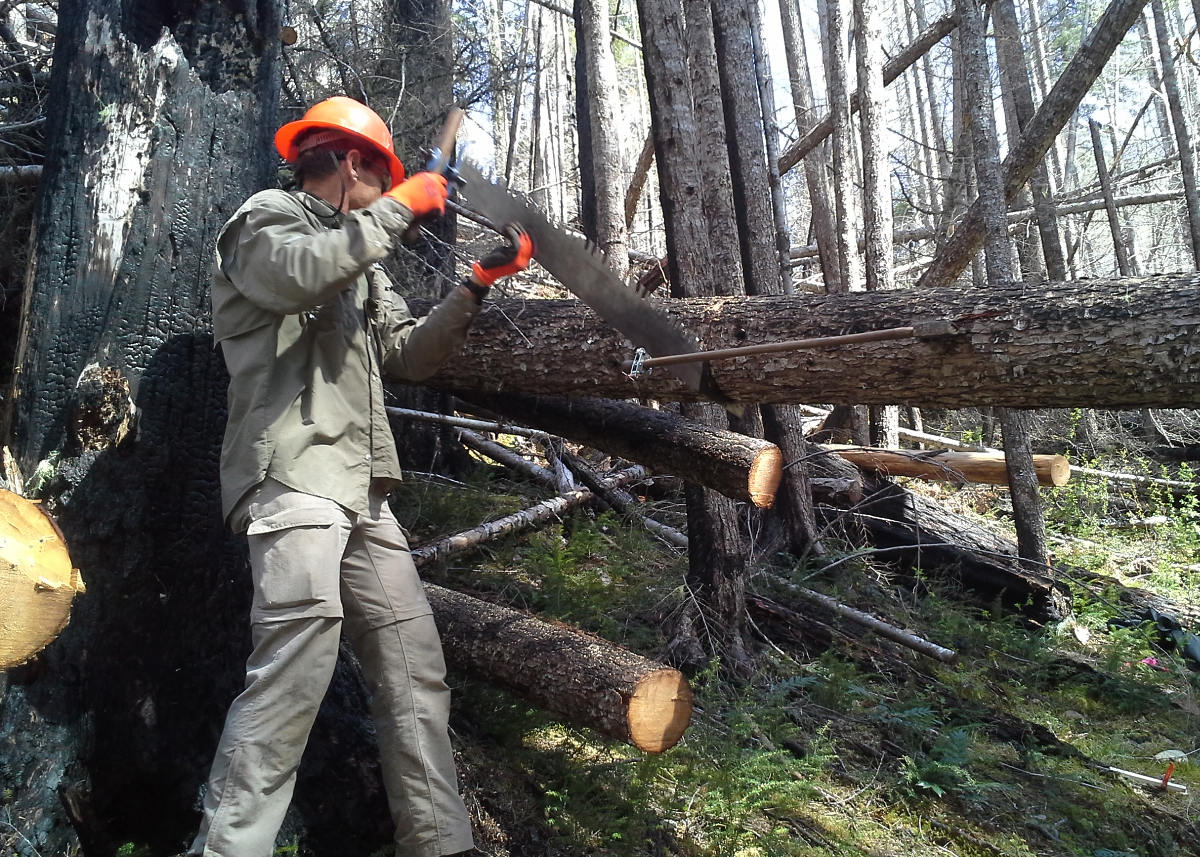

I'd be happy with a Michigan pattern. The rounded face is a little more forgiving of offcenter blows on a felling wedge. The bit can't be too wide nor the cheeks to thick just in order to stay down to 2-3/4 pounds while still giving adequate overall head size, say 7-1/4 x 3-3/4 or 4. The profile of that Kelly Perfect Woodcraft posted would be just about right.
This axe won't be super fast bucker. It's limited by its size and weight. But it's perfectly adequate for clearing small falls without the need of a saw. Even a boys axe is enough of a chopper to be adequate for trail work. This is just a bigger longer more powerful version of a boys axe that's long enough to underbuck.
