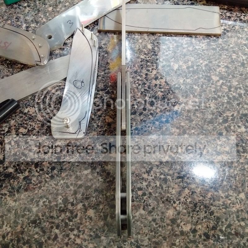

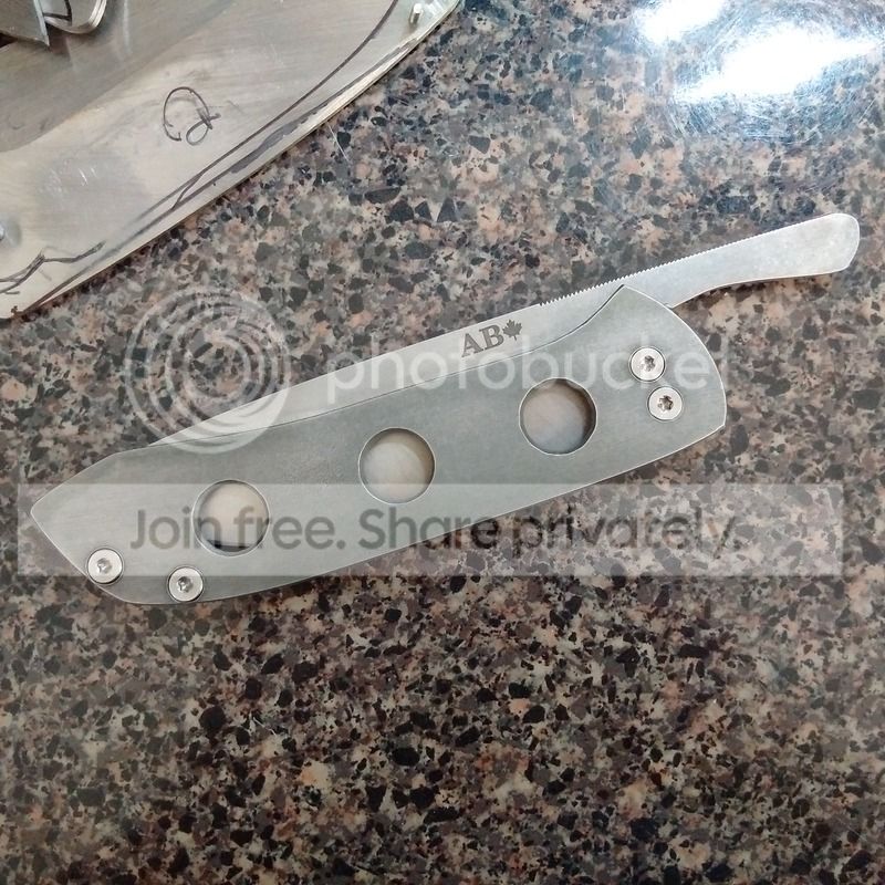

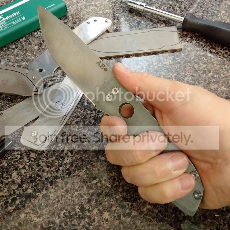

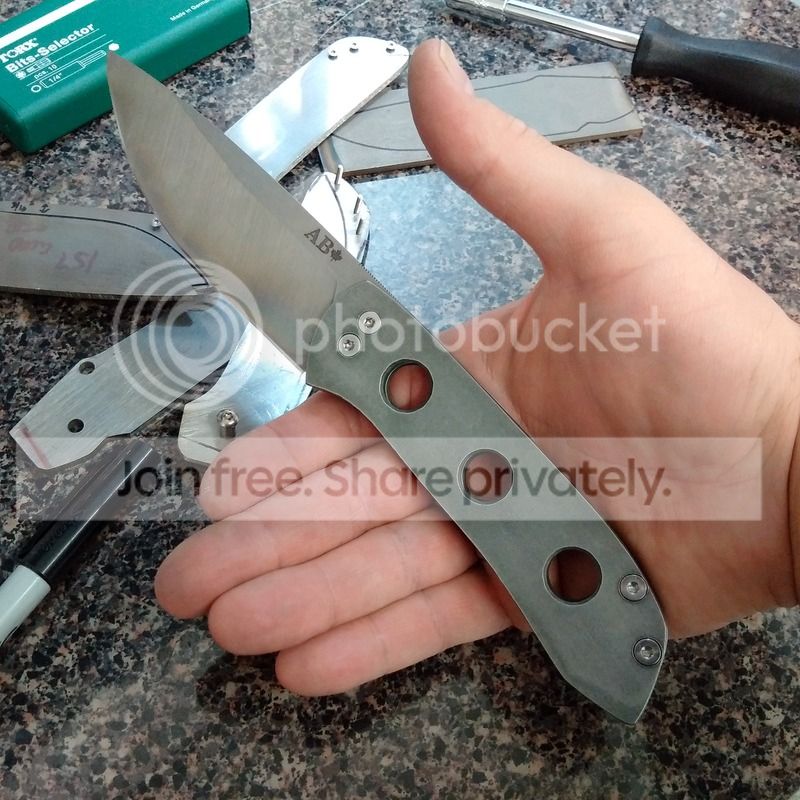

I finished this friction folder today. I'm kind of happy with it but, it's probably my crappiest grind to date. I ground the AEB-L in the annealed state and will not be doing that again. It's got some flex to it and my grind did not stay consistent. A good learning experience. I used all stainless hardware and phosphor bronze bushings. It's dishwasher safe.

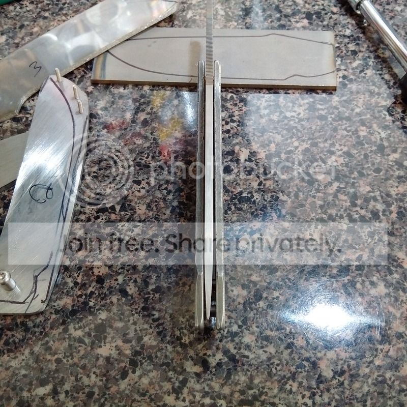

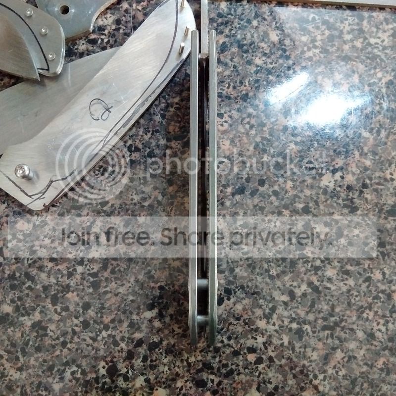

It's a little off center. I think if I mess around with the screws I might be able to bring it over.
I like gimping.
It's pretty comfortable.
edit to add....I wasn't going for a show piece when I made this one. I wanted a rough sort of industrial look to it.
I like it.

a reasonable outcome especially for your first. going to a liner lock would not take a lot more.
I do have to add that all those outside scale edges make this one only good for casual use in my opinion.

Please take the knife apart and put it between two flat pieces of whatever. I bet the blade has a slight warp in it and no matter what you do to the screws it won't get centered. Probably a five second fix.
