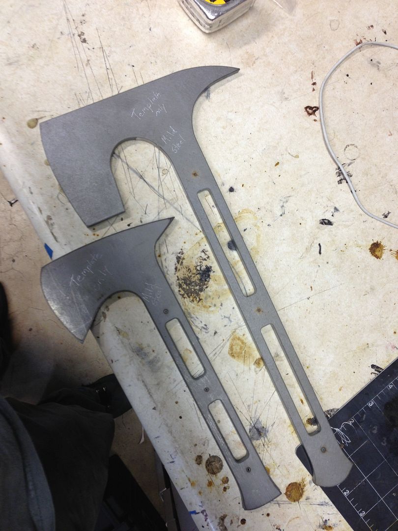

Ever since I started making knives, I have always wanted to make a full tang "tactical" tomahawk or axe. I am finally at a point where I can do so, and I thought I would share my progress so far.
Because of the size and complexity of the design, I will be having the blanks laser cut. The steel will be 3/8" 4140, a great choice for a tough use tool like an axe.
I am focusing on 2 designs to start. A large bearded axe that I am naming the "Skeg axe" and the small one I dubbed the "Peregrine".
Here are the drawings I made up.
The big ones are 16 x 8" , and the little guy is 11 x 5.25" .

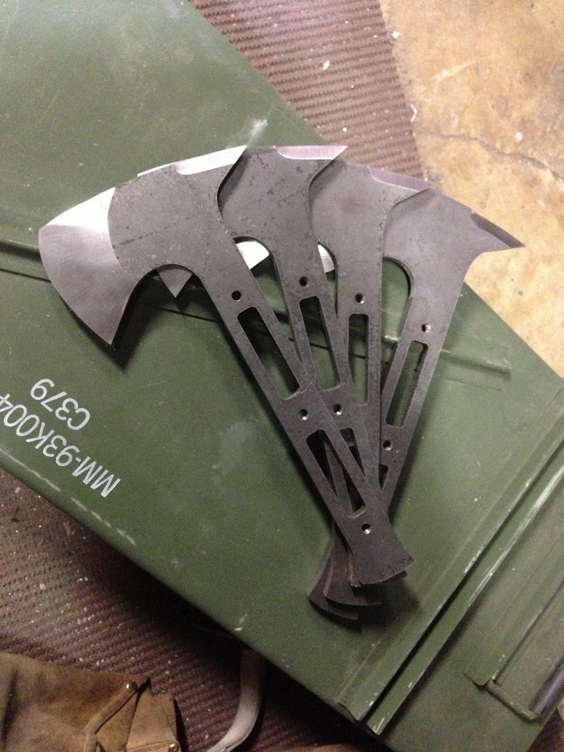

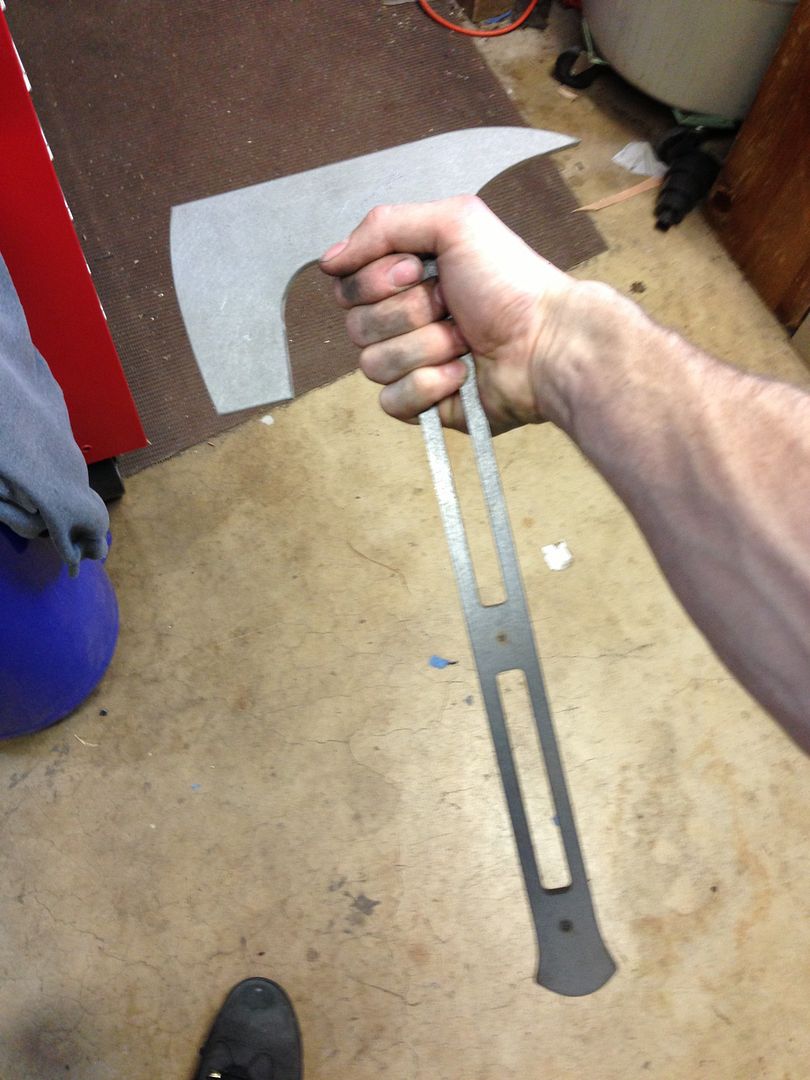

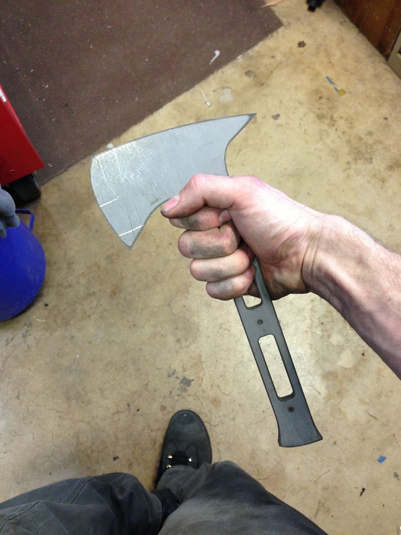

Here are the prototypes I cut out of mild steel, I wanted to check the feel and balance before cutting the real thing.

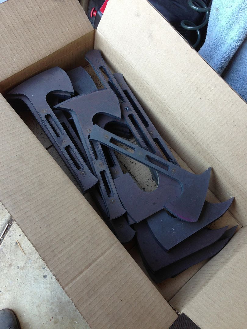

I picked up the blanks from being laser cut today. Now I just need my huge box of belts for my grinder to get here, and then sparks will be flying! :D

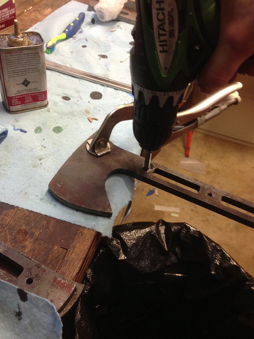

Here I am tapping the holes in the handles for the handle screws.

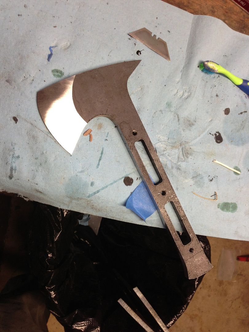

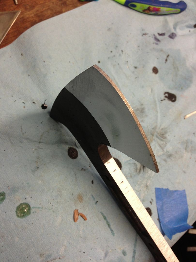

Cleaning up the profile on a Perigrine. Laser scale is a bear to grind off!

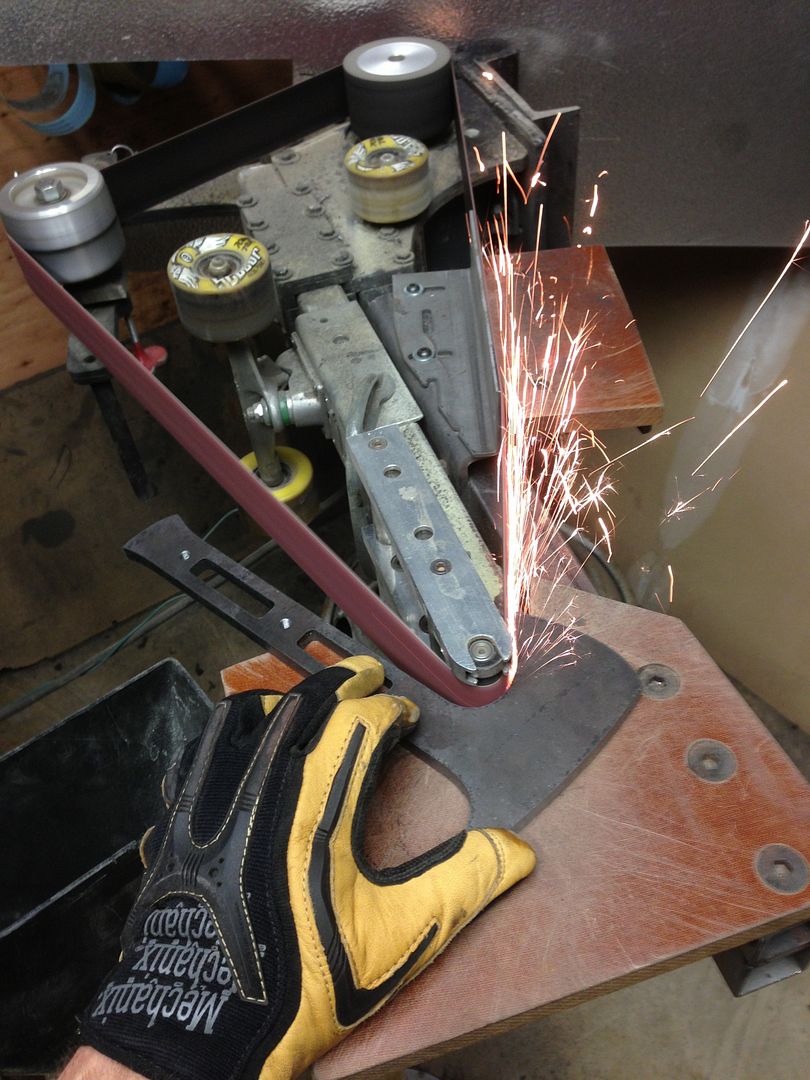

I was able to get a couple of them rough ground this evening. They will be getting a bevel on the top of the spike as well.
I was able to get some of the spikes ground in today.

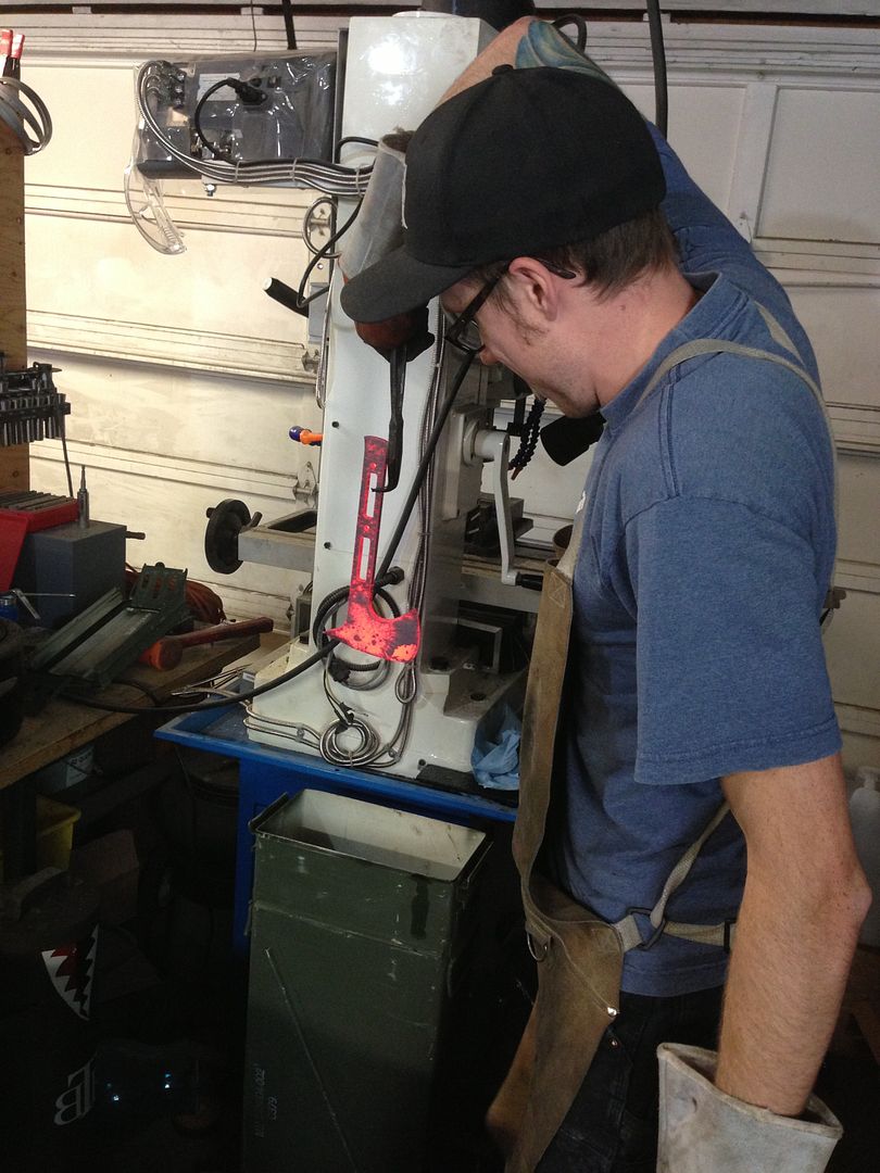

I have the week off from my day job, so I was able to squeeze in some heat treating this morning!
Hot steel!!
