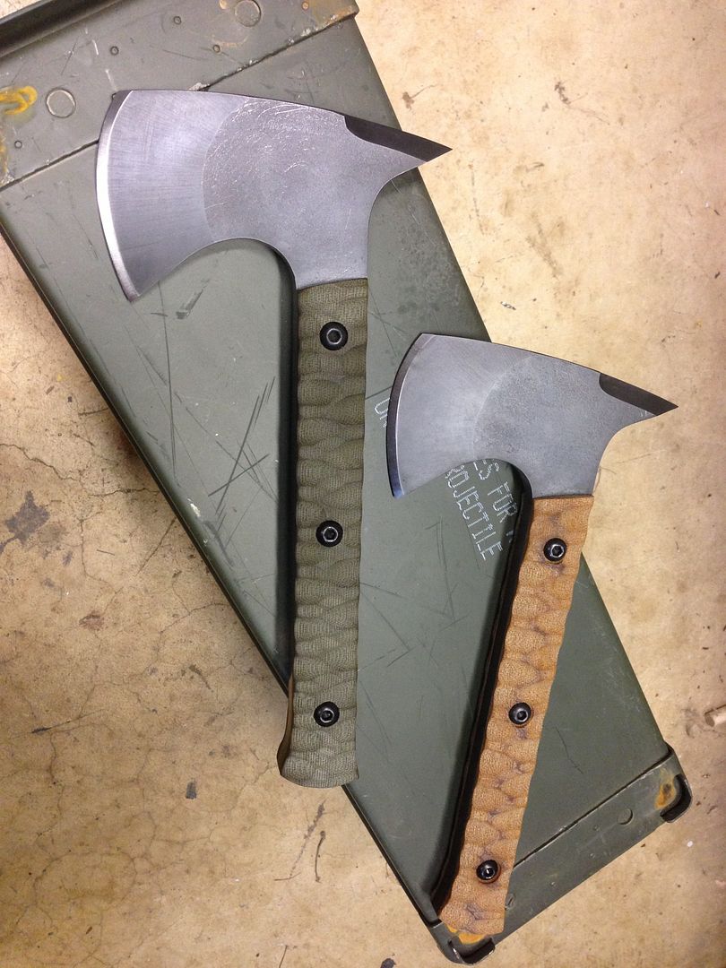

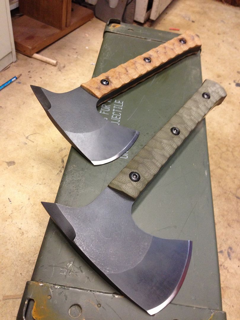

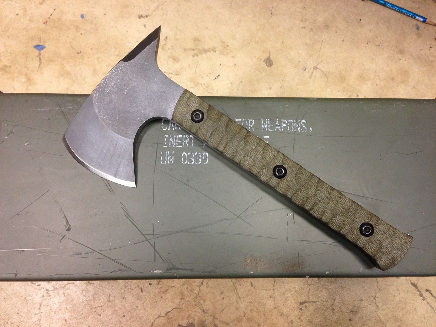

I just finished the Prototype up tonight. The green one is totally done, the Nat canvas one still needs the scales epoxied on.

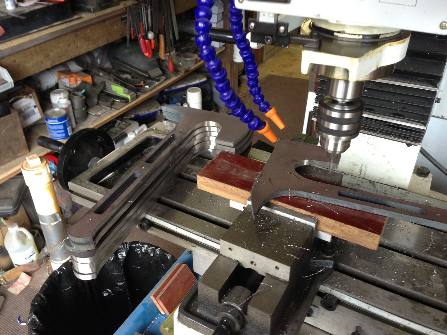

I finally got a chance to get started on the bearded axes.

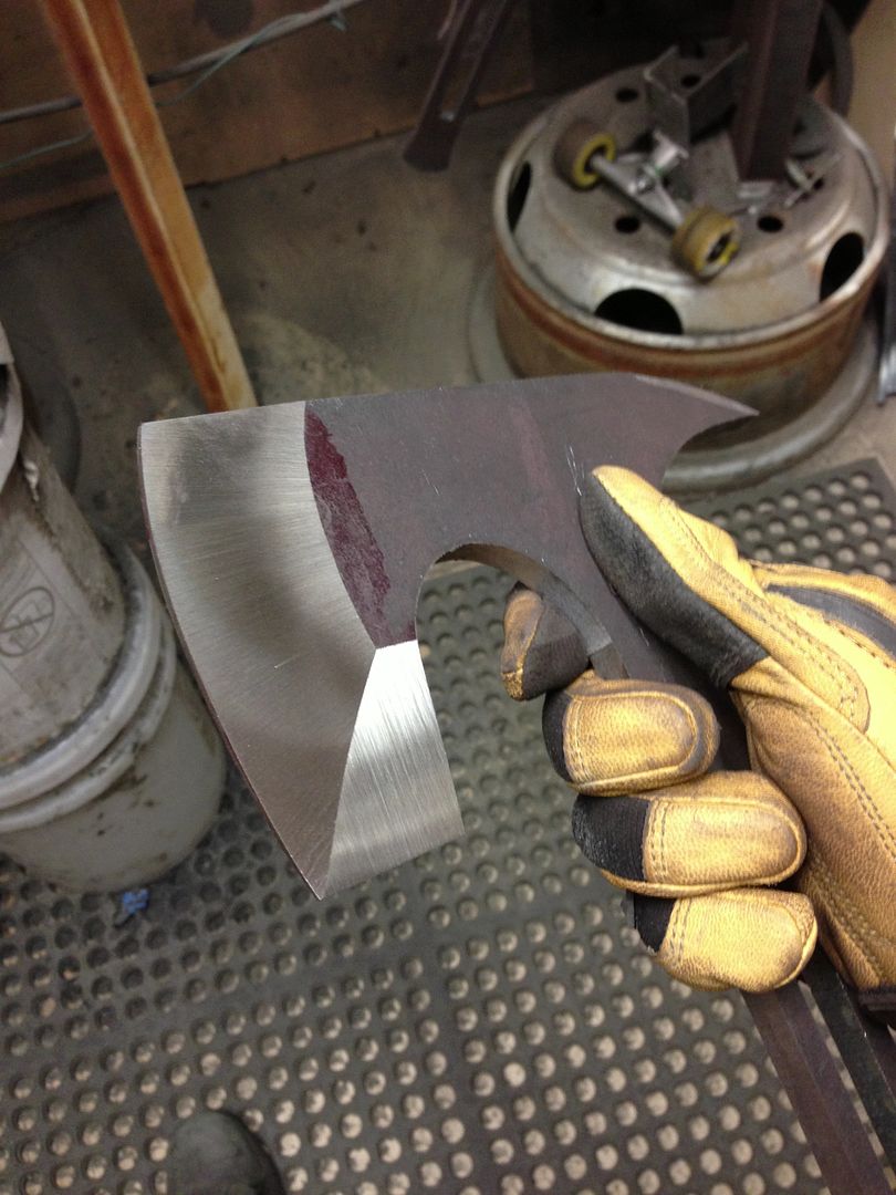

Drilling 3/8" thick laser hardened carbon steel, fun stuff!! : )

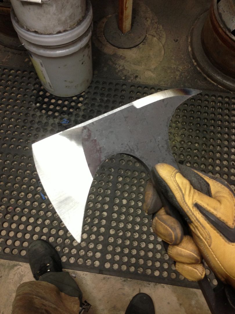

Grind like CRAZY! :D
Bevels roughen in. The beard will be sharp on these as well.
