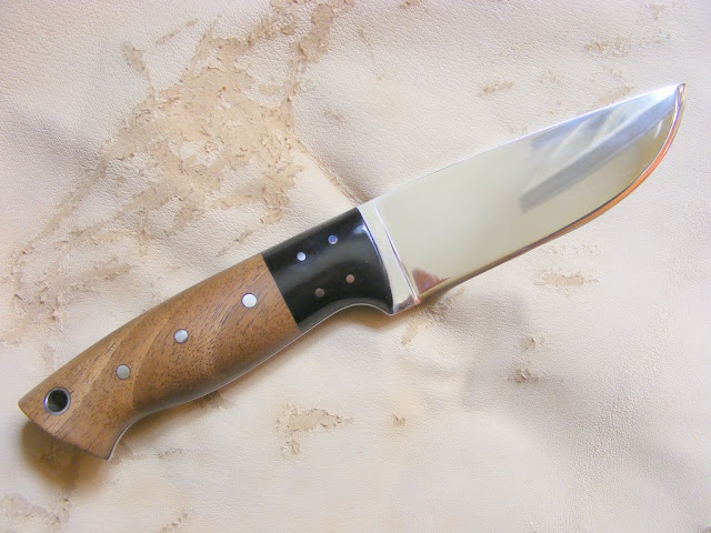

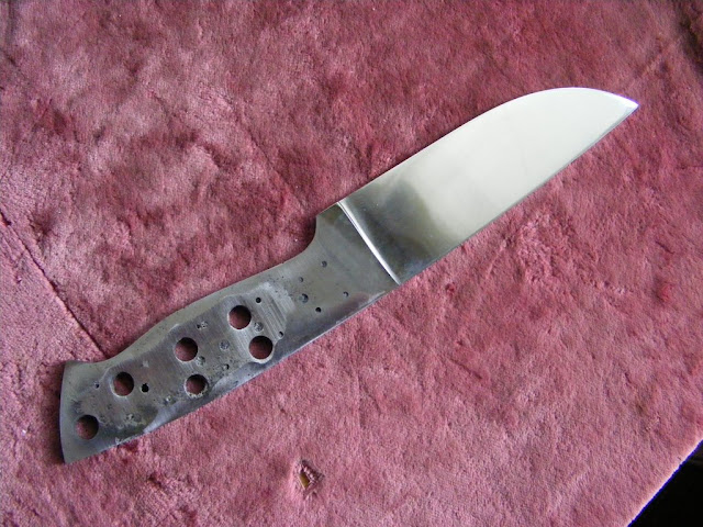

It is how I made a handle on full tang blade. RWL34 - arround 59HRC. I will use horn and wood.

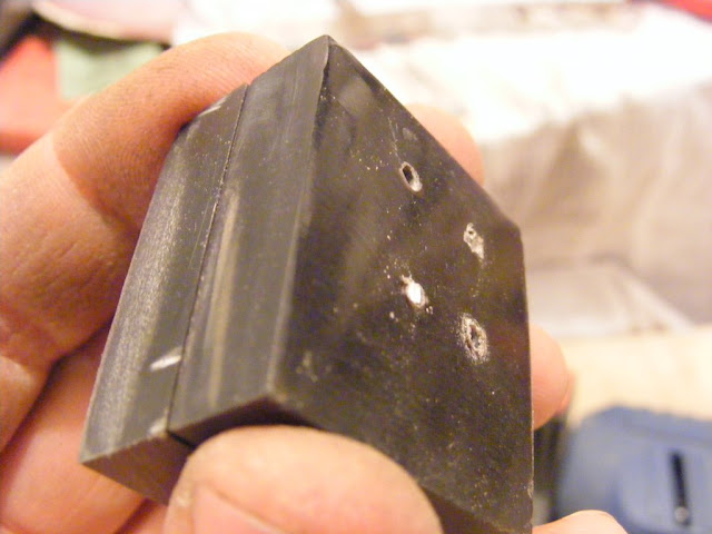

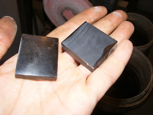

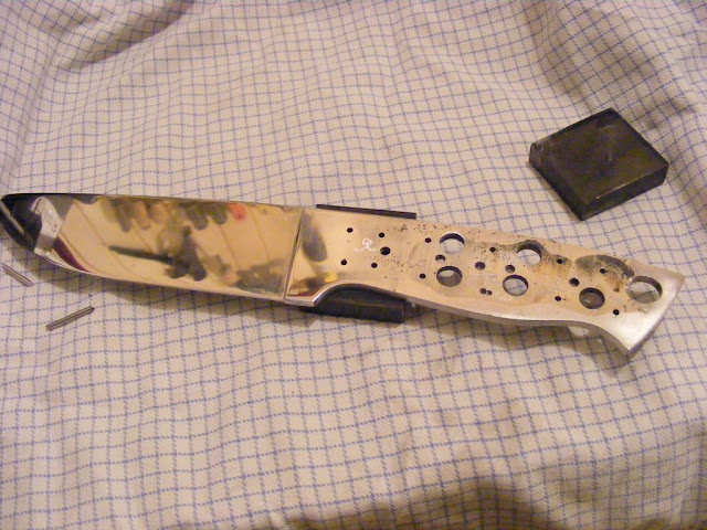

I start with bolster material - India water buffalo horn. They will be monted with 4 pins.

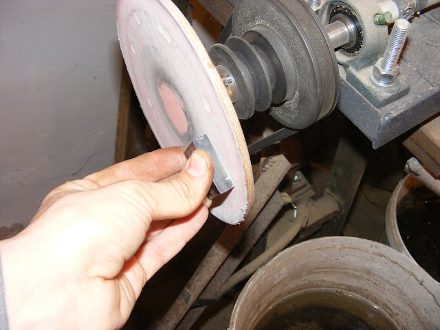

I flaten the sides that will match the tang on a 220grit on a disc grinder.

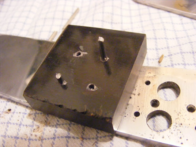

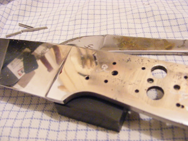

I lay the blade on and drill a pin hole.
I enter the pin and I drill second hole.
I put second pin and drill other two holes.

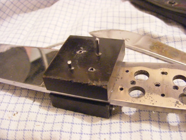

I lay the second piece of horn and I drill trough it in the same manner with pin fixation trough both pieces.

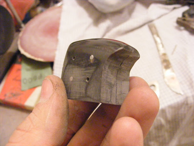

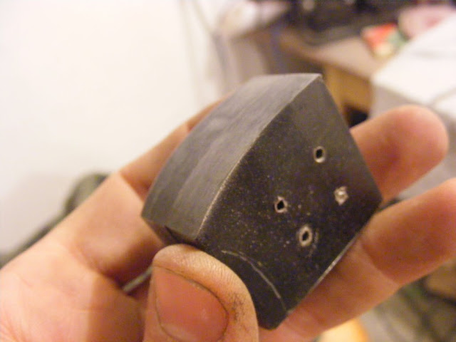

I take the bolsters and i put two pins to keep the holes match.

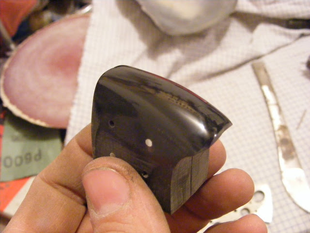

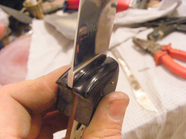

I start to form bolsters front side.
I round and polish. If you dont do that now it will be a pain after gluing and riveting. Back end of bolsters is flaten too to be even.
Check holes before the mount.

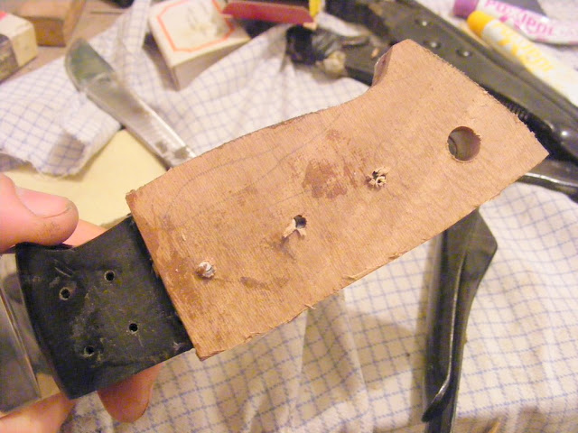

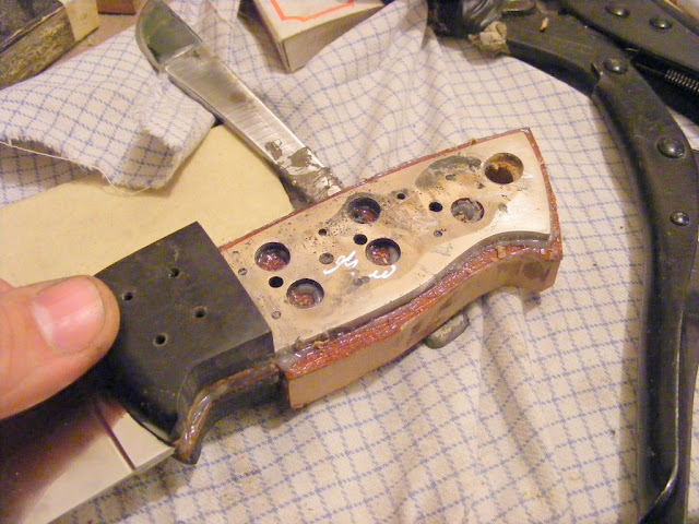

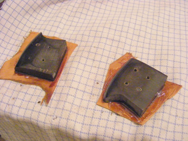

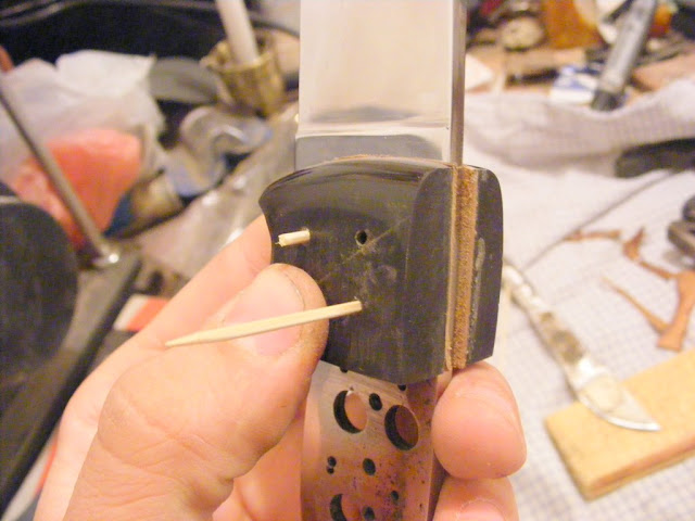

I glue thin layer of leather to the bolsters to fulfill inaccuracy and movement of a natural material.
I trim the leather arround the bolsters. I glue them with epoxy and I set tooth picks in the pin holes. After the glue is dry I drill the holes again trough the picks. I am lucky that pin material is the same size with the toothpicks.

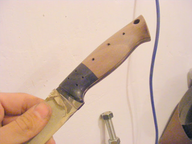

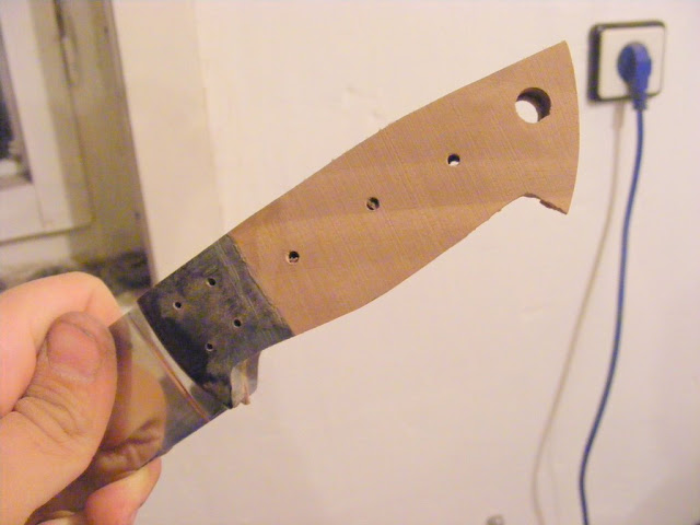

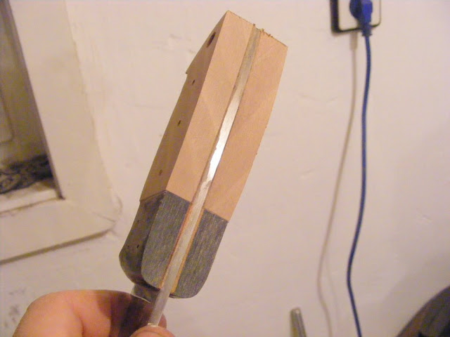

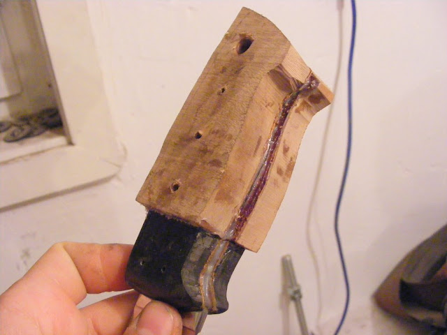

I miss a few shots here (sorry) I flaten the wallnut tree slabs and prepare them for mounting. I glued leather on them too. It is very importatn here to make a flat joint between two materials - horn and wood in that case. I use my disc sander. Nice flat file or sandpaper on a flat surface works well too.
I drill the holes for the pins and lanyard tube.
I glue the second scale and drill trough the holes from the other side.

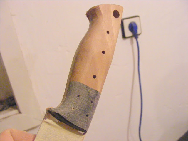

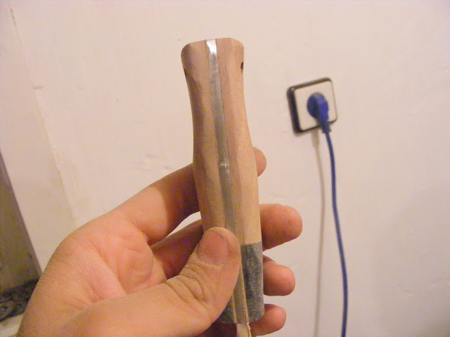

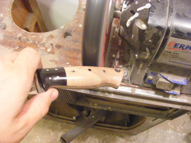

After that I start working on a belt grinder with AO 40 and AO 80 J-flex

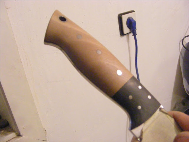

After that I work with 240 J-flex. It is fine belt for polishing wood. Of course nothing can't replace hands. I also work with a lot of sanding blocks and paper. Only hand can give a good finish on wooden handle. The idea is to form about 99% of the handle shape.
Eyeballing....

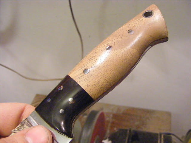

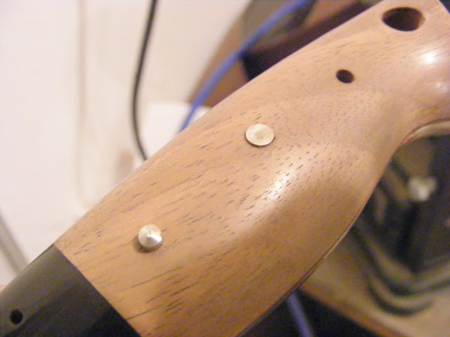

Glue the pins. They are just about a milimeter above the handle surface. I make a conic end, so the "mushroom" apears easily after first few strokes with the hummer.
Before and after.

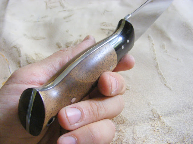

I ground off the rest of the pins and the tube and continue the finish.
I buff lightly with white rough so the fine scratches fill with wax and can be seen and removed. I finish with 500, 800, 1500 grid sandpaper and I buff before changing the grit. Before 500 I wet the wood so more higroscopic fibers can inflate with water and be sanded out.
After last buff.
After that I boil the handle in linenseed oil and wax and final finish with carnauba wax.

Very cool idea about the toothpics. What size pin material did you use?

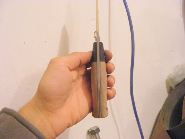

Great WIP - any chance of getting a spine shot? I was hoping to see how the leather looks on there...
Thanks!

Thanks for the tooth pick tip. I used a 1/8 wooden dowl and it worked great. This will make peening pins easier and they will be better than ever. Thanks again for the tip.
I have to register a patent number for the technology. :D It realy helps when you want to match materials during the gluing process. Before that I used to glue the pins themselfs, but after that I mess the bolsters on my previous knives, and the toothpick idea came up. I am glad that someone use it. :)
