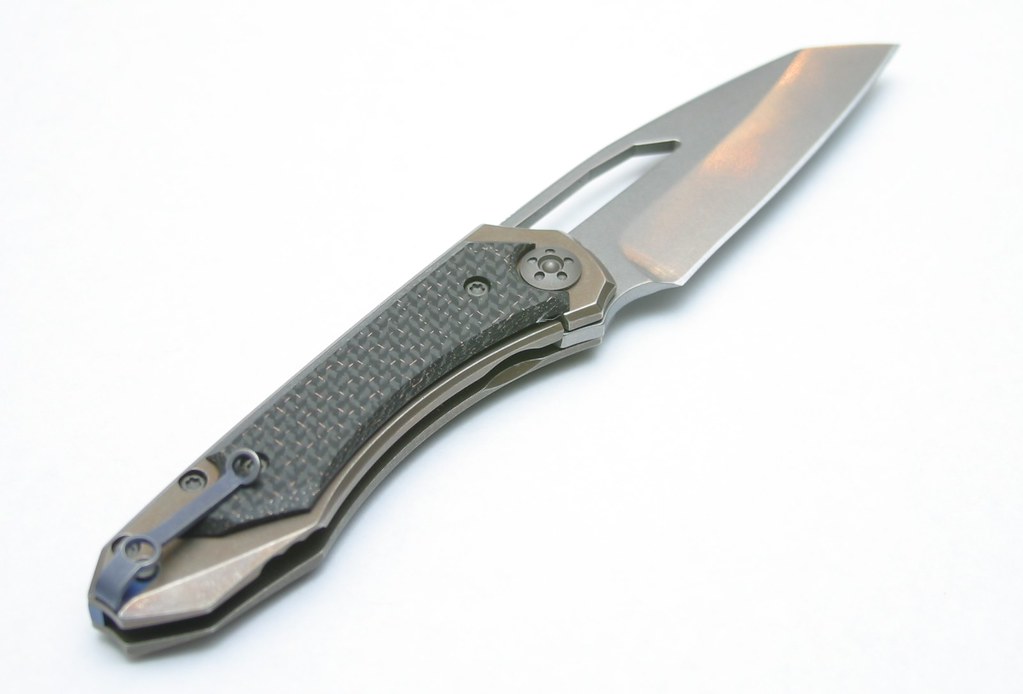

Full Titanium Framelocks - Post pics of yours
