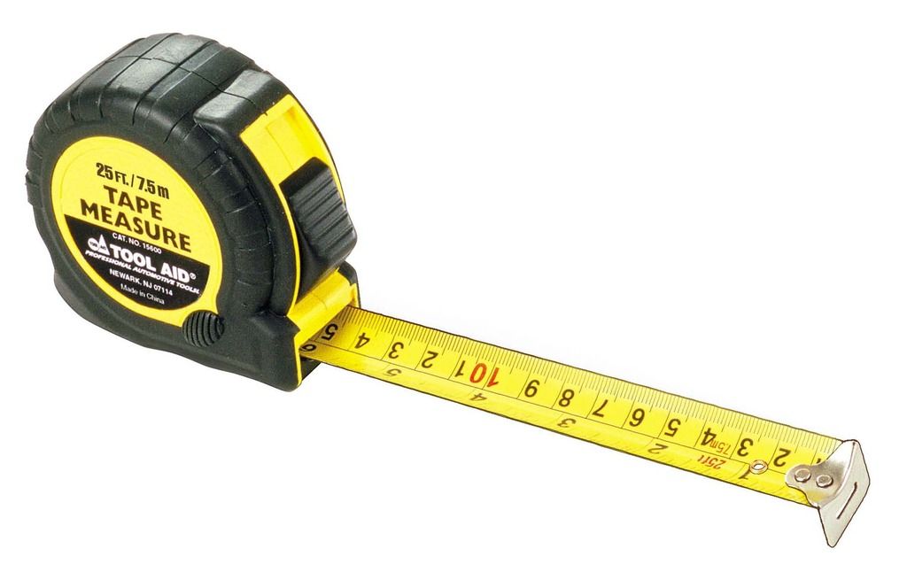

A steel tape measure like this wouldn't be as stiff and wouldn't hold it's own weight outstretched if not for the curve of the steel. This basically amounts to one really long thin blade where the whole blade essentially functions as a fuller does it not? This makes me think that a fuller must help in some way to stiffen a blade, but I don't know...
I think the whole idea behind a fuller is to provide maximum rigidity and strength with minimal weight. I think a tape measure and an I-beam are good examples of that...but that's just my opinion. :D
The tape is shaped that way to add stiffness, but that's not a fuller. It's making a curved surface out of a flat piece of steel.
The curved surface makes it so the bottom side of the curve concentrates the forces trying to bend it (gravity) on to a single "axis" (for lack of a better word) making it more ridged on that axis. It resists bending downward towards the bottom of the curve. Turn a tape over and it easily bends.
A fuller is a completely different animal.

You are probably correct, but to me a fuller down the length of a sword would be kinda like having that curved steel of the tape on both sides. Put two curved steel tapes like that back to back they'd be even more stiff and it wouldn't just flop when you turned it over. I don't see how it is so different.
The difference is that in the tape you get a cross section as thick as the depth of the "u" in change of the flat cross section thickness... increasing stiffness.
In a fullered sword the cross section remains the thickness of the blade, regardless you digging a fuller into it. The stiffness remains the same, just a bit less since you removed some material from the cross section.
But this is less noticeable, infact if you double the width of a stock you are not doubling its stiffness, but as Nathan explained, any adding to the cross section in the direction of the force applied, you increase stiffness by ^3.
This trade off makes for saving weight easily without sacrifying stiffness. And if you forge in the fuller and the displaced material is used to let the spine thichness GROW, then you have a stiffer blade, but you don't save weight.
