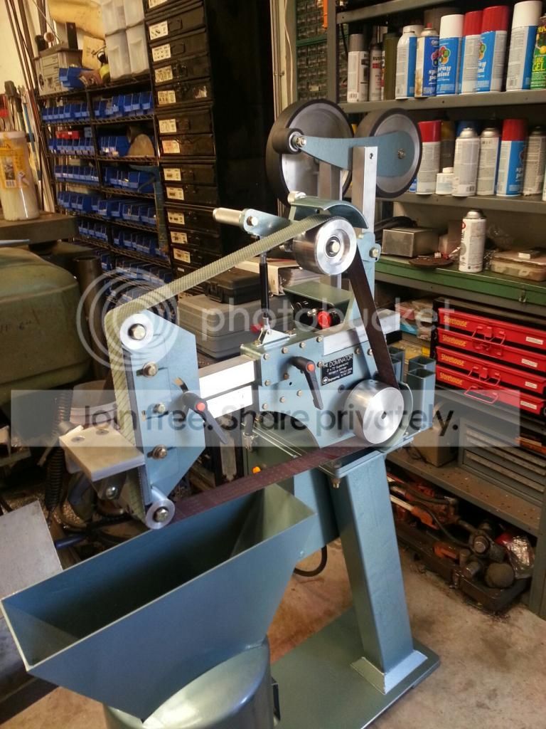

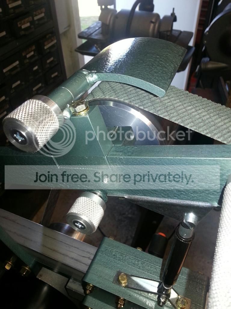

Fully adjustable bolt on spark shields/diverters on my GIB grinder build
Apr 17, 2014
17

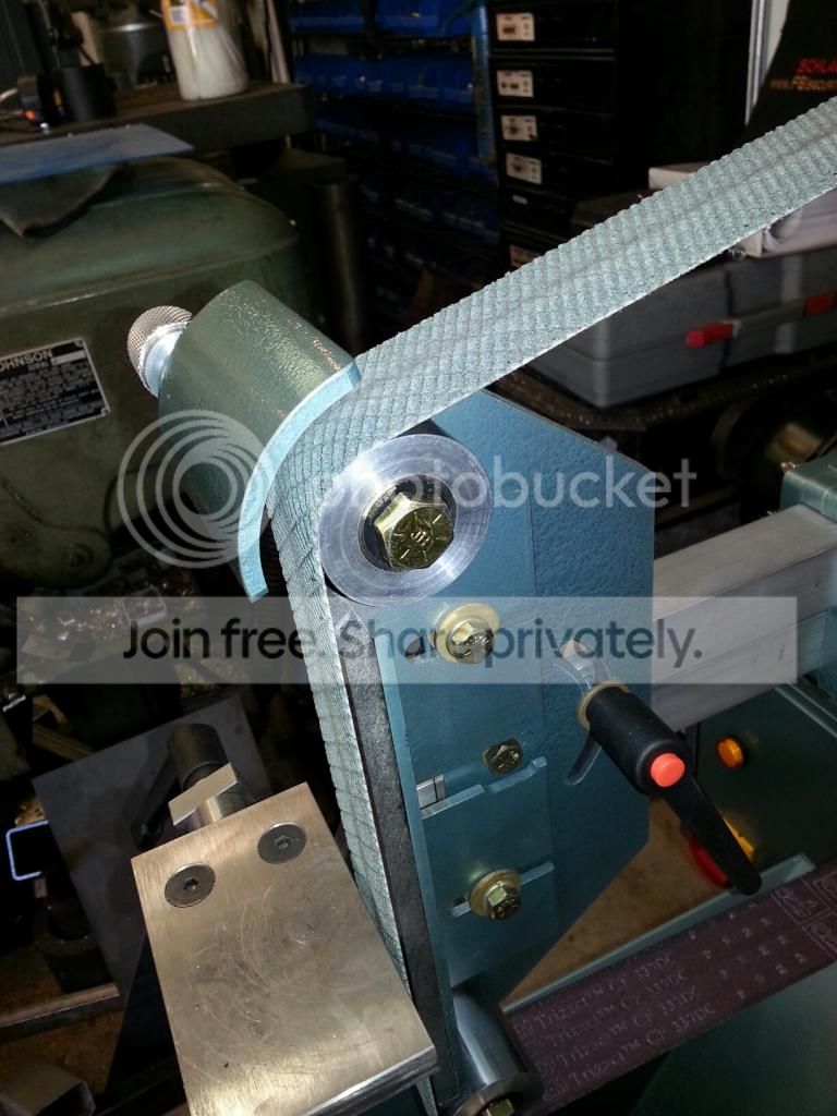

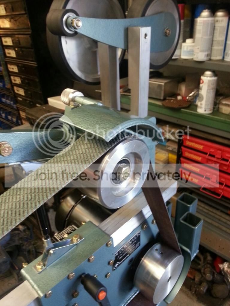

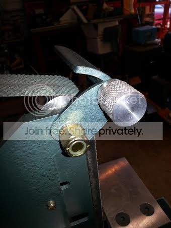

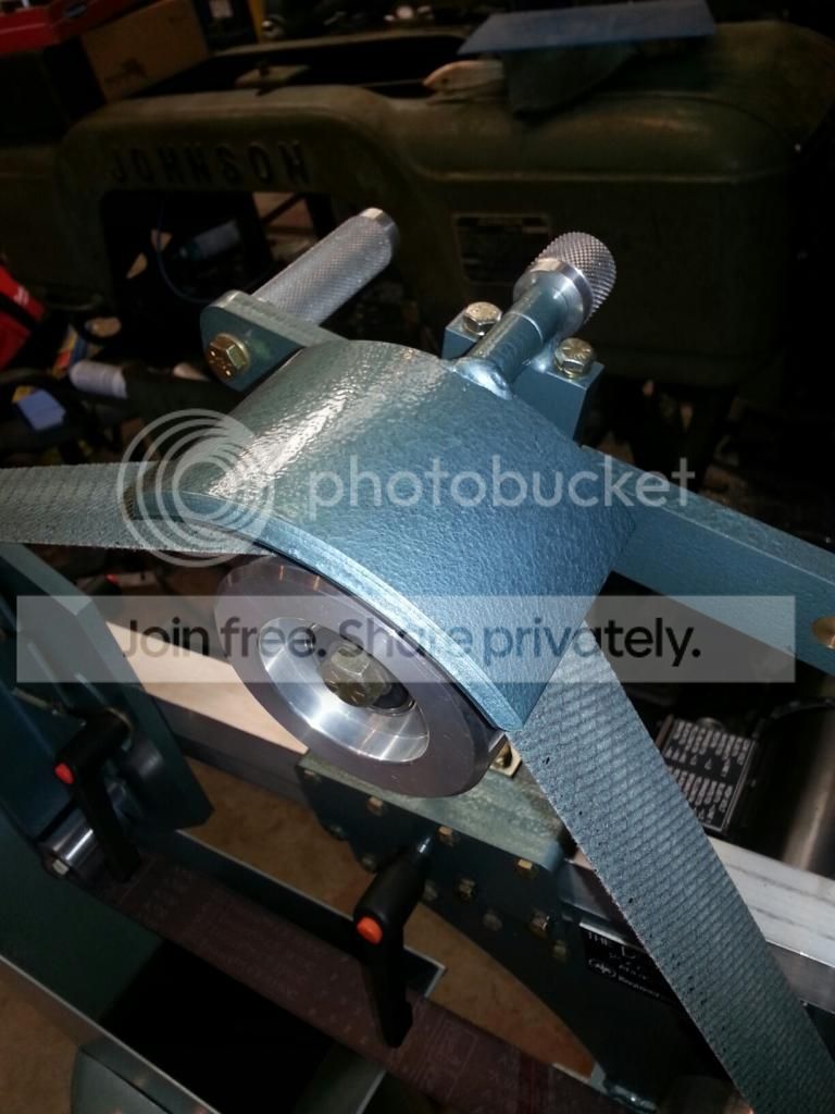

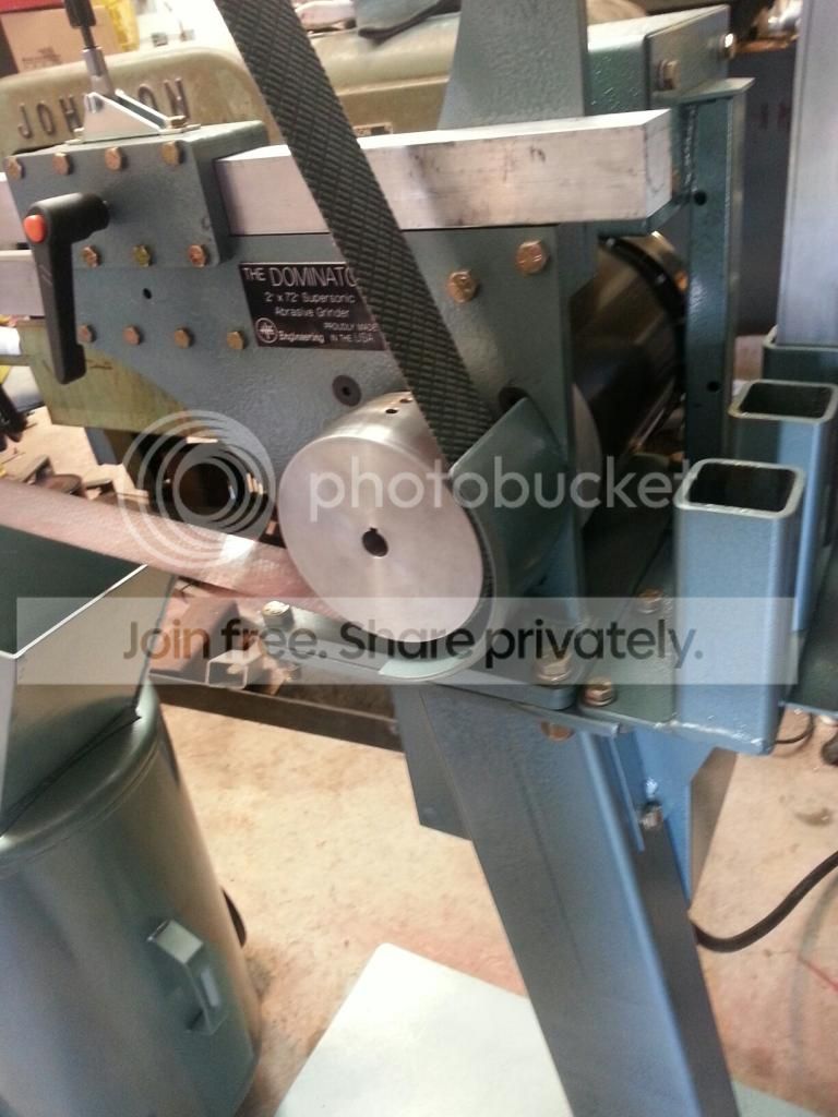

I finally fired this thing up , the tracking is rock solid, it is unbelievable how fast it removes material but it’s also a fire breathing beast, sparks shooting up twelve feet in the air and following the belt around and flying off around the turns so I decided to make a few fully adjustable bolt on spark shields/diverters, they work great along with my spark catcher tank. I figured I would post this just incase all of you have the same problem. I could not be happier with this build, rock steady power and performance.
Very pretty. Those guards don't fling sparks back at you?
The rear guard keeps them from going straight up. The top guard you can adjust the angle so you don't get them in your face check out this video this machine has a similar guard ,the front guard puts em in the hopper, check out this video that's where I got the idea http://m.youtube.com/watch?v=AmoQdIA65DM
